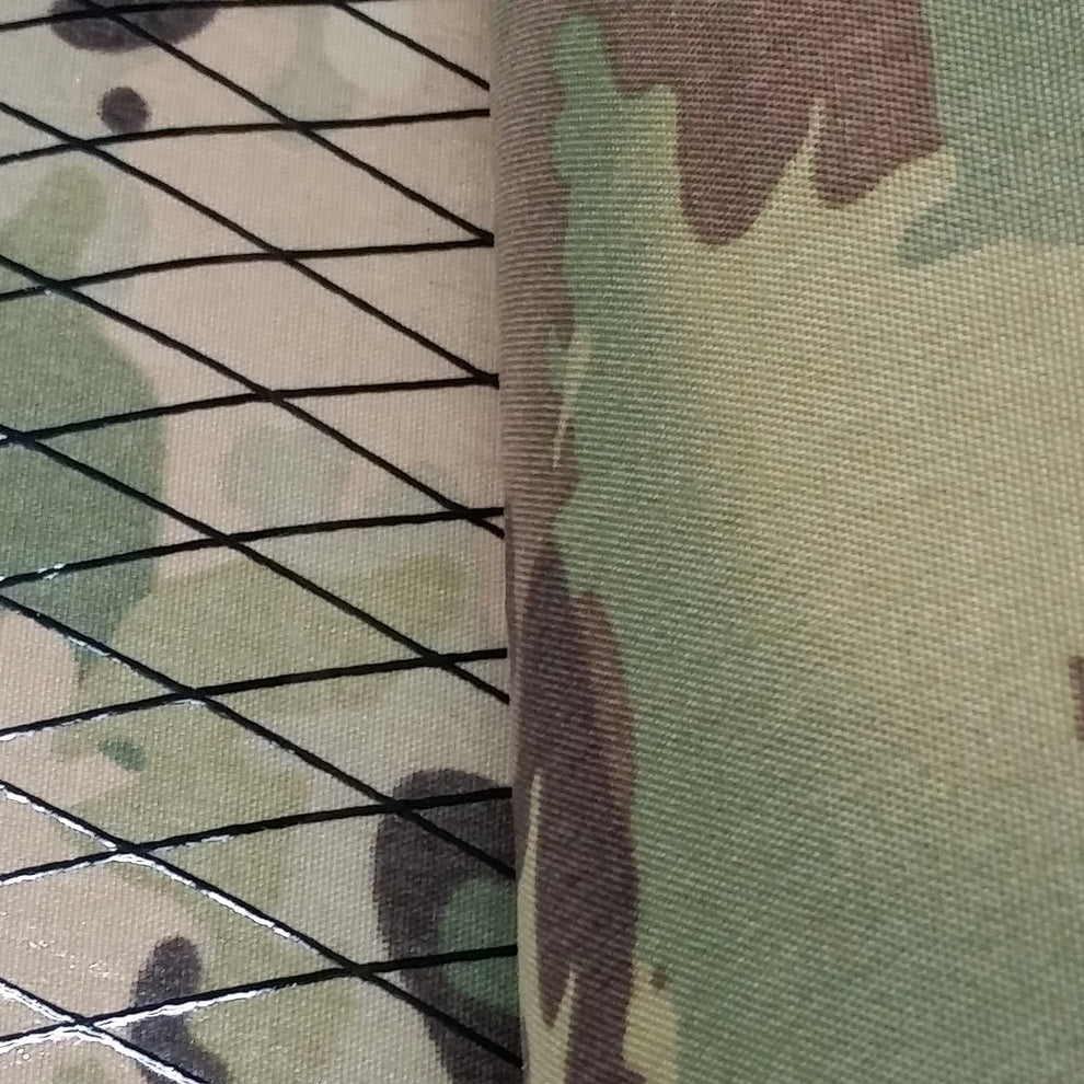

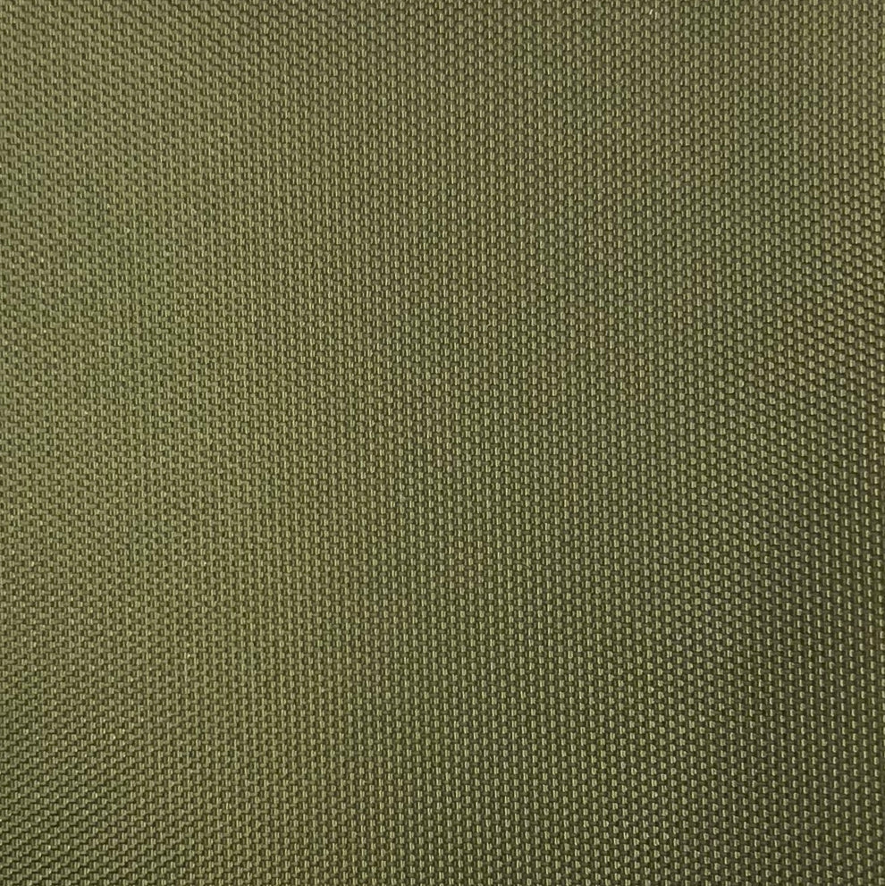

Originally Posted By Sinister: Rockywoods in Colorado carries an Olive Green 400 Denier nylon pack cloth that may meet what you're thinking about and is lighter than 1000D or 500D. They also carry a laminated X-Pac 330 that is hell-for-strong but really expensive. https://rockywoods.com/cdn/shop/files/249768.jpg?v=1692828014&width=990 https://rockywoods.com/cdn/shop/products/252845.jpg?v=1689668848&width=990 View Quote I've got some of the 400D packcloth. It's....ok. It's not as nice as the oldschool ALICE pack cloth. They DO have the nice 420D packcloth like on the ALICE, but it's only in black on there. Again - I'm willing to make a pack in any of these materials for someone. I'll warranty the regular materials, but not something like the 400d. I just don't think it's strong enough. There is a 400d Cordura fabric that is out there I've played with a little bit. It's better than the packcloth. It's literally a slightly thinner 500d Cordura. Availability is iffy. But if someone wanted to go lighter than 500d, that's a possibility. And yea, I'll do one in the XPAC fabric if someone wanted. Which is legit nice. But like you said, expensive. It's a possibility to use this to reinforce certain areas too. Things like the bottom side of the lid - or the whole lid itself - wouldn't be bad to do in this, it's way more waterproof than cordura. The side of the pack that rides up against the frame would be a good place to use this too. Again - balance cost vs. features. |
