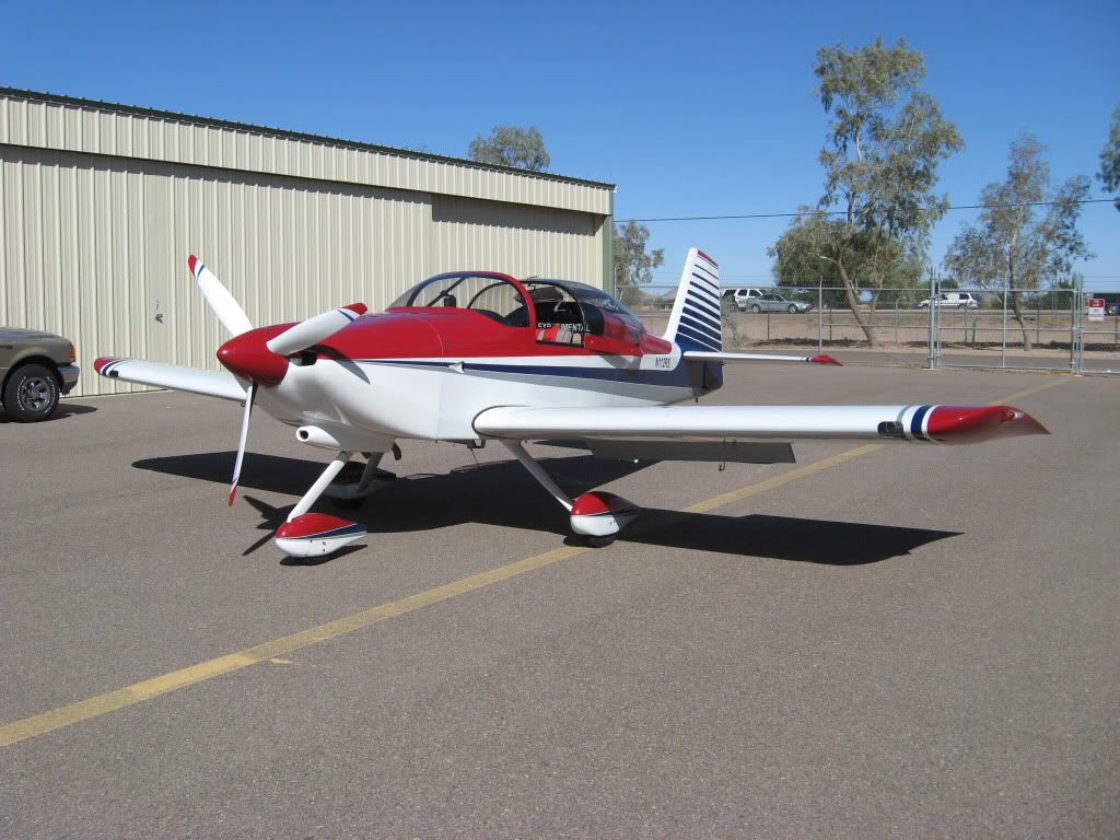

http://img.photobucket.com/albums/v319/chessiepup/N258RE/DSCN2594.jpg
Looking very good!
I hope you have better luck with your canopy skirt than I did......
Chessies4me  [Team Member]
3/17/2012 11:10:28 PM
Looking very good!
thank you, and no it's ugly so far, and pink to boot, I used SikaFlex on the canopy and one of "Todd's canopies" just to make it more difficult to fit the skirt
