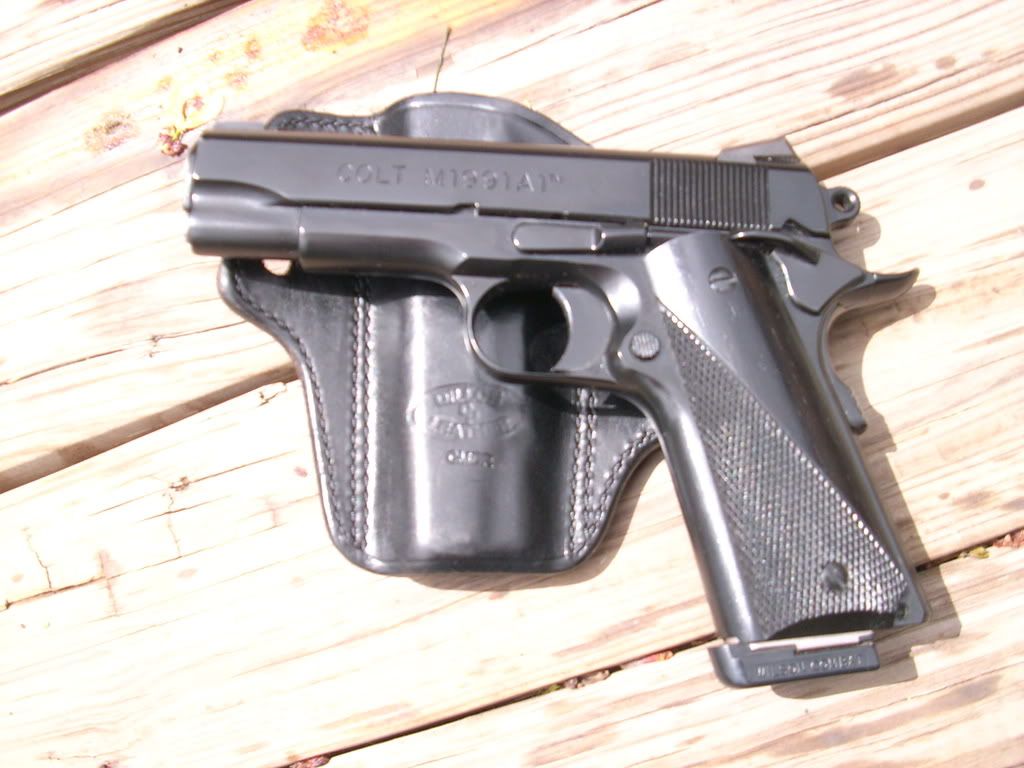

Wrong. I bought a 1991A1 in 1998, and it was indeed parkerized.
However, I later got it blued, and regret it. Yes, it was pretty, but the bluing didn't hold up much better than the parkerization. I, too, am currently seeking a refinish for this gun. I don't want to spend a ton on this gun, and am seriously considering blasting it and applying some Norrell's molyresin that I already have on hand. Man, OP, if mine wasn't so modded out, I would offer to trade ya!
OP, here a pic, if you are curious as to how your gun would look blued:
