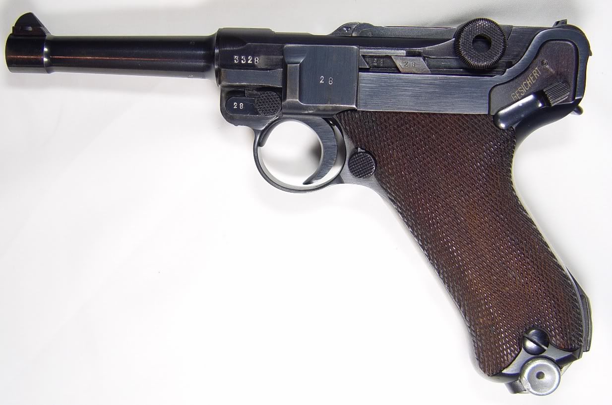

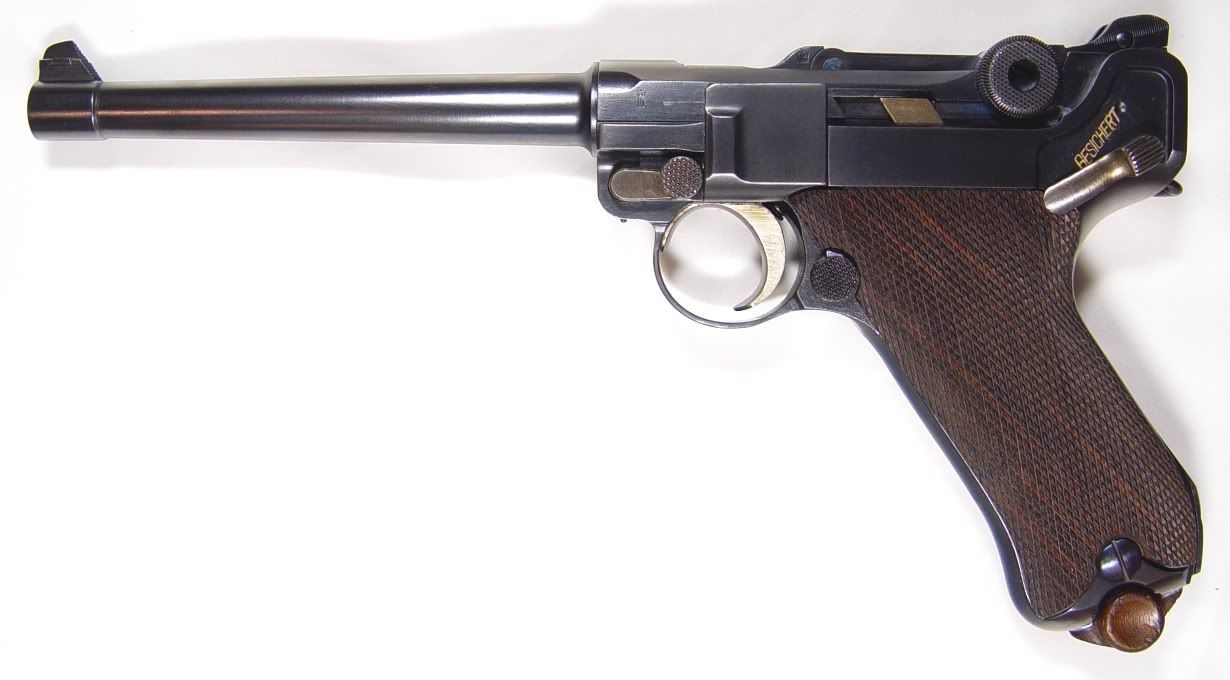

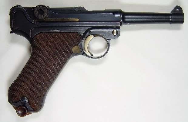

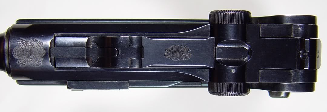

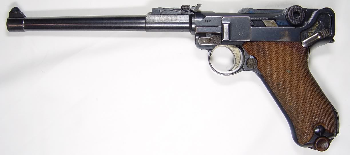

Some pics of where your parts came from. These are from my personal collection.
1906 AE
1923 Commercial showing import mark
1917 DWM Artillery
1920 Commercial Navy
1940 42 code Mauser
