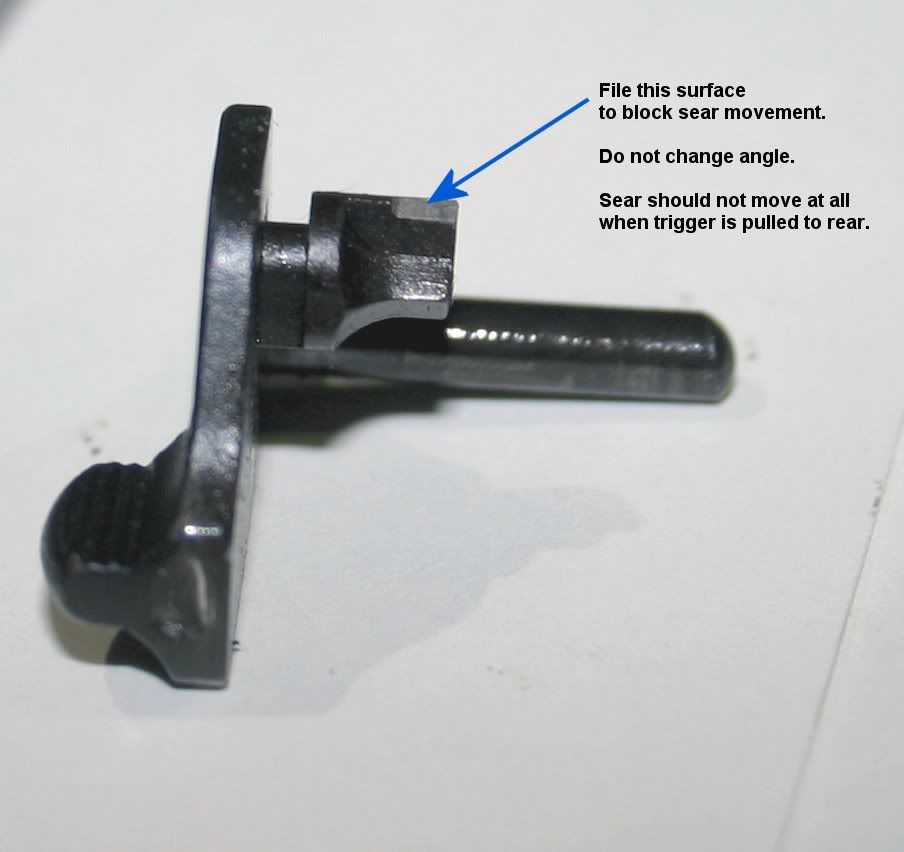

However, I ran into an issue trying to install 2 parts to the frame: the magazine catch and the ambi safety.
1- the magazine catch will not fit into the hole... the inner cam pin even when turned into the full lock position won't clear the hole in the frame. As far as I can tell, the cam pin/spring should be installed in the magazine catch assembly before inserting it into the frame. Before I break out the file tho, I thought I'd best check to make sure I'm not doing anything stupid....
2- The ambi safety will not fit all the way down when the firing control group and beavertail is installed. It locks up about 1/4" from the surface of the frame. I can only assume the safety block is making contact with the sear and that's what's preventing it from seating in fully. Can you guys point me to which parts of the ambi safety I need to file back in order to fit it in?
Thanks! (pictures to come later)
Sometimes you'll have to knock a corner off the mag release latch with a file to get the assembly to slide into the frame. It shouldn't take much.
First, determine whether the safety has a full range of movement within the frame cutout when the fire control parts are not installed. Sometimes, the inner lug on the safety is tight and will drag on the frame. Next, leave out the beavertail and install everything. Get a flashlight and operate the safety until you can see what is interfering. If all else fails, mark up the inner safety lug with a Sharpie or candle soot, install and operate, and remove to see if you find contact marks.

The thumb safety rotates fine with the firing control group out.
However, it appears to be making contact with the sear at the lower bottom edge. I figure I'll need to file back on the surface of the grip safety that I currently have painted in blue- however, it's pretty hard for me to tell which surface is the culprit- suggestions?
NightHawkIX  [Team Member]
3/29/2012 8:04:16 PM
hmm... never mind. with only the sear and disco installed, the thumb safety moves just fine....
maybe i'm being an idiot and not cocking the hammer to the right angle or something...

You will need to install the hammer, sear spring, and MSH to get the sear into a position to be blocked by the safety. This is the surface of the safety that controls sear movement:
3/29/2012 10:19:23 PM
I'm almost too ashamed to admit it... but it was because the leaf spring was underneath the sear and propped it up rather than lying on top of it....
OK- I finished assembly- next post with pictures of finished gun.
