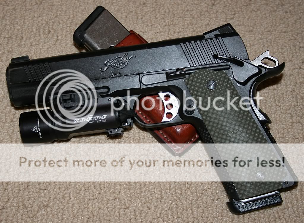

Bachelor_of_Science  [Member]
5/2/2012 7:41:07 PM
I've got this Wilson aftermarket piece on my SA Loaded Service Target now. It's a good, inexpensive alternative, but I'd like to get something more permanent, but nicely done. Example pics of the stippling process are hard to come by. I see lots of pics of pistols that wear this, but no information on who did the work. Guess I'll just save some money and have Wilson do some checkering for me. I think I prefer 30LPI, but 25LPI looks awesome as well.
