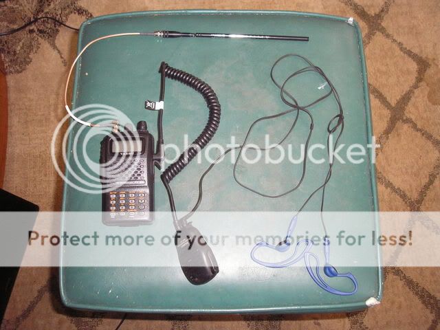

fo sho. I'm learning lots. Comms is probably my next logical purchase and I don't know where to start.

Some type of radios (two at least, four possibly) is what I'm looking into purchasing next just for the family for emergency communications. I'm looking to get handheld units or something halfway small that will be able to communicate for about a mile, but reliably through some wooded areas and residential areas. Is there anything that can do that well? The biggest issue here is that I really know nothing about radios, or how they work or what the many acronyms are. I would like to eventually have a headset(s) for the radios as well.
Are there any other concerns I should have for what I want to do?
All I really need is about 1 mile range through wooded/residential area, headset capable, two way communication. Seems pretty simple from what some of the specs I've been reading but the acronyms sort of overwhelm me at the moment.

GMRS or MURS will do this reliably. I get 1 mile crystal clear in the combination I am using. I am using a Motorola CP200 VHF. Just make sure the radios you get cover the frequency range of GMRS or MURS.

My own taccom set-up using yaesu FT60:
