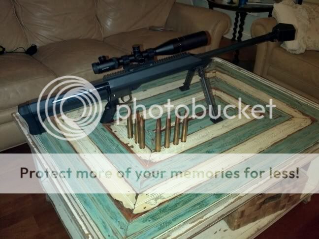

Here is my last run of Barrett fodder
L->R
M1 incendiary
M17 Tracer
M20 APIT
M8 API
M48-A1 Spotter Tracers
more M20s
