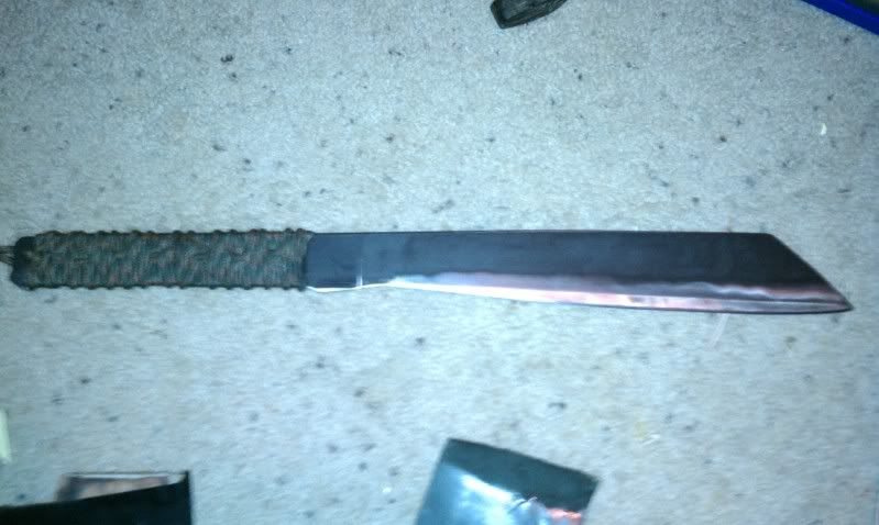

I agree with all the above but would like to add M4 steel as another option It is incredible. You said fighting knife not sure what style you want but as someone who likes messing around buying a Mil spec Ontario machete is a cheap practice blank.
Just make sure not to heat up the blade to much or you will have to re heat it but you can make several knives out of each machete.
Here is a Martindale style machete that I am working on It looks rough now but I just started it today. It started life as a Ontario that I paid $20 for

D-RAS03  [Team Member]
5/23/2012 9:40:53 AM
http://i107.photobucket.com/albums/m292/mc556/IMAG0440.jpg
I love that blade. You made it out of a cheap machete?
