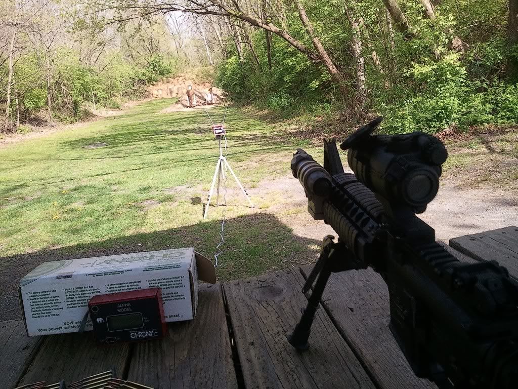

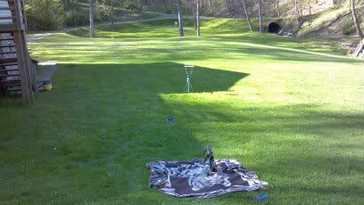

I've got a CED chrono. I was working up some ZMax in my AR today. Out of 30 rds fired, I got ONE reading.
I set it in the sun, I set it in the shade, I set it so the screens were in the sun and the sensors were in the shade.
Every shot but one, I get an E0 or E1 error. Which is either the shot missed the start sensor (E0) or missed the stop sensor (E1).
It's been quite a while since I've used this chrono, and I've missed shots before.... but missing 97% of them? Give me a break.
I had the screens about 25-30ft from the muzzle, so muzzle blast is a non-issue
Any ideas what I'm doing wrong?
See below for crappy cell pics of set-up:

I did make it a point to shoot keep the sensors level to the flight path. I tried to put the trajectory about 5-6" above the sensors.
Curious to why you guys are suggesting to move closer? A bullet is a bullet, whether coming out of the muzzle, or inches from impact. The chrono should accurately measure the velocity no matter where you place it, of course velocity will be highest at the muzzle.

I don't think the distance is a problem at all. If anything, it's probably a good thing (less muzzle blast).
I would guess your problem is the lighting. Just look at those shadows and how the shadow is on one sensor and not the other. Probably more important is the sun is shining down into the sensor head, as opposed to down onto the sunscreens (which obscure a direct view of the sun).
I also think the angle between the trajectory and the sensors might be a problem. It looks to be about 10 degrees from the photos. That seems like a lot. Lower the chrono or get the rifle up higher (or both).

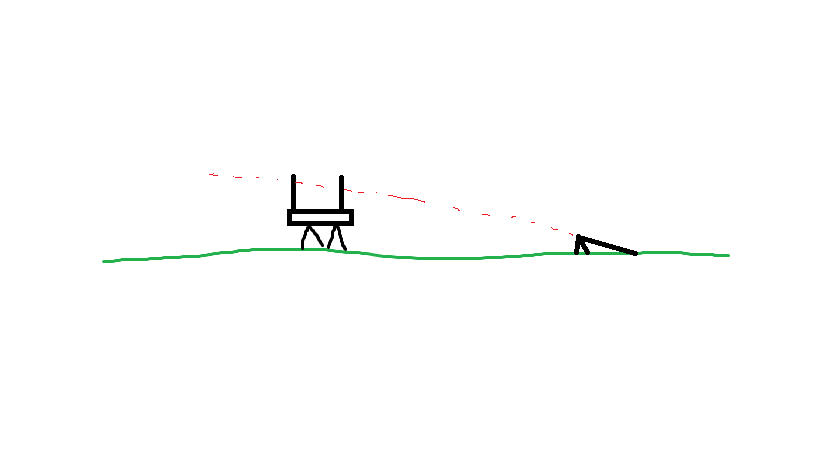

InfiniteGrim  [Team Member]
4/21/2012 12:52:25 AM
its the angle your shooting at.
The bullet needs to be parrallel with the sensors. Do you have a mountain stopping your bullets?
See... needs to be level with the chrono.
4/21/2012 1:01:48 AM
Bullet needs to be the same distance from each sensor, yet this is what your are doing....(shitty ms paint, im on a laptop)
CharlieHo  [Team Member]
4/21/2012 2:08:06 AM
http://i56.photobucket.com/albums/g165/InfiniteGrim/Untitled-23.png
Im certain I'm not doing that. I will try a new battery tomorrow.
Im screwed on orientation unless i change shooting locations cause I'm shooting in my front yard.
CCW  [Team Member]
4/21/2012 1:35:48 PM
Originally Posted By CharlieHo:
[quote]Originally Posted By InfiniteGrim:
Im screwed on orientation unless i change shooting locations cause I'm shooting in my front yard.[/quote]
Very nice yard, at that. It looks like the embankment swings around to the right of the photo and actually gets steeper. Steep is good to prevent ricochets. It would help with the sun / shadow problem, depicted in the photo, if you swing your chrony range around to the right. You only need 8 to 10 yds from muzzle to backstop.
4/21/2012 6:55:54 PM
Try tilting the front of the chrono downwards a little, unless the picture is screwing with me.
4/21/2012 8:55:52 PM
The chrome was dead nuts parallel with trajectory.
