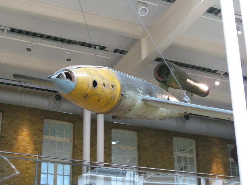

I came across a Chinese copy of an M1 a couple of years ago housed in the Imperial War Museum in London. I highly suggest stopping by if you're within 1000 miles.... I'm ashamed to admit that I've visited this museum twice as much as I've visited the Smithsonian......
here's another favorite of mine
