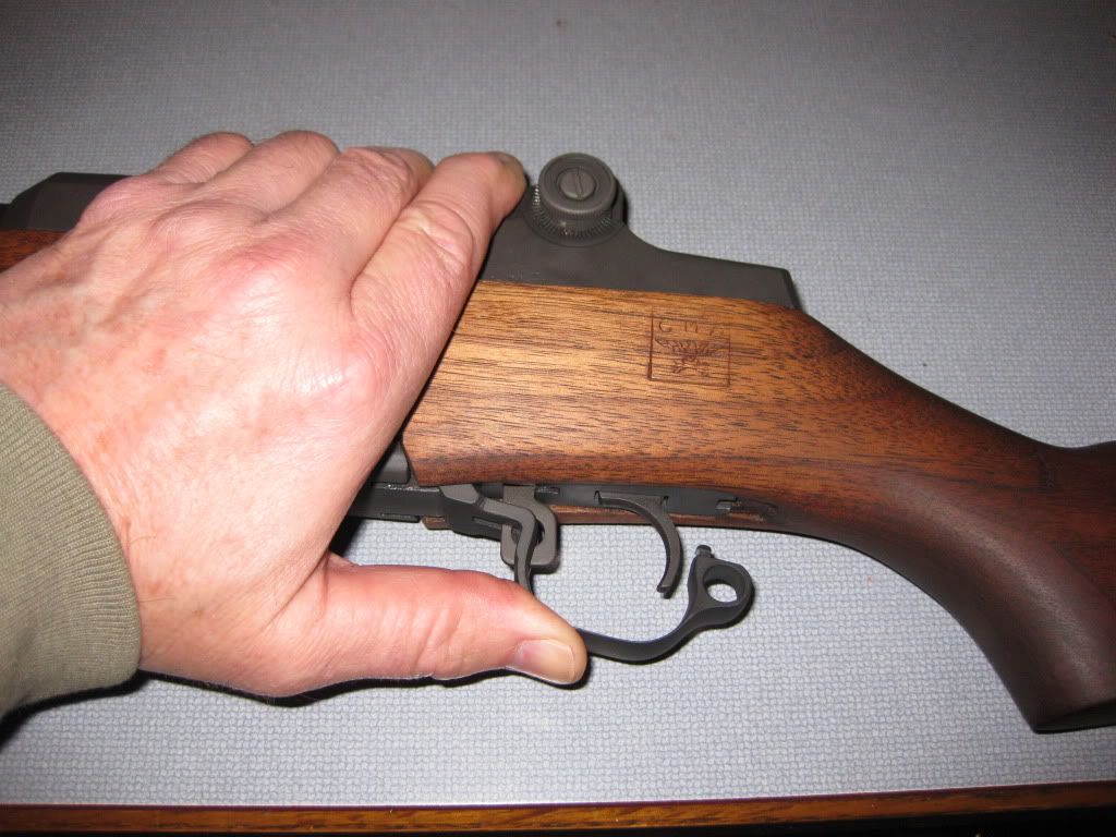

Hey guys, I got all my parts from Mr. mailman this morning and I have been working a couple of hours to try and make all the wood fit correctly.
The biggest headache right now is that the trigger guard will not go all the way up and lock, and I am afraid to force it any more. my old stock had more material out in that small area right behind the trigger, which allowed it to recess maybe another 1/8". I am wondering if I should remove a little at a time from that area until it locks up, or just send it to someone with a clue?
Any help is greatly appreciated. TIA

Hatrick  [Team Member]
4/21/2012 7:52:26 PM
Originally Posted By ziarifleman:
That's actually about how far you want the trigger guard to draw on the action.
In the picture I am applying a fair amount of force to get the guard as close as it is.
Angry-American  [Team Member]
4/22/2012 2:08:07 AM
That's where you want it, use a mallet to take it home. I have a picture somewhere of ordinance workers putting in trigger guards, they were using mallets to drive em home. The wood will compress and loosen up in time. BTW nice score on your early trigger guard.

Don't remove any wood - do like the poster above said and use a mallet to get it to lock up. You want as tight a lock-up as possible. If you're not going to shoot it frequently, it's better to leave it unlocked so the wood doesn't compress as much over time.
4/22/2012 9:00:48 AM
All right boys, I reefed on her with both hands and she snapped shut tighter than a bulls ass during fly time.
Working on removing wood where it contacts the barrel and the op rod inside the stock, and soon it will be GTG. Thanks for the help everyone.
