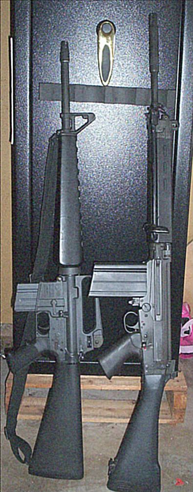

A nice feature on the folder is whenever you place it into the safe it's not crowding into the rifle next to it . The FAL's tuck up snug while the M1 and SKS tend to compete with the space next to them .
