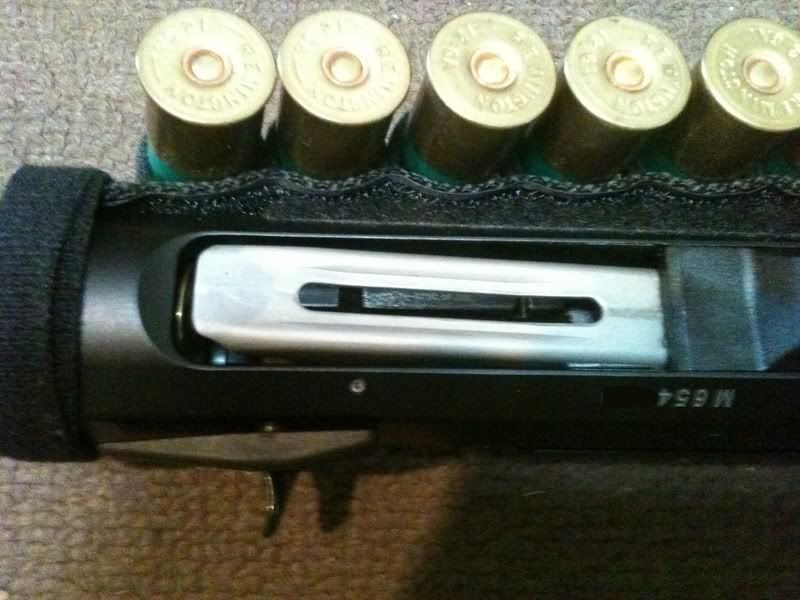

I also have a 3 Gun Gear 2 Pak on it, which I finally got to use. I really like it allot. I found myself tilting the shotgun to the left so the ejection port was more visible, reaching over with my weak hand, dropping the shell in, and hitting the bolt release. I was very smooth with this, and was pretty quick too, allot quickr then I thought. I also did not practice this at home, so this was a learning / partice thing. If I am doing it wrong, please let me know.
Here is also a pic of said shotgun
