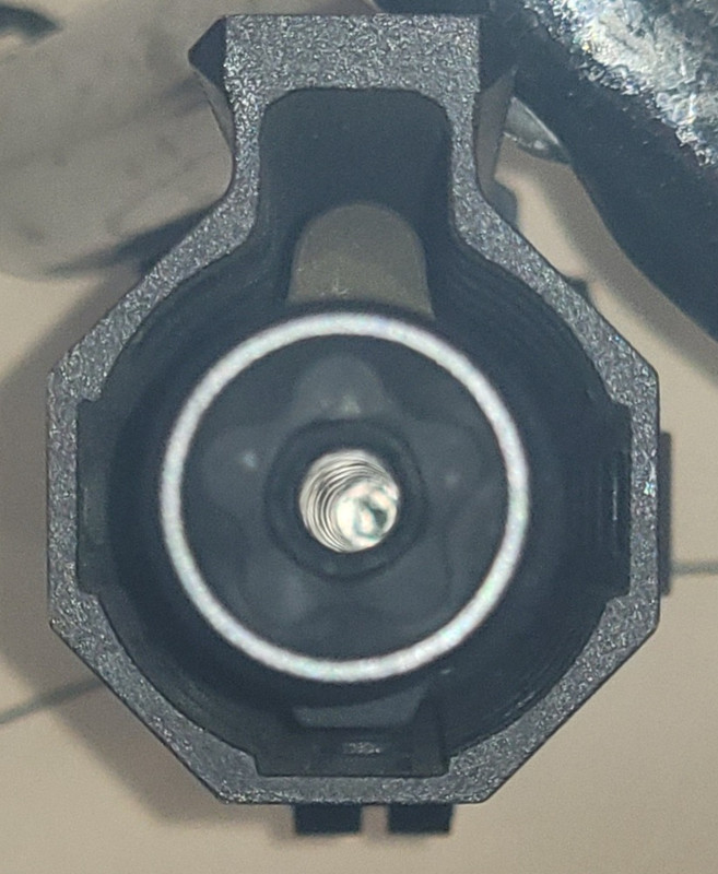

Just did a detailed scan of just that.  Both before and after a detail clean on this abused barrel.  I'll do the chamber and leade later today, and post how much they grew as well
BCM Muzzle break held up remarkably well.  Can barely tell it was even used.

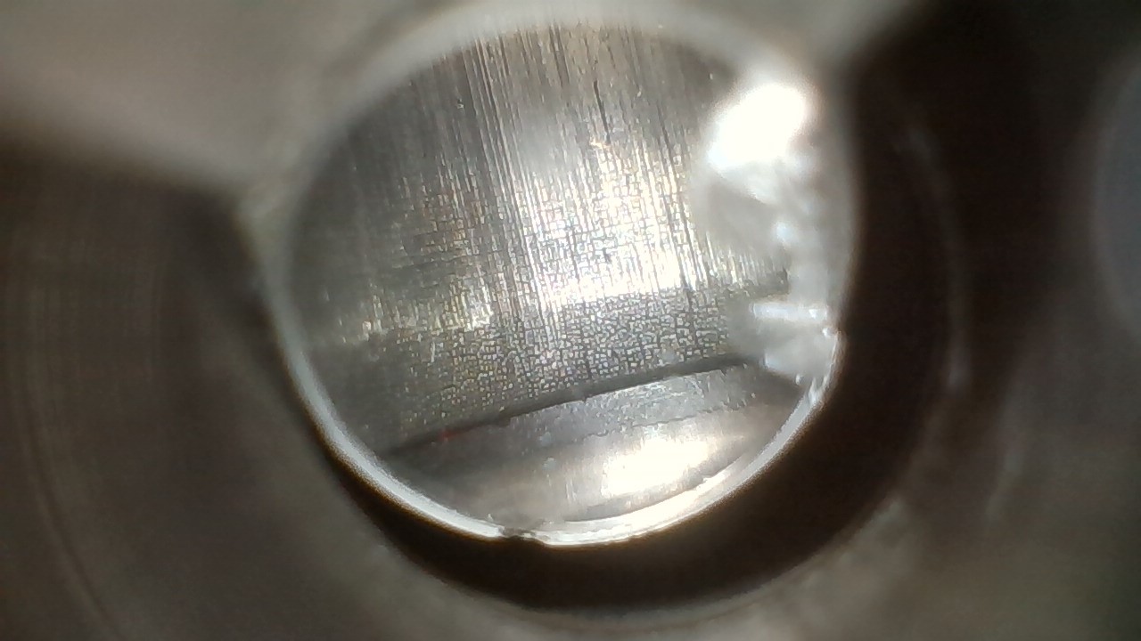

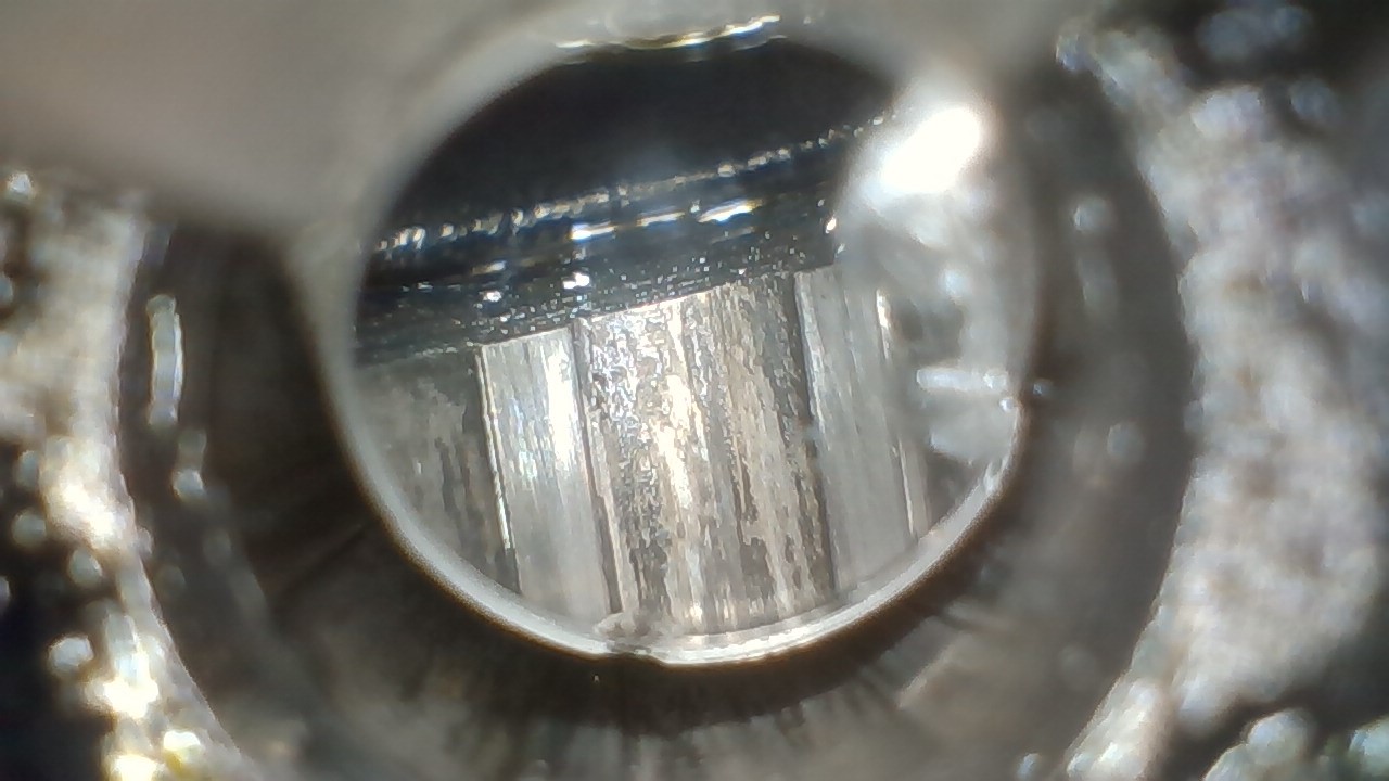

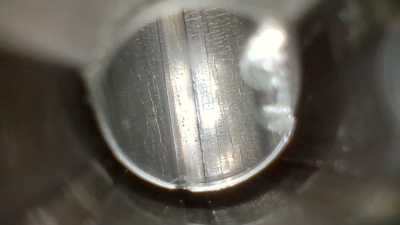

Here's what the bore looks like at 11030 rounds - this is the photo set BEFORE cleaning it.
A bit rough in spots.  Well... in pretty much all the spots.  11030 rounds at cooking temperature in a 10.5 BBL is a hard life - this barrel actually held up well, and is still shooting brass cased 55FMJ ammo just fine.

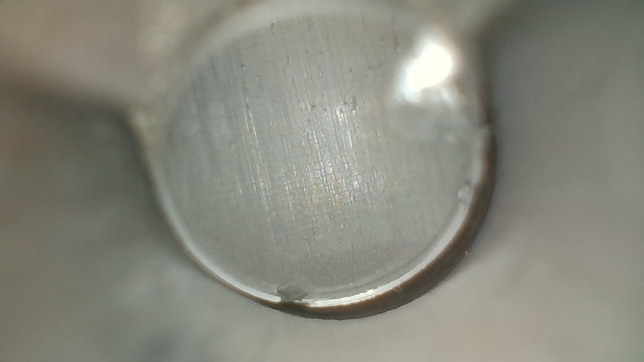

And here's what it looks like after a pretty detailed chemical cleaning.  Starting with a Free All penetrating oil soak to get the carbon out, and then a BoreTech CU++ hit with many (many) many wet patches, to get most of the copper out.

To the question on how did the BCM muzzle device hold up to the abuse and high pressure discharge and blast.  Here are photos of it after cleaning it up.  Looks pretty much new.

Found a  photo of the knock-off Gamma afyer I wore it out in a few thousand rounds, before finally switching to the BCM.
It still worked actually,  mostly I replaced it seeking something less blasty.   Flat baffles bouncing it right back at you, and 10.5", aren't a great mix, BCM uses a 45 degree conical baffle that's far more pleasant.
(Thought about saving and selling it on EE for posers who wanted a build that looked like its been run hard. )

If I may ask, Any other details on the lower ?... buffer spring replacement schedule ?
I have to say, that your upper was truly a great bang for the buck upper.
And I gotta ask... the last bore scope pic.. of the PSA Logo where / how was that pic taken with a bore scope ?
Or just a random Logo pic ?
You bet!  Whoever sends me an 11.5 barrel can have my 10.5 - slightly used!.  I'll send the bolt too if a swap is desired.  BEWARNED, I'm going to run it too - and post about it, so be confident!
Seriously - @PalmettoStateArmory is the best thing that ever happened to the AR community.  They make solid kit.  If this thread doesn't convince, I don't know what more is needed.  I laugh at fools who besmirch PSA.  They are all the good parts of the NORINCO and PolyTech of our time.  And then some.
As to the lower.  I did put an H buffer in it.  Same factory spring.  I SBR'd it and got rid of the arm brace.  I like it better now.
I only ran a few hundred rounds suppressed.  TBH, it loved it and ran great.  I shit talk supressors (a lot), but can't deny, it was kind of great.   I never felt the gassy blast, had any jams, or anything like that.
Really, the most profound Usage Effect from a muzzle device was with the Gamma Break.  I'm not kidding. First shot, I put the gun down immediately and looked for damage - as I though the gun blew up, the blast was that intense.  After realizing it was just the break, I shot again, and AGAIN thought I blew up the gun.   Those are great breaks, but just brutal on a 10.5 - so much more pleasant with the angled cone baffle design of the BCM unit now.
BTW, also kinda love my Sightmark Wolvorine.  Got it for $100 on Amazon on sale - I won't say it's worth $200, but it's been a great tough sight that holds zero and takes a beating - I will say that.

Link Posted: 1/5/2024 12:19:39 PM EDT
What a great thread and documentation. Fwiw I am with OP on the barrel length - it's fun, mine has been perfectly reliable, however I've shot a few animals with it and from my experience I want a little more velocity for game.
On to the gun at hand, I'm surprised the gas port doesn't look worse and you haven't had to swap out the entire bolt. But very cool, love to see this kind of info. Man, how I wish I'd kept this kind of log on even just a couple of my heavier-use guns!
I agree 100% on your PSA take too, they're the best thing that's happened to AR15s since I've been around. When I got into guns 10 or 12 years ago the market was a confusing zoo, and now we can get a sub-$500 fully built AR that works and will run 11k+ rounds like this. Crazy and awesome.
Then PSA grabbing a vine and swinging into the thread is the cherry on top

Magnificent thread. I don't know how I missed this one.
I have this same 10.5in. barrel and this is very encouraging. Mine will never see this level of stress.
Originally Posted By lazyengineer:...the gas port actually looks better than I expected...
That struck me too. I've read where port erosion is supposed to be a problem at surprisingly adolescent seasons of barrel life. At least not in this case. Also, the way it's eroded is interesting. I was envisioning concentric erosion opening the port all the way through. That would definitely effect how it runs. This angled sorta ramp shaped wear still leaves the same overall port size. Maybe it introduces a slight venturi effect or something. I don't know. Probably not.
Good plug for Toolcraft BCGs too.
Rather hip n groovy of Josiah to reward our friend here for his fine work and priceless marketing. Not many, in fact maybe NO other companies would do that. This kinda community smooching would enrage the gun haters. The last thing they want to see is AR enthusiasts who are nice people.
