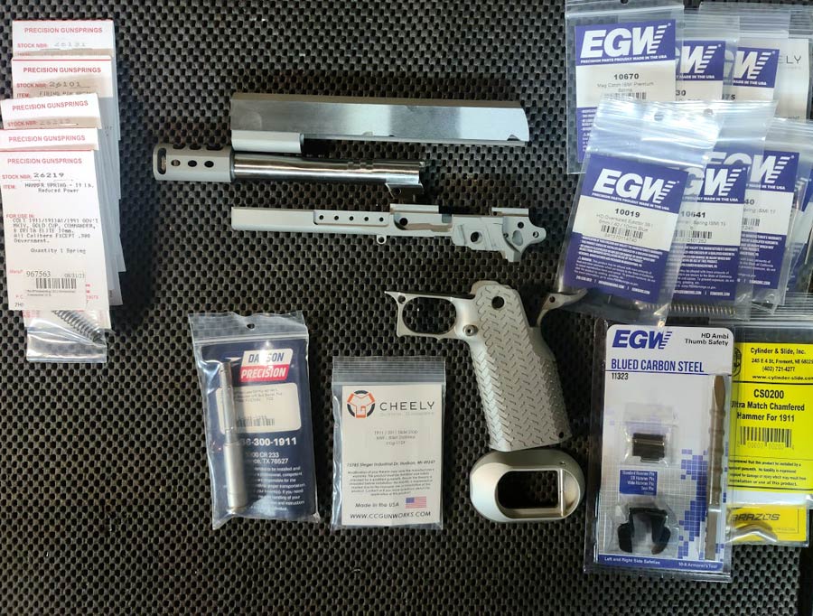

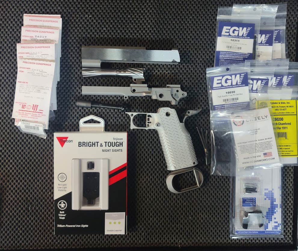

Originally Posted By JohnnyO223: https://i.postimg.cc/nckYH6MD/3613-D7-FC-3-CEA-416-B-B6-B0-AF89921502-D6.jpg View Quote Sweet ! |
Originally Posted By JohnnyO223: https://i.postimg.cc/nckYH6MD/3613-D7-FC-3-CEA-416-B-B6-B0-AF89921502-D6.jpg View Quote Wow, awesome, can you list the build specs? Thanks! |
