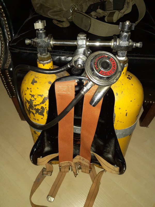

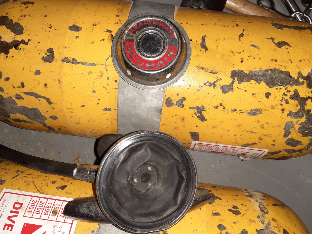

Took a break from modern stuff and rolled to BHB today with my lp45 twins, Healthways SCUBA,  and a 3mm cammo wetsuit and my new fav $16 mask.
As usual, no bcd.  I swag'ed it figuring I use 4lbs of lead with the 3mm normally, so I used no lead.
I could tell right away I was a bit light, but still doable. I think 1.5 or 2 lbs would be ideal for shallow stuff.  If deeper, no lead needed.

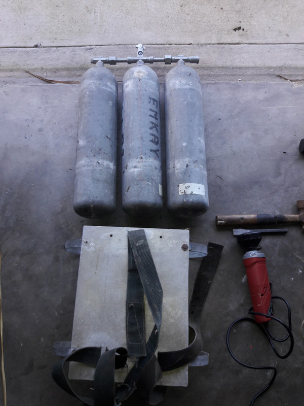

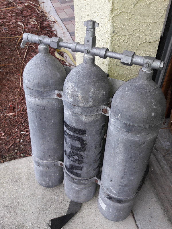

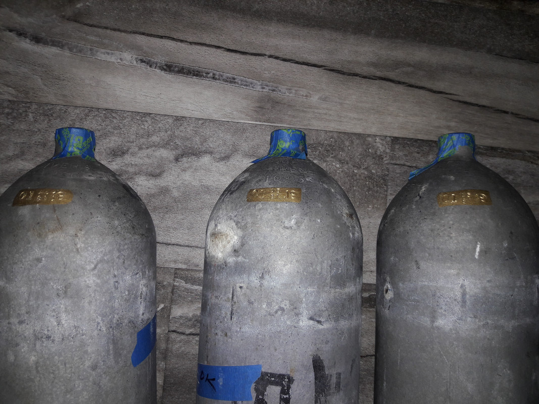

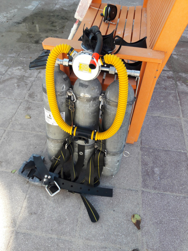

New project.
Holy Grail tanks for me.
Triple US Divers (Rene)
10/56 born dates
I believe they are 44's, maybe 33's.  Still need to confirm.
Note the lead burst plugs, lol.
These will complement the Mistral of the same period (56-59)

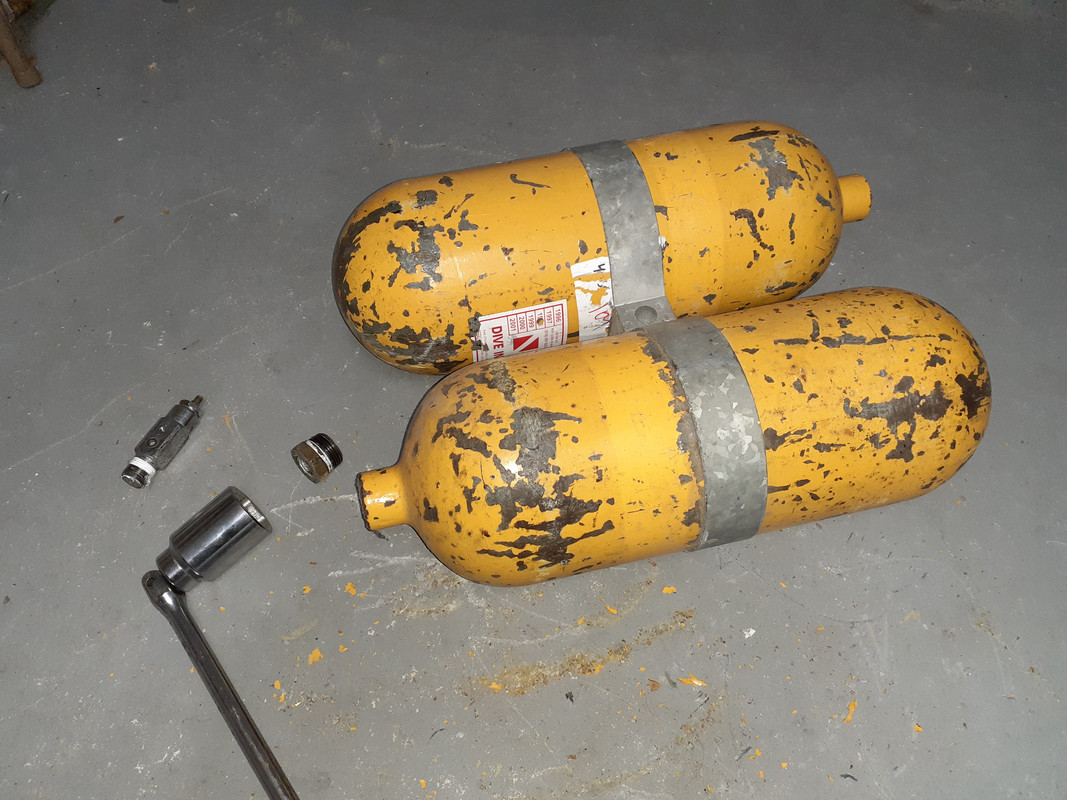

[Last Edit: bap] [#14]

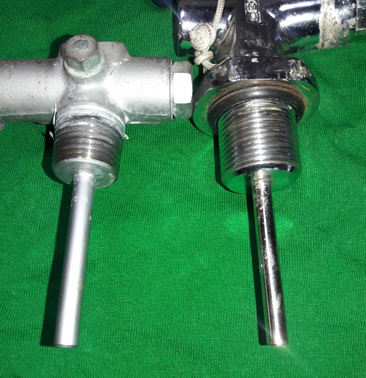

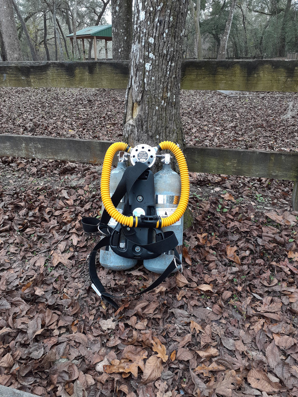

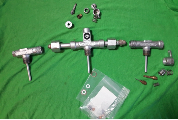

Broke down the triples a few days ago.  Had to use a cut-off tool to remove rusted bolts against the bands...very nervously.  No damage. Yay!
I will be making a harness that attaches directly to the bands similar to the original.

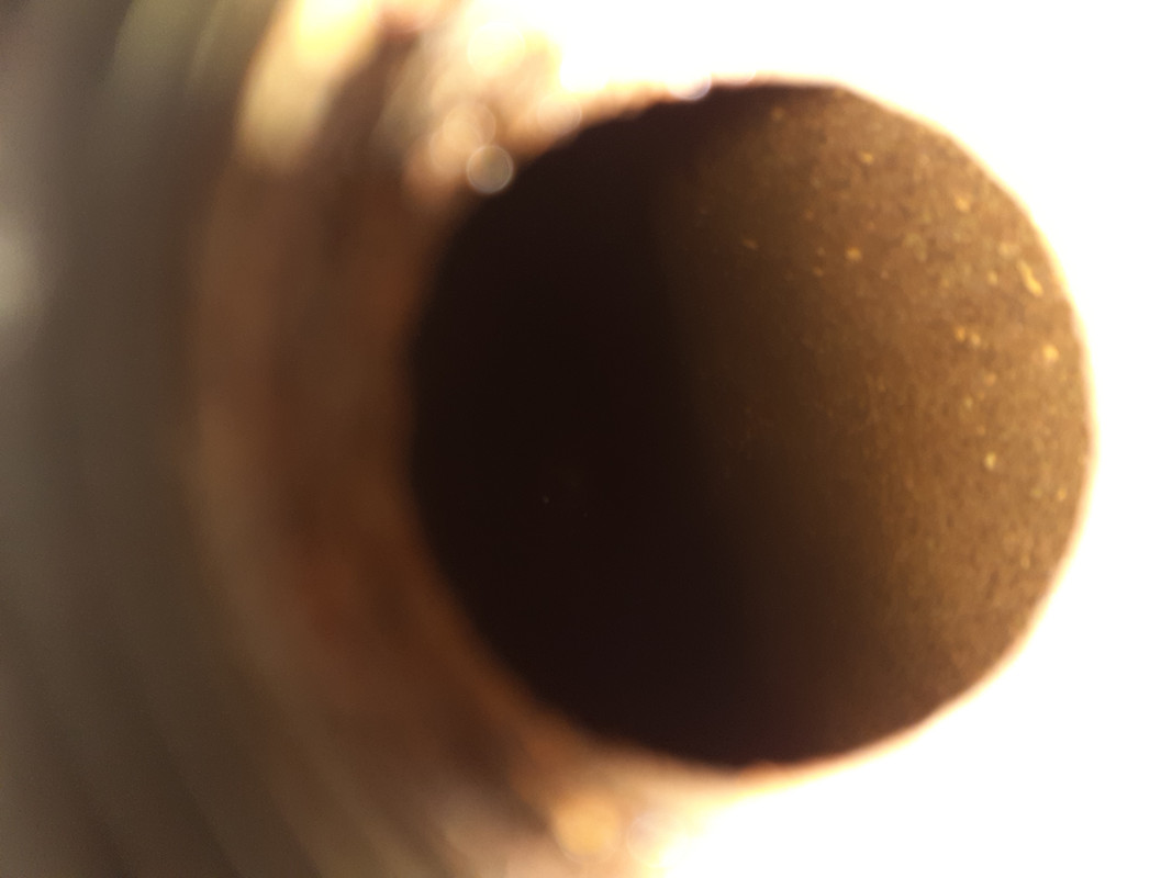

Focusing on the priority and the iffiest part, the tanks.  I expected rust since they are 63 years old and their last service was in '74.  The 2 outboard tanks are the worse.  I thought the center one would be being it is in direct route and closest to the inlet.
I have tumbled all of them with a diy improvised tumbler first with gravel and then alum oxide.  Large stuff is gone but still rusty.  Will be doing an acid wash this weekend.
I bought a CHICOMfrieght inspection camera to inspect and measure progress and has worked out well.  I will be making a gauge that will fit in front of the camera so I can measure gouges and pits.   Not seeing deep pits yet though.
I have owned old tanks with 1/2" NGT  valves, but never worked with the same tank.  What a PITA.
I really hope to pull this off.  Somewhat OK if the tanks dont make the cut.
I am only into them for $145.   The manifold and bands are worth a bit more (of course to a nut that really wants them).
The other upside to this is, I will save considerable $$ on my next colonoscopy

Opted for a less severe cleaner, evapo rust.
Worked well enough.  I had to hit two tanks with a alum oxide tumble to detail the walls (after final prep and dry no less).
There are spots on the walls, but too slight to worry me.  Barely measurable using the gauge I made.
Nothing more I can do, just need to get them in to hydro shop next week.
Old vs newer std threads below
1/2" NGT vs 3/4 NPS.  Old threads used dope or teflon tape to seal (no oring)

Link Posted: 2/2/2019 6:23:04 PM EDT
Harness is ready.
Have parts for manifold now.  Should have it all assembled tomorrow.
Made the tank to reg washer as these are pretty unusual.  Sharpened .357 case makes a perfect punch
Link Posted: 2/10/2019 3:26:10 PM EDT

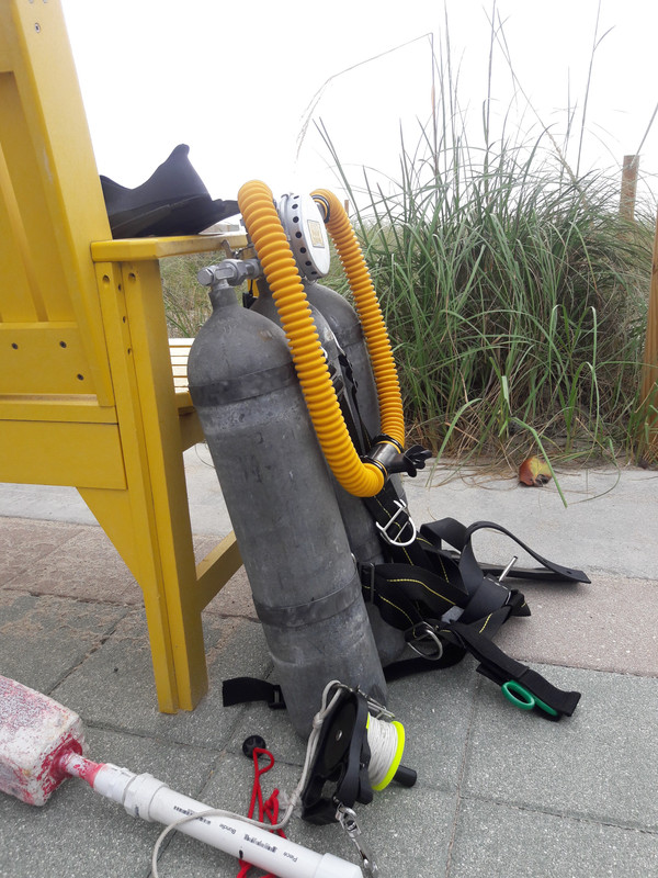

Took a bit longer than planned.  Band bolts too short, multiple leaks, some minor harness issues.
Got 3 hours in this weekend.  I was waaaay off on weight needed.  SWAG'ed it and figured these would be close to lp72s doubled up.  No.  These are crazy light.  Upside is these will be easy to dive without wetsuit in the warmer months here (no bc too of course ).

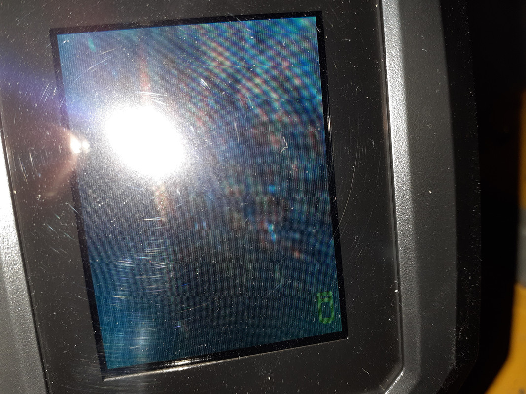

Bad bigfoot quality pic, video snapshot.  I dive solo, and this was no exception.  I saw a group I follow on FB while under.  Sure enough I was on his video.  Didn't know I was being shot at the time.
Matched to the Mistral of the same time period.  Crotch strap will be replaced when I have more of the black and yellow webbing.

[Last Edit: bap] [#21]
@tigerforce I would love to find a Trieste.  If you have any old pics, post them up!.
First dive I filled it to 2k (107cf).
2nd dive 1550 (83cf).  I figured/planned I would get to use the reserve on the 2nd dive, but no.  I cut the dive short due to vis and I was hangry.  I know it works as I tested it before I buttoned the manifold up and then I forgot to open it when filling (a must!).  A definite audible swoosh of air makes its way to the reserve tank.
I chuckled at first when I saw there were two options for the reserve in the original catalog, 500 and 700 psi.  But, all things considered, the triples or larger doubles were marketed as deeper diving/duration tools, so a little more reserve is a nice option.
They were stamped so, along with the model and date of mfg.
I think I will move the bottom band up 1" as it (waist belt) rides too close to the weight belt.
One thing leads to another ($$) and I am ordering a rubber weight belt with wire loop (like the originals).  Rubber should be more forgiving and I can lower them on my hip comfortably.

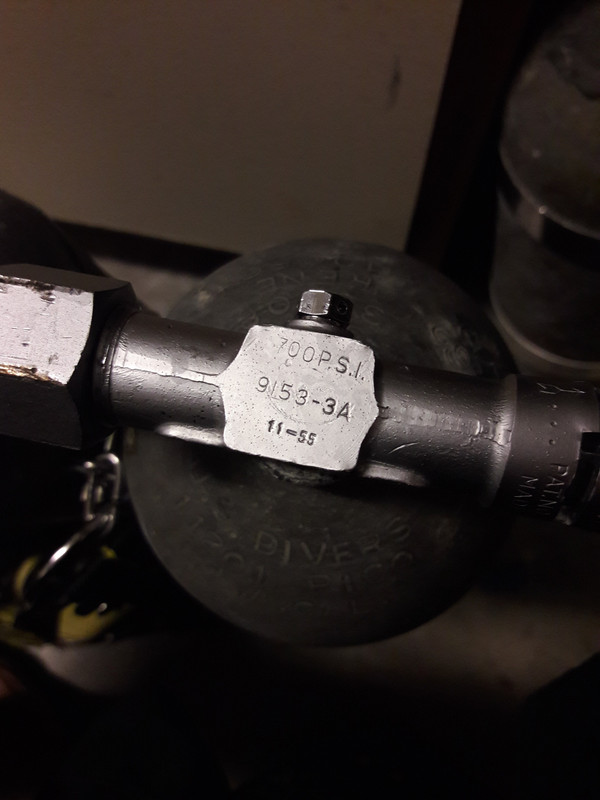

700PSI
I got a fill to 4100 PSI once. We ended up doing a 2500 foot penetration and I still returned with 2600 PSI at which point my tanks were considered full.

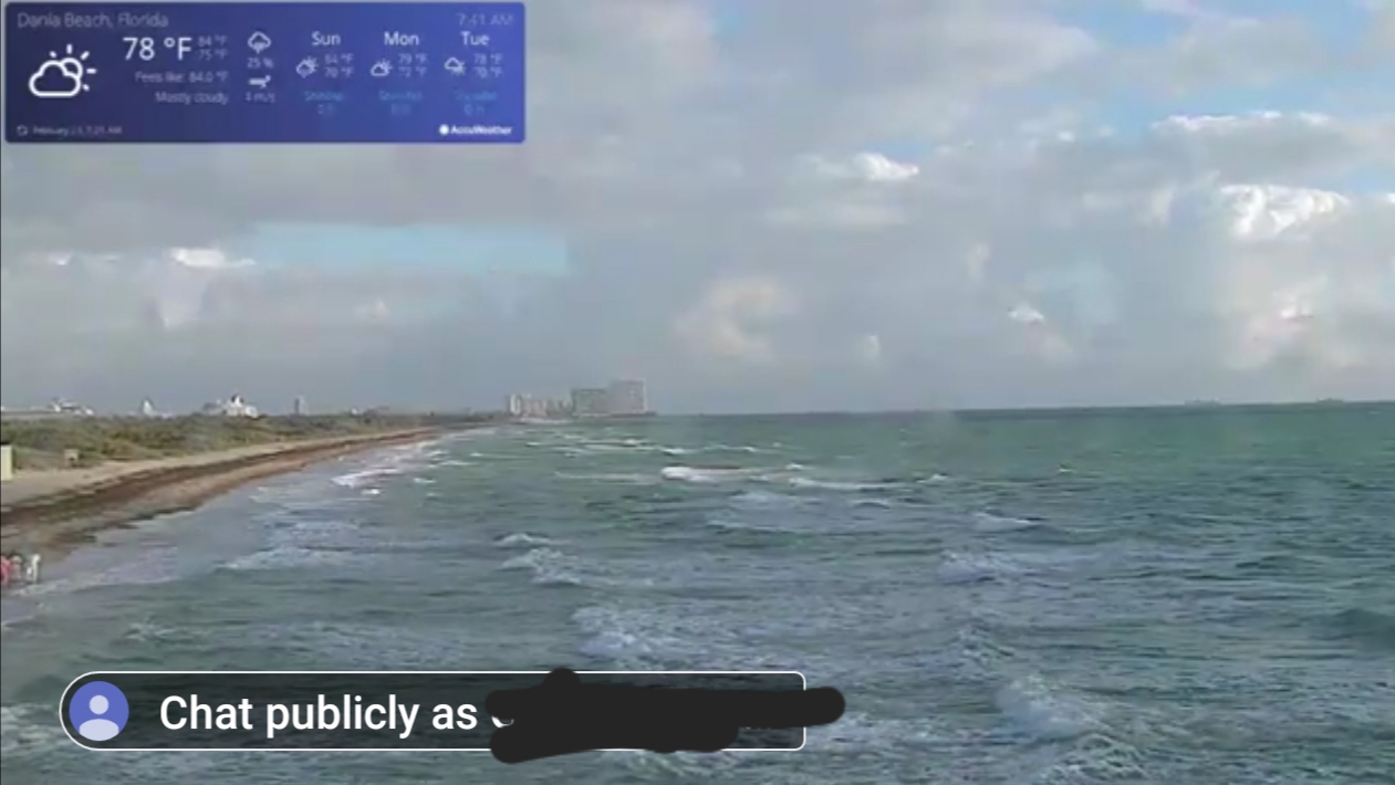

Got in a 90 min dive on Friday.  Beach conditions not optimal this weekend.

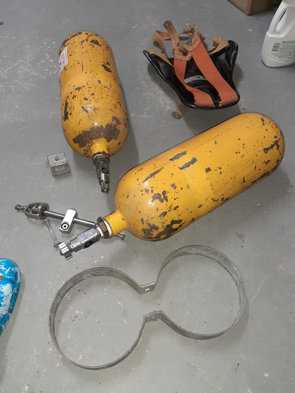

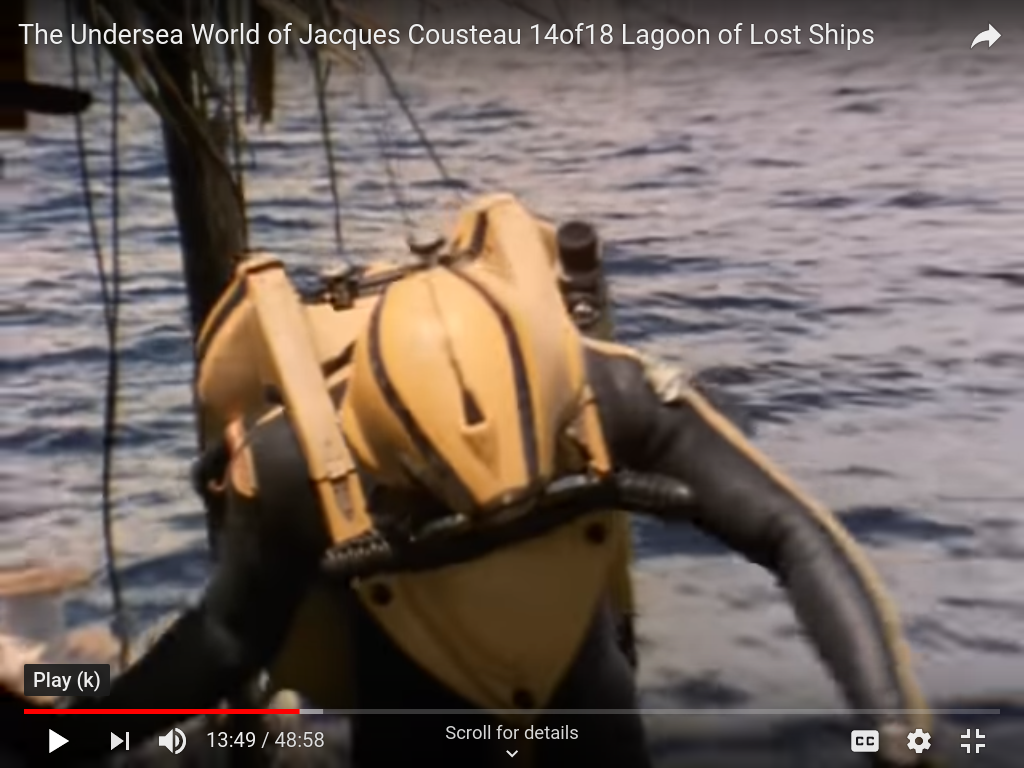

I think I found my next project.
Rig the DAAM as a chest mount like the man himself..
I have everything but 1st stage plug and harness. VDH has plug.  Harness is easy enough.  I think mated to a mkv would look the part.
I found a set of twin 38's (ww11 aircraft oxygen tanks with bushings to accommodate 1/2 ngt valves).  Think I will pass though.

Took the triples out this morning.   First time without a wetsuit so SWAG'ed weight needed at 4 lbs.  No, no lead needed, maybe a 1 lb.  My BFK will suffice next time.
My vintage snorkel is toast, so used a compact J.  Not long enough to plow through surf (light this AM).  The old ones were long for a reason.
I had mentioned earlier that these are Rene tanks.  For those that are not familiar with him starting US Divers click below for a read.   Interesting character with some vision.  Cousteau capitalized on his problems and here we are.

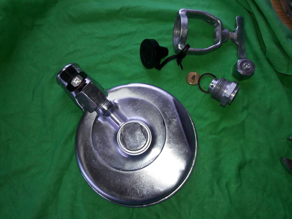

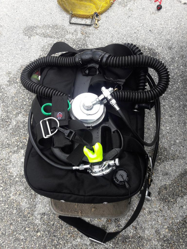

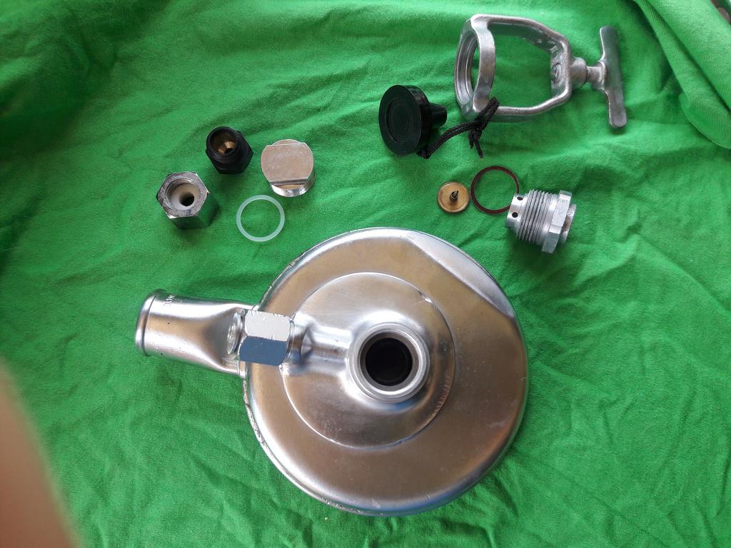

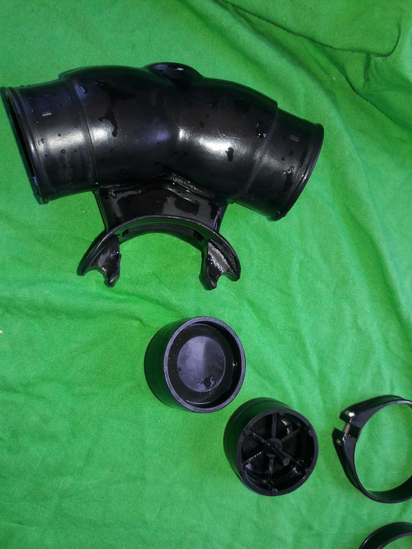

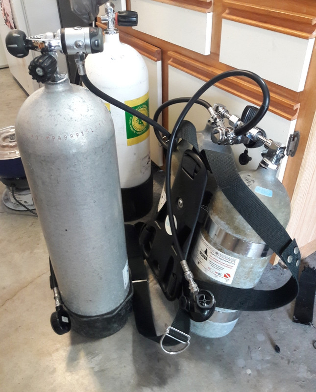

I received the parts about a week ago and finally got around to putting it together yesterday.
Took it out today in some pretty green surf off of Hibiscus, and will call this a success at this point.
This is not plug and play like advertised.  Part of the problem lies in the higher, consistent IP.  I mounted it to the Scubapro MKVI which is around 125 psi.  I have an early Conshelf that would be a better candidate as one can dial it in to whatever you want, with a quarter no less.
I knew relocating the can would come with some issues, mainly free flowing.  I have overcome most of the problem with a longer LP seat spring that I pulled from a destroyed Beuchat's balance chamber.
Current mounting will not work as there is too much play.  But, with the play I was able to hold it different locations to determine its best location.
I will say, I am able to sip air through it though.  These are not known for this for sure lol.  I can see why the Cousteau peeps mounted as such.  AFAIK, they used Spirotechniques, not a DAAM.
Required parts on the left, 1st stage on the right.
Fitted
Reversed one-way valves because the can is flipped.
Mounted.  I was able to mount the DGX wing to the twin 45's simply by adding a bolt hole grommet to the wing's center strap.  I am unable to dive these negative tanks sans wetsuit for bouyancy compensation (dive with a skin in the summer).
Feeling artsy today
From one of the Cousteau documentaries.   The can is hidden in the bracket covering the diver's chest.
Link Posted: 7/13/2019 4:27:37 PM EDT
Second round of testing.

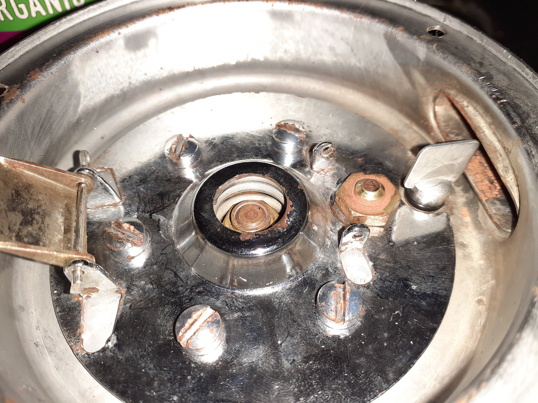

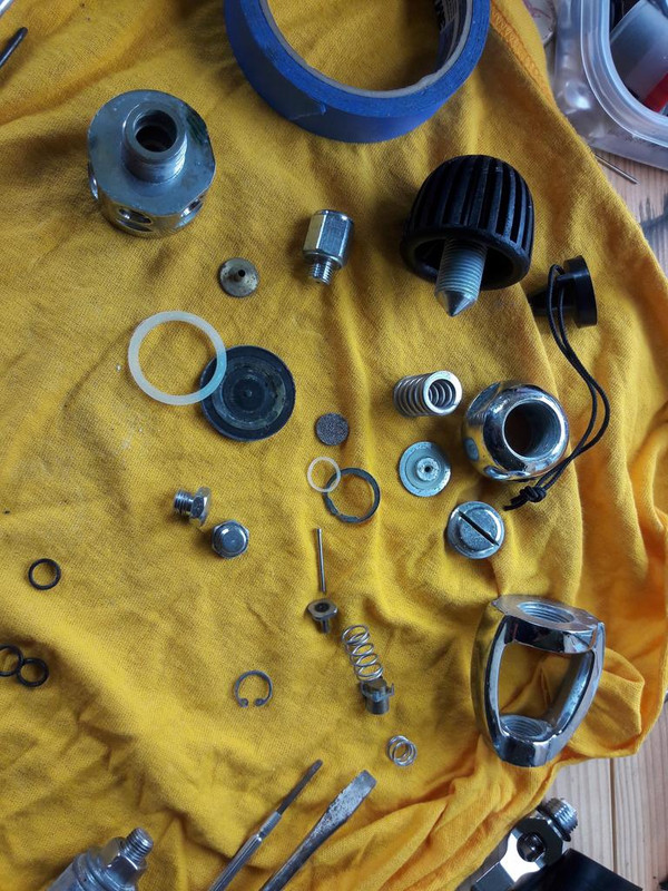

Overhauled the Conshelf and set to IP to 100 psi
Typically you will see scratch marks on the diaphragm seat from improper removal.  This one was clean.
One of the few spots that have Staghorn Coral in SoFlo.  Can't help myself to stop and admire whenever I find it.
I prolly should have set the IP to 80+ as it is a bit still hot.  I used my Dive Rite ABS plate and DGX wing combo along with the lp76.
Will make more adjustments and keep testing.

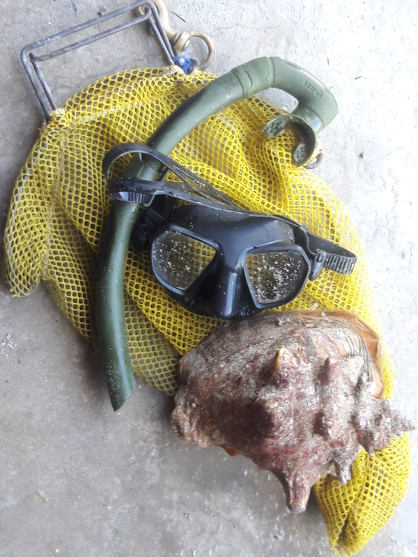

Finally got out today post Dorian (well tropical storm).  Visibility improving.  10' at best, 15-20 you can make out structure.  Beats going to work any day.
Don't know why I picked this one up as I collect whole conchs, but this was a fresh lunch for a nurse shark I suspect.

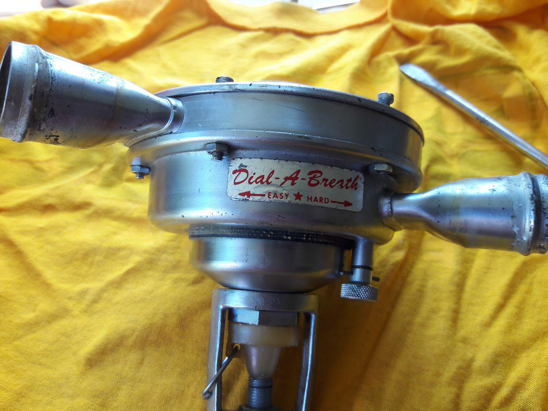

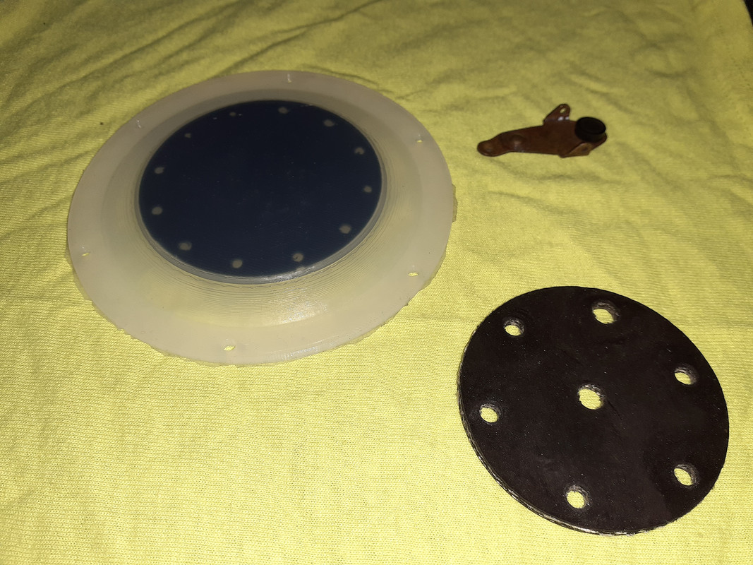

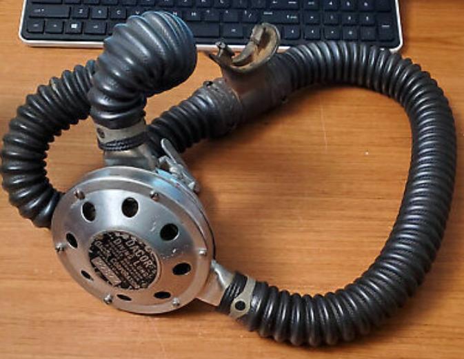

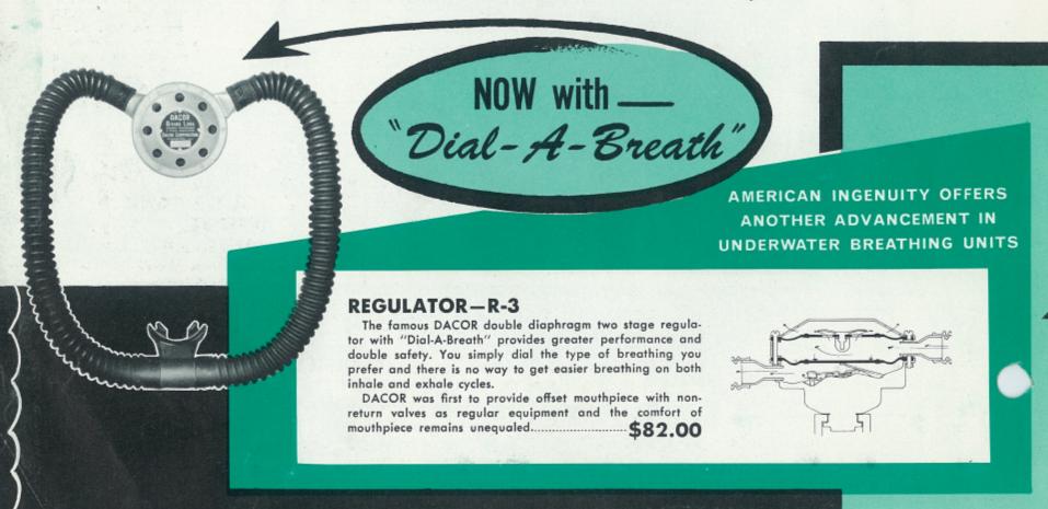

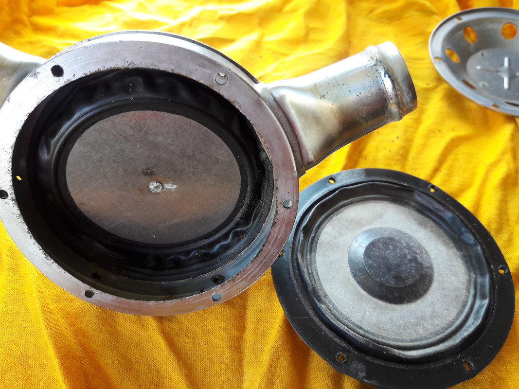

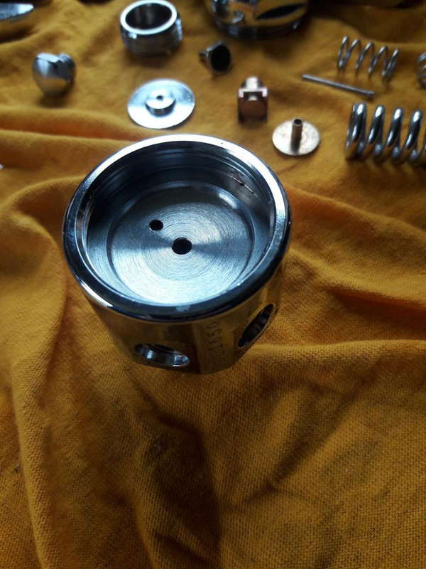

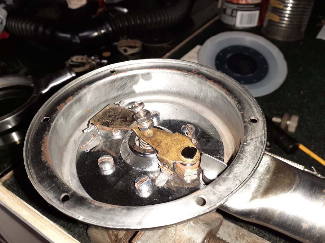

I picked up a Dacor Diving Lung last week.  I had thought it was the R4 model and wanted to try one if the price is right.  Dacor's are risky as no one is making repro diaphragms for them.
This one is in fair shape, but turns out to be a late production R3.  Sadly, the main diaphragm is toast .
Interesting design in that it used a dual diaphragm. The exhaust diaphragm acted in conjunction with the primary and pressed against the main like a piston.  All of this to skirt the USD/Cousteau patent.  It also had a user operated venturi.  I believe this is the first production regulator to have this.  Funny that it was offered for the opposite reason they are intended -- the logic was, the harder it breathed, the less air you will use.
These were affectionately referred to as 'dial a death' regulators.
I can modify one from a USD or Healthways diaphragm to work, but that would mean making a new lever and eliminating the exhaust diaphragm and using a duckbill exhaust.  I will wait it out until I find one.
Interwebz Barn  fresh
from 1962 catalog
tinnerman clamps

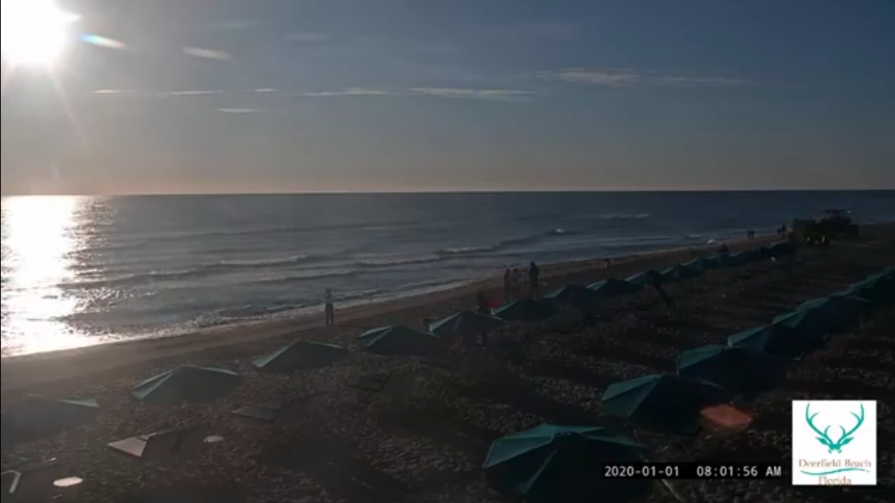

Slipped out New Years Day for a morning dive..
Couldn't resist after recon..

Ordered parts for the Healthways for service.

Scored a set of twin 38's
This is a hard one to find.   Up there with the tripples I have.
These were assembled when SCUBA tanks were not produced.  The tanks used at the time were surplus mil O2 tanks from aircraft.
One of these is from 1948, the other 1953.  Bushings were used to adapt the tank to a SCUBA valve (1/2"NGT).  The pack is a metal Sportsways.  The single stage is a Healthways.  No manifold, but has cheater/suicide bar.
$35
The Mistral will match this perfect, if I can get is past hydro

Cover from PS of the era. DIY was the way.
Havent torn into the 38's yet.

Link Posted: 5/24/2021 4:30:29 PM EDT
Finally getting things sorted at the new place.
Time to look at the 38's.  Dismantled them today.
I struggled for a bit getting the bushings off.  Keep in mind these are pipe threads, so tight means no leaky.  I then  remembered I have a large set of sockets which made it a whole lot easier.
and a drum roll as to how they look inside.  Pretty rusty lol.   I have brought back similar with an acid tumble, so that is next.
Still worth a shot to see if I get them to hydro considering what they are.
I have an endoscope for a phone, but for an older phone.  You get the idea...bad.
Also, the diaphragm on the Healthways Scubair is toast.  Not a priority now, but down the road.

Update on the Dacor DH.  It's alive.
A guy on SB started making these from a mold he 3d printed.  Sounds sketchy, but I am in.  Very difficult to find ANY of the 3 diaphragms for these [main, exhaust, and HP diaphragm].
Received it last week and actually I am impressed.  Now I can proceed with overhaul as I gave up on the project pending finding a diaphragm.
More problems.  The LP seat has hardened and is a rounded shape and would be odd to recreate.  So why not modernize this SOB?  I'm in again.  I flattened the dimple on the orifice lever and drilled a hole.  I then turned a seat holder with a press fit post to install on this lever.  More problems you say?  The lp orifice had to be turned down/shorted a bit as the increased depth of the new retained interfered with installation.  Ok, done, right?
No.  The new diaphragm is domed, not pleated like the original.  The original diaphragm was virtually flush with mounting surface.  There is no way to bend the demand lever enough to reach the bottom of the new diaphragm plate.  So....I flattened and drilled a hole in the demand lever, added a small dog-leg bend, and a SS screw with jam nuts to make this happen.  It works.  Also, it's now adjustable.  I don't consider this modification permanent though.  I will have to rethink the lever mech.  The spring tension of lever set was wicked.  I cut half a coil and there is a noticeable difference now.
Can we put this back together now?  No.  The huge [1/8" x 2.5"] HP diaphragm has a crazy hard set to it and is cracking.  Hmm.   I find some modern EPDM sheet and fashion a new one.  It's not easy cutting this stuff, and still have it look good.  I wound up making a set of tools to actually cut this stuff on my drill press.
Bam, looks good.
Being there likely no chance of getting a matched exhaust diaphragm, I robbed a duckbill exhaust from the DAAM and installed it on the Dacor.  Also, I borrowed the hose assembly from the Mistral to do a test.
Assembled and tested.  Hmm, IP seems a bit low just judging by the swoosh one should hear.   But Ok to splash with it for now.
So, today I went to Royal Springs [my test pool].  Besides the normal group of side-holes silting up the place, still nice to get out of the compound.
It's breathes a bit stiff, so an IP increase via a captive shim will be needed.  I also suspect adverse leverage of the modified demand lever and/or the lever mech spring is still too stiff.
Other wise, it runs!
New diaphragm, modded LP seat, and freshly cut HP diaphragm
LP orifice fix
Sketchy demand lever mod
Post dive at Royal.  The yellow looks odd on this to me.  I'm thinking grey hose with black mouthpiece
The twin 38s are next to be cleaned.  Just did my lp76.
