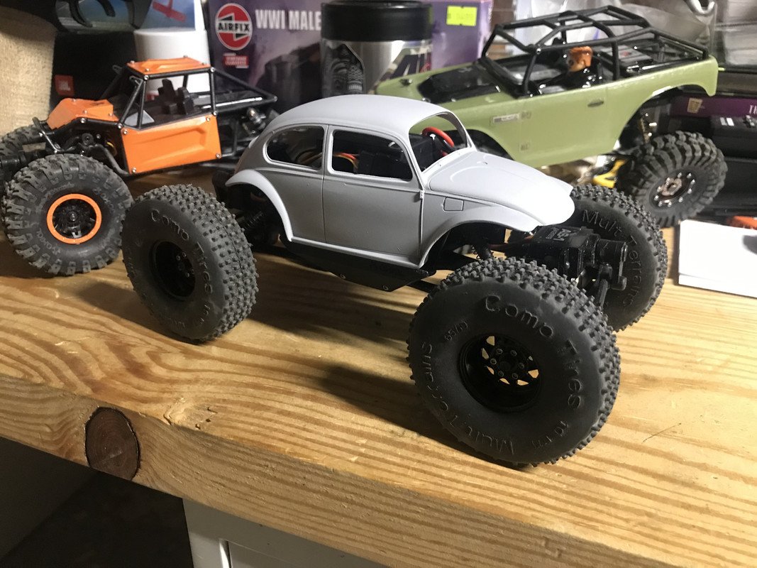

In the process of doing up a Revell 1/24 VW bug plastic model kit as a body for my Axial AX24 crawler.
