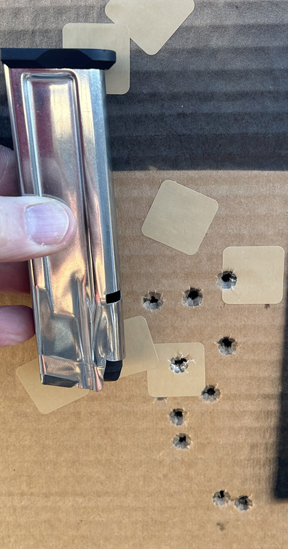

A little photo montage of the Tisas 1911 DS Carry (4.25"). Scale pic is with mag inserted, makes Carry Optic weight in IDPA if that interests you.  Straight out of the box, wiped off with an old bar napkin.
Overall appearance is that this is not a Wilson Combat, not a Prodigy even.  It has a very utilitarian appearance, Cerakote is done well.  Crisp engagement of the ambi safety, slide action is smooth, Trigger pull is 7.5-8# measured (7#12*), reset is pretty good.  The trigger is not adjustable, but at this price point that should be no suprise.
I loaded the mags and both would take 18, one was very firm at 18, the other was reloadable with a firm tap.  They seem good quality, basepads are plastic with a button for fast disassembly.  They have a full length rib to the bottom of the mag which seems a reliable design.

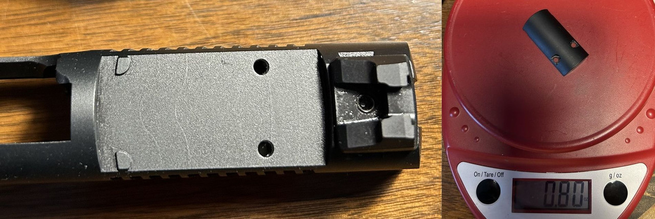

Next view is of the optic cut, it should be RMS-c/Holosun K footprint.  Looking at some Youtube the rear sight is supposed to be a Glock cut.  This should still make IDPA weight with an optic installed.

Random parts, Barrel looks ok but the barrel face has some rough milling, no recessed crown;  Fired at the factory; GI guide rod, short bushing.

I tried a Holosun PL2 and a TLR1 and both do not fit this rail.  Here is what you seek:
I dug up a Holosun K and screwed it on, super tight fit.  Installed sights line up with a lower 1/3 visibility.
I ran out to the shop and found a stock Ruger SR1911 sear spring and installed it.  Trigger pull dropped from 7.5# to 4.5# with no other adjustment.

I did not zero the optic, just did a mag dump test.  POA with a dot off another gun is at the magazine basepad.  I will get out and zero optic and see how the accuracy fares.

My two examples are off the production line, sequential numbers.  Both of my single stacks had decent triggers.  A sear spring tune is very minor if that is all it will take.  I had edited my earlier post, you may not have read it.  A Ruger sear spring I had in the parts box lowered the trigger pull to 4#6*.
I forget how to embed Youtube, 4 magazine burn down (only 2 on video) right out of the box.

Anybody have experienced with taking off the MAC optics plate cover? It looks like an Agency AOS cut and I know with those you’re supposed to lift from the front of the pistol first. I took the two screws off but the thing won’t budge and I don’t want to start beating on the slide with a brass drift just yet.
Attachment Attached File
Link Posted: 2/18/2024 8:12:59 PM EDT
Never mind. I used a brass punch that roughly matched the ID of the cover plate screw hole and used the punch for leverage. The fit/finish so far is giving me high hopes for this thing.
