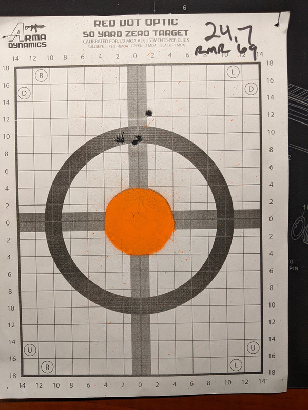

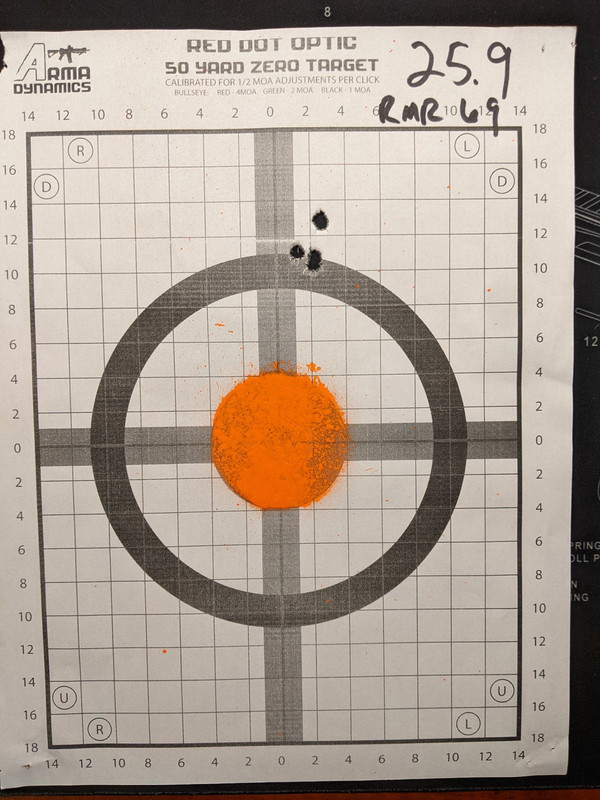

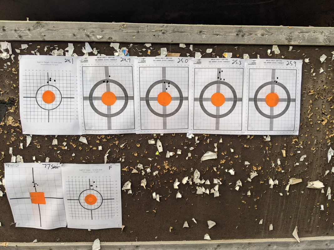

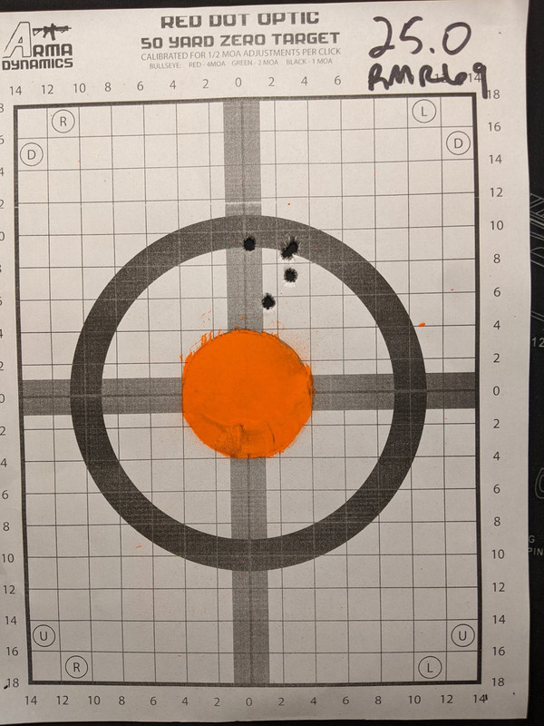

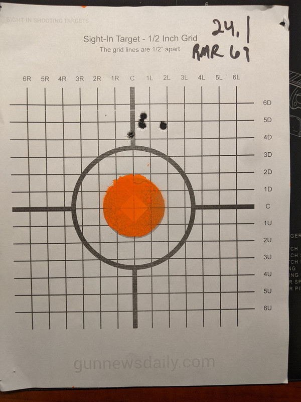

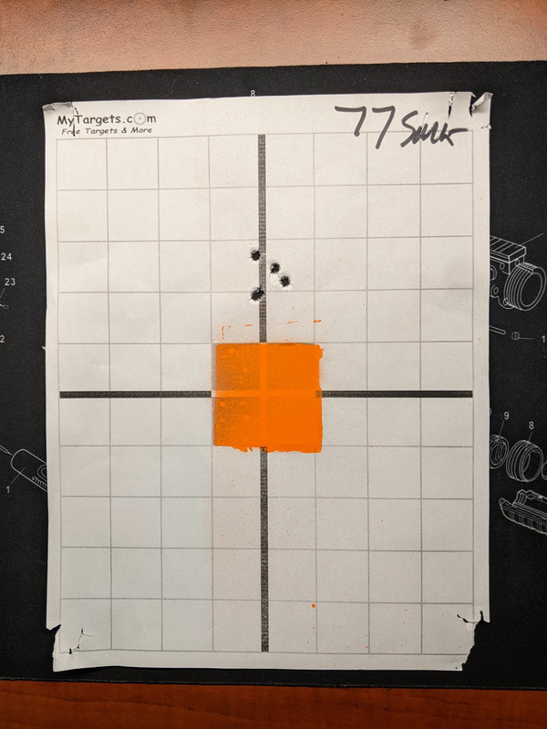

Originally Posted By ZA206: Here are my results from today. Promising, but not anything special at this point. I don’t think I had my best stuff today, as I seemed to get eye fatigue and towards the end felt a little rushed. I also was having issues with my bench as it has a very slick top and my bag was sliding all over the place, but I think I got that squared away about midway through the first set of TAC loads with the LW50 rifle. I did not chrono this work, but will chrono future development and seating depth tests. Here are the work ups: 69 grn RMR XBR (23.1, 23.4, 23.7, 24.0, 24.3, 24.6, 24.9) Wolf primer + LC brass COL = 2.25" 69 grn RMR TAC (23.2, 23.5, 23.8, 24.1, 24.4, 24.7, 25.0) Wolf primer + LC brass COL = 2.25" First set with TAC & the LW50 https://www.ar15.com/media/mediaFiles/114221/79FA7B03-E2E3-402B-A73C-E0033EFCF2AF_jpe-1908587.JPG Fourth set with TAC & the LaRue https://www.ar15.com/media/mediaFiles/114221/6E7F36C9-AC74-4490-90DD-677888CFA053_jpe-1908590.JPG Second set with XBR and the LW50 https://www.ar15.com/media/mediaFiles/114221/10F83235-C8A4-4644-9A12-5468B13766BA_jpe-1908591.JPG Third set with XBR and the LaRue https://www.ar15.com/media/mediaFiles/114221/95E2BE8E-600C-447D-BEA2-89966A88DFBE_jpe-1908593.JPG View Quote @ZA206 , where can I get some of these targets please? |
300yds, correct? I think your calculator is still set to 100.
Originally Posted By HighpowerRifleBrony: 300yds, correct? I think your calculator is still set to 100. View Quote 300yds, yes... didn't see where to change that setting Edit, found it, under the settings icon... was to default of "Remington 700", ".308 bullet", and "100yds"... I changed it to AR15, .224, 300yds. Uploading pics in a sec... |
Obviously super happy being sub-moa at that distance, but I sure am puzzled by the 2" difference in the vertical position of the groups. I don't see the chamber temp from the first few rounds causing that much difference in velocity?
Edit - just noting the group shifted about 2" right also. I did not know where I was hitting until I walked downrange. Just aimed for the bull every shot. Barrel was not cold, I'd say warm from previous firing but not hot. My Mosin used to walk up and right on me during extended firing... wonder if this is the same phenomena. |

Originally Posted By Sebspeed: Obviously super happy being sub-moa at that distance, but I sure am puzzled by the 2" difference in the vertical position of the groups. I don't see the chamber temp from the first few rounds causing that much difference in velocity? Edit - just noting the group shifted about 2" right also. I did not know where I was hitting until I walked downrange. Just aimed for the bull every shot. Barrel was not cold, I'd say warm from previous firing but not hot. My Mosin used to walk up and right on me during extended firing... wonder if this is the same phenomena. View Quote |
Originally Posted By HighpowerRifleBrony: I doubt a Shilen will walk that much. I'm betting Natural Point of Aim and a hint of wind letoff. View Quote View All Quotes View All Quotes Originally Posted By HighpowerRifleBrony: Originally Posted By Sebspeed: Obviously super happy being sub-moa at that distance, but I sure am puzzled by the 2" difference in the vertical position of the groups. I don't see the chamber temp from the first few rounds causing that much difference in velocity? Edit - just noting the group shifted about 2" right also. I did not know where I was hitting until I walked downrange. Just aimed for the bull every shot. Barrel was not cold, I'd say warm from previous firing but not hot. My Mosin used to walk up and right on me during extended firing... wonder if this is the same phenomena. Looking again, the way the paper is hung could have a little to do with it. My buddy hung that one with the thumbtacks while I was fixing steel and hanging paper at 200. I usually try to flatten the paper out more, and use tape. There wasn't any wind really, little breeze once in a while at the firing point, and honestly wasn't looking for it down range. The target backers were solid. |
Originally Posted By Sebspeed: Obviously super happy being sub-moa at that distance, but I sure am puzzled by the 2" difference in the vertical position of the groups. I don't see the chamber temp from the first few rounds causing that much difference in velocity? View Quote Odds are it was just you. Different grip on the rifle, different stock position in your shoulder, recoil managed differently, or head position a bit different leading to some parallax error. Small differences in how the shots were taken do show up on target. This is usually the answer when two groups shot at different times are both good ones, but shifted in their overall point of impact. However, since these are only 5 and 4 shot groups, in the back of your mind you should consider that maybe the overall load is not actually sub-MOA but rather larger than that, and you just happened to get a few shots low and a few shots high. 4 and 5 shot groups are useful in load workups but in the end if you can't make it shoot good 10 or 20 shot groups, it's not a good load. Also, you may wish to use mean radius instead of absolute group size when evaluating groups with larger numbers of shots in them. Thanks for posting your results! |

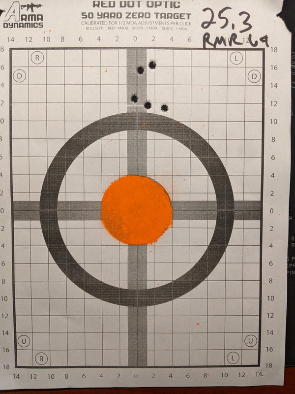

Here you go. Alliant Power Pro Varmint 69gr RMR OTM AR15 16" Larue Stealth 36*F Cloudy Tula SR 23.9gr 2.25 COAL NO VELOCITY TESTED Ejects 3 o'clock 0.5" 69gr RMR OTM AR15 16" Larue Stealth 36*F Cloudy Tula SR 24.8gr 2.222 COAL 2666 2672 2646 Ejects 3 o'clock 0.3" 3 shot group 1.5" 9 shot group, 7/9 shots landed in a 0.7" group 69gr RMR OTM AR15 16" Larue Stealth 36*F Cloudy Tula SR 25.3gr 2.25 COAL 2807 2789 2801 Ejects 2 o'clock 0.7" LIGHT PRIMER FLATTENING I shot some of the 24.8's in my 12.3 Hanson Barrel and my 12.5 Criterion CHF CL, which I am convinced is the absolute ragged edge of the accuracy of this bullet, and the hanson made a pitiful 4-5" group with an 8X vudu. The Criterion Printed a respectable 1.2" with an ACOG.... One constant at least for the weather and conditions around me SO FAR is that mid 2600's have been acutely more accurate than other velocities. I am convinced the 24.8 load is the final iteration of this particular combo. I encourage everyone else to play with seating depth too, but as you can see from these new results it may or may not matter to you. |
Originally Posted By navnmamaril: Great success. I've never seen a bullet more selective about barrels in my life. Here you go. View Quote Maybe I missed it somewhere in the last 4 pages, but what powder was this with? I'm very interested in replacing 69 SMK with these the next time I buy some projectiles. |

New test, looking great out of a 12.5 dudes! 69gr RMR OTM AR15 12.5" Criterion CHF CL 1:8 35*F Snowing Tula SR 24.9gr Alliant Power Pro Varmint 2.222" COAL 2484 2532 2534 (mixed headstamp) Ejects at 2 o'clock 1.6" 5 shot group (matching headstamp black hills NATO) 1.2" 3 shot group (matching headstamp black hills NATO) |
