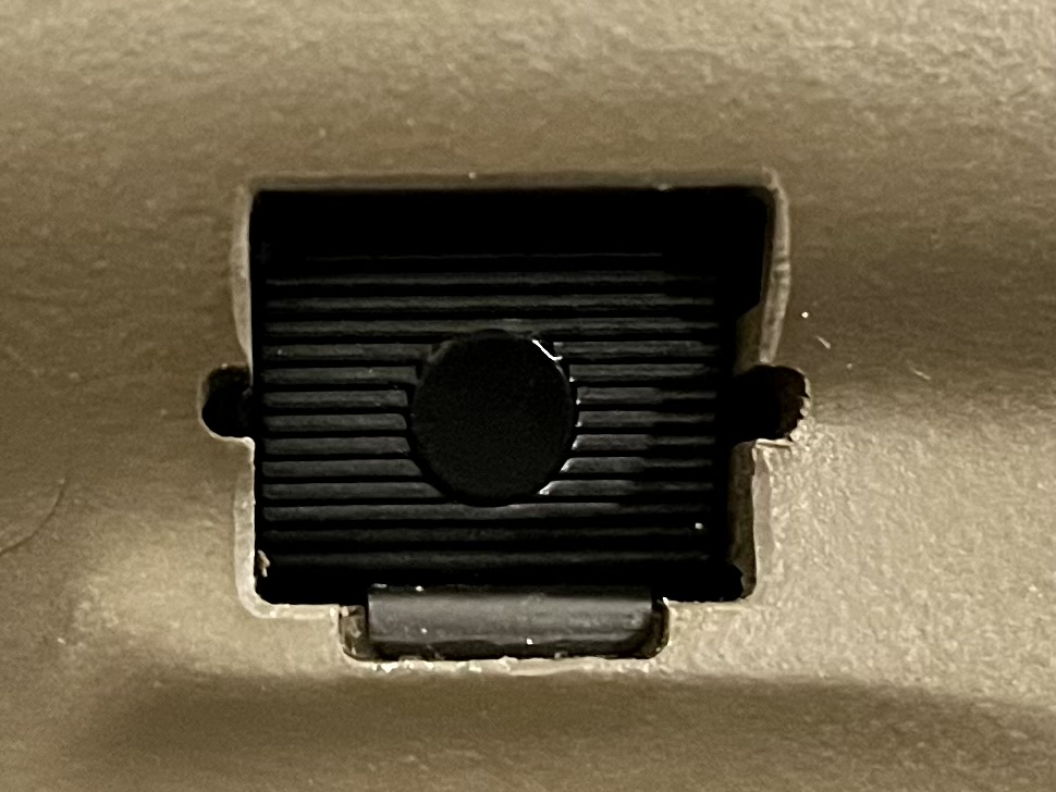

Originally Posted By Bourbonator: Got mine in October, the corners look radiused to me.. https://www.ar15.com/media/mediaFiles/348780/1000001126_jpg-3166663.JPG View Quote That’s an undercut not a radius. And I got to tell you guys… sure seems to me like stoner never heard of stress concentrations, so I wouldn’t put it past Steyr. Then again, he wasn’t an engineer was he? |

Compared my two today.
The 2017 STG-77 is a square as it comes. The mud 20 12 date code s rounded. Side by side no mistaking it. Guess I put the 16 inch mud into the weekly shooter pile now and see what happens. |
