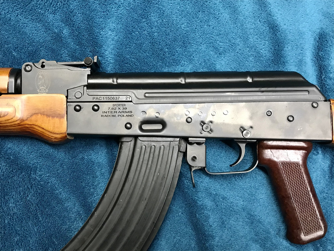

I purchased this rifle a few months ago new, and replaced the furniture with original Polish wood, and Polish grip. After this I heard that some of these were built with cast trunnions. This rifle is one of the nicest AKs that I have owned, and it shoots great. How do you tell if the trunnion is cast rather than forged? The rivets are perfect, and tight.

Which factory is it making these?  There are a couple around those parts.  It seems like FB Radom is the one thats well known and has military pedigree.  Then some other ones putting out shit and trying to ride the coat tails.  They say they're from Radom in Poland and let the buyer assume its FB Radom, when its really not.  Hopefully the "PA" at the start of the serial number is not for "Pioneer Arms".
FB Radom, good
WBP, commercial polish factory and IIRC, they supplied FB Radom with parts
Pioneer arms in Radom: dumpster fire doodoo quality.
New 2018 AK Options From Poland - PAC Sporter Rifle & Hellpup Pistol
PAC Sporter Aftermath - Feb. 2, 2018 Update & Final Thoughts

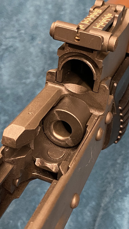

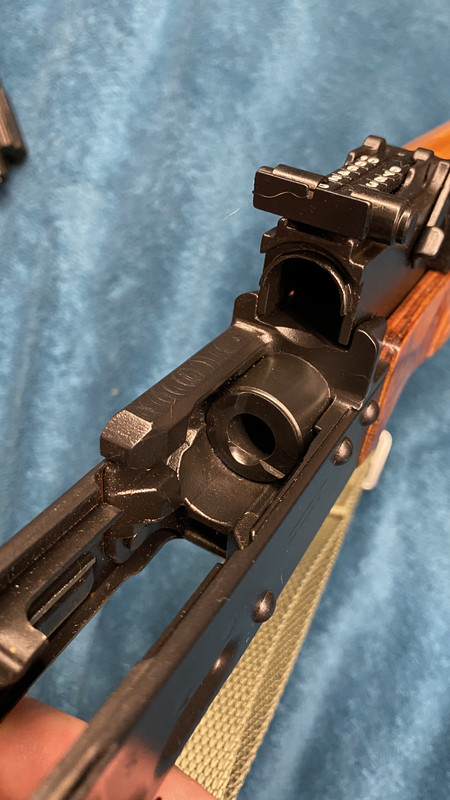

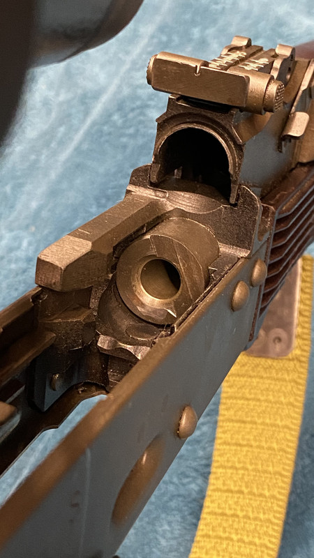

I took a few pics of the interior of all three of my AKs. The first one is the Pioneer Arms, and the others are a Century AK-74 that I have owned for nearly 15 years, and the other is a Tantal that I recently picked up.
It does look like the PA has a cast line going horizontal, but the finish is pretty smooth. I have put a out a Hundred rounds through it so far, a d everything looks fine.

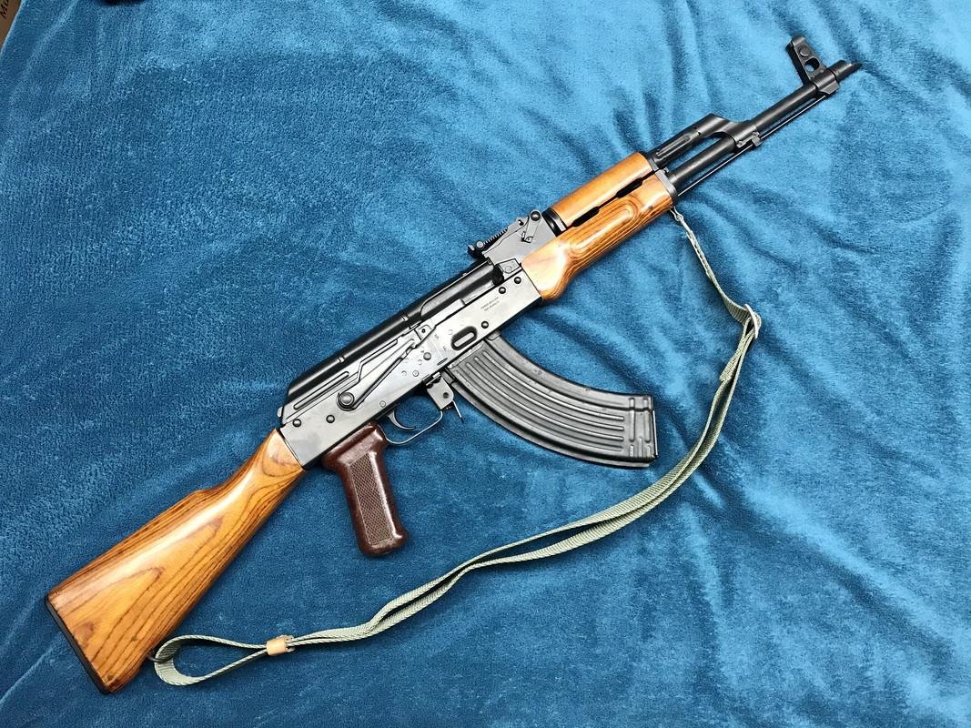

Here is a cast one I have:
