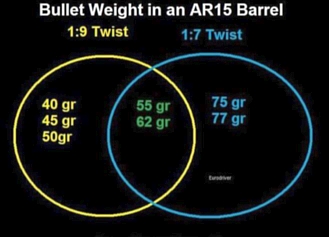

Item 1066532110 on Gun Broker.
11/15/2024 8:13:45 PM EDT
https://i.ibb.co/L62wKHC/twist.jpg
No 12 twist?!?
