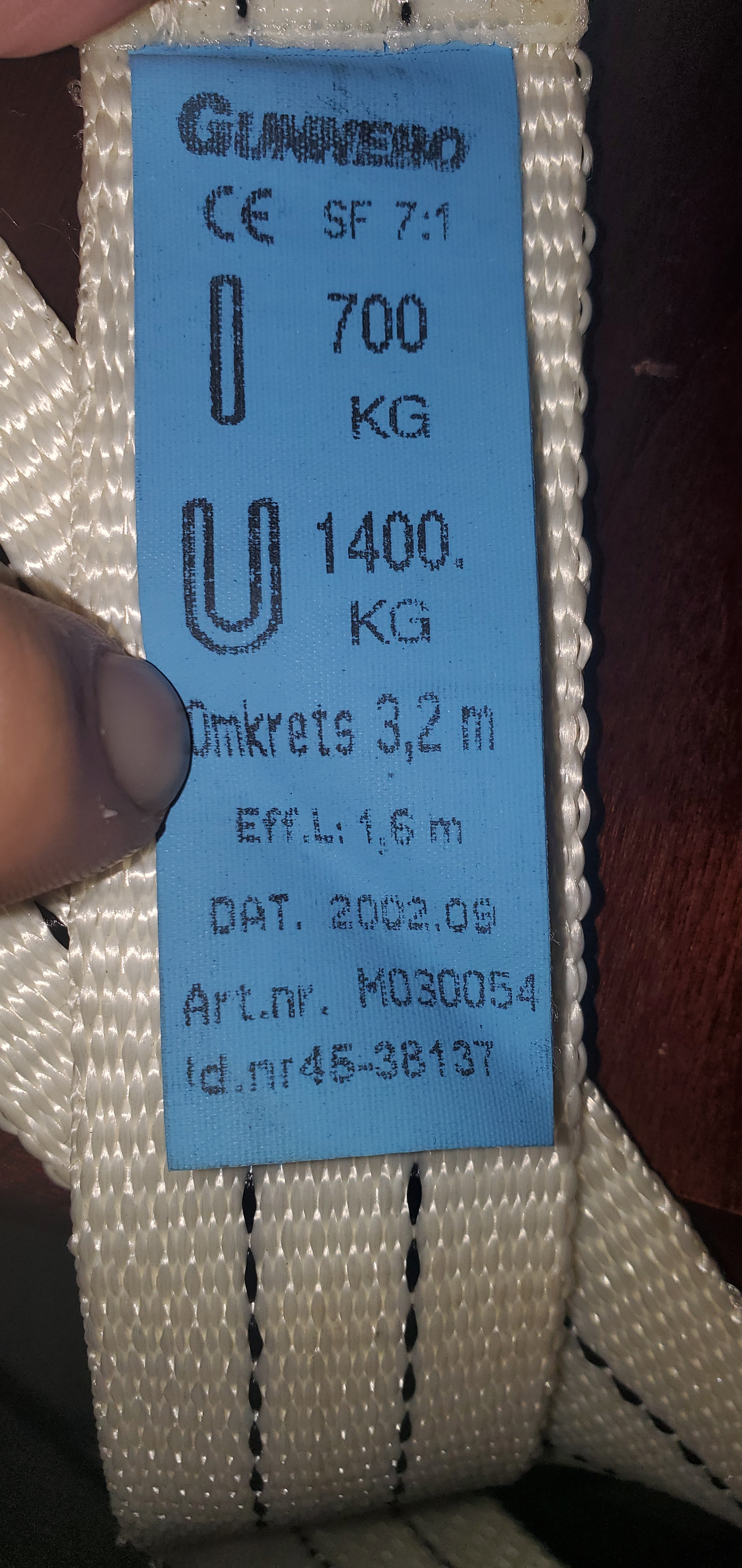

| Just wondering who makes their own slings? I had a bunch of this 1 1/4" strap laying around and decided to make a few slings. This is what i used DIY Adjustable Sling. I got the hardware from amazon first 2 i made i used the 1.5" hardware. Both worked fine. Needed more tri glide slides but this time i got the 1 1/4". Each sling uses 5 tri glide slides and 1 ladder lock slide adjuster. |

Originally Posted By Normlizer: The sling i made doesn't require any sewing or stitching . This is the strap I used. Should be strong enuff for a rifle. https://i.ibb.co/cwTYkLz/20240930-193046.jpg Appears to be a lifting strap. Did you dye it or go with the white? |

Originally Posted By 1Tribe: Appears to be a lifting strap. Did you dye it or go with the white? Originally Posted By 1Tribe: Originally Posted By Normlizer: The sling i made doesn't require any sewing or stitching . This is the strap I used. Should be strong enuff for a rifle. https://i.ibb.co/cwTYkLz/20240930-193046.jpg Appears to be a lifting strap. Did you dye it or go with the white? I dyed it black using Rit dye it turned out more grey than black maybe one day i'l dye them again using the the synthetic blend dye.
Originally Posted By Normlizer: I dyed it black using Rit dye it turned out more grey than black maybe one day i'l dye them again using the the synthetic blend dye. https://i.ibb.co/7RZgrrd/20241221-122215.jpg As far as I know, when dying anything, bringing the water up to pre-boil temps, about 180f, provides the best results. Did you heat the water first? If not, you can do I all over again. |
| Yes I boiled the water dye mix and I added a splash of vinegar and some dish soap. I used the all purpose next time I'll use the DyeMore made for synthetic fabrics like polyester, acrylic, acetate, plus blends that contain those fibers. |

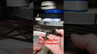

I stumbled upon this while looking for cheaper alternatives to the Q sling devils. I never would have thought of using $1.50 of tac toggles to do the job, though they are a bit larger. ![]() Tac Toggle sling attachment (better than the sling devil?) Maybe... |
