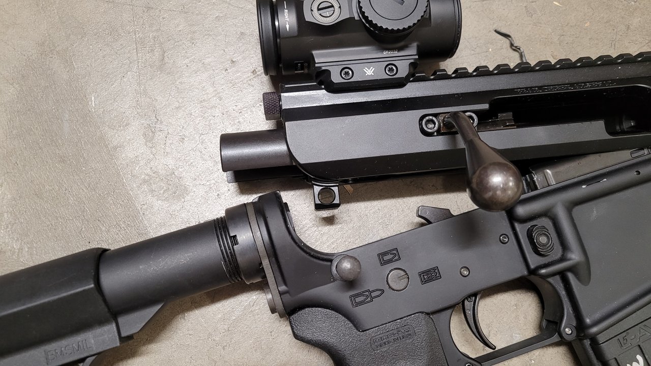

I have a home built Solo 300 (actually a 450 BM) that I made using a Bear Creek side charger that I cut the BCG off just behind the Firing Pin.
This works with a folding stock and has no problem maintaining orientation in the upper.
My guess is they’ve left the BCG longer in their “Bolt Action Style” receivers so it fills the opening in the receiver where the bolt handle slides forward/aft (highlighted in red below).  Just chop off the last couple of inches and you’re good to go.
My guess is they've left the BCG longer in their "Bolt Action Style" receivers so it fills the opening in the receiver where the bolt handle slides forward/aft (highlighted in red below).  Just chop off the last couple of inches and you're good to go.
https://www.ar15.com/media/mediaFiles/180867/IMG_6336_jpeg-3452785.JPG
Thank you!

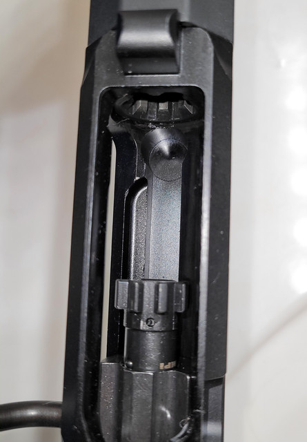

The bolt's rotational position is fixed. The cam pin channel only allows the bolt to move back and forth. The camming is manual and is performed by rotating the bolt handle. The bolt is a standard bolt without gas rings. They added a spring between the rear of the bolt and the carrier to prevent the carrier from being all the way forward without the bolt being locked. This in theory would prevent the hammer from striking the firing pin unless the bolt is locked. The firing pin, firing pin retainer, and cam pin are also all milspec.
Can't tell you how well it works yet. I slapped the sucker together but haven't had time to take it out and shoot it.
2/4/2025 8:07:19 PM EDT
Thank you very kindly for such clear and detailed pictures.  Those pictures answered a dozen questions for me.

2/6/2025 12:44:43 AM EDT
[Last Edit: ninja99][Edited] [#35]
The differences I can see are that:
1) As TNRonin mentioned, the BCA upper has a cutout for the "gas key" for when the bolt is rotated into the closed position
2) the BCA upper does not have the cutout that allows for cam pin rotation that a standard upper has
3) there is no gas tube hole and no charging handle retention cutouts
It's kinda hard to get pics of the inside of the receiver. The differences are obvious when looking at it in person but don't show as well in a 2D picture:
2/6/2025 1:00:23 AM EDT
Add me to the .300 AAC upper list. I already have an SBR lower and suppressor for it.
2/6/2025 1:10:45 AM EDT
Thanks.  The pictures were good enough for me to confirm my hypothesis.

My 2-stamper with DIY. 300 AAC upper 😎
