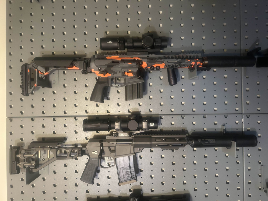

I finally got my spacers. Damn is this getting smoother.
I decided to forego the spring washers. It's debatable that they even keep screws.from loosening, and it's a steel on steel engagement to begin with.
Otherwise 3/4" screws were still too long, and  5/8 was a hair too short. Without the washers the screws were perfect imo
Curious how the spacers hold up. MJF - Nylon PA12GB - Black Vapor Smoothing looks pretty damn good to me.

[Last Edit: WyattC][Edited] [#22]
Well, we've gone past the point of putting lipstick on a pig. Lipstick on a bear I guess. Side by side with the OG for comparison.
Unfortunately I forgot to tell the cerakoter to not cerakote the insides of the upper and they laid it on THICK, this thing is sticky and stiff. Going to have to go at it with a dowel rod and some 1000 grit on the bearing surfaces and bolt handle channel I guess.
7/11/2025 12:28:42 AM EDT
Originally Posted By WyattC:
https://i.postimg.cc/TYsm048p/bca.jpg
That looks great through.  Could you show what you did to the bolt so it works without the buffer tube?  I'm almost convinced to get a 6.5 Grendel for caribou hunting.

Shot a lot of 308 subsonic today.  That was alot of fun. They are stupid accurate.  The new Ba barrel did well even though it hadn't been properly broke in.  I think itll tighten up more if it gets a few hundred full power loads.  Picked up a couple of the fired bullets off the berm and the rifling grooves on them are sharp. Anyway the 308 is damn neat.  Fits in a 28" rifle case and full power loads thump with minor recoil. Next up I need to get a scope on it that has precise enough adjustment to adjust poi from subs to supers on the fly and lessen the extractor spring pressure.
The pocket sniper is on my S### list.  300blk subs out of a short barrel suck accuracy wise.  4 barrels times 10 loads and nothing does better than 3" and that's usually the best of the day. Ive never seen anyone on the internet achieve decent accuracy with them and now I know why.  I'd try some supers but I just dont care about them in that package.  Also that strike brace is hell on the shoulder with any recoil.
Here's some pics.
I'm not here because I make sound financial decisions.
7/13/2025 7:44:36 PM EDT
I had great luck with Callaway 220gr subs out of my mini fix, 2-2.5 inch groups at 200yds with an 8in barrel. Might just be an ammunition problem.
7/13/2025 9:04:14 PM EDT
Maybe, but 4 different bullets, 3 different powders, 3 different twist rates and not a single ray of light at the end of the tunnel with this caliber.
Maybe it's the scope.
7/13/2025 10:46:43 PM EDT
I wanted to make a joke about the scope not being tightened down securely, but trying a different optic and mount is probably a smart idea.

A buddy with a battery band saw came over and we cut 3 and cleaned them up on a belt sander.  Used a cmmg and strike industries picatinny adapters.
