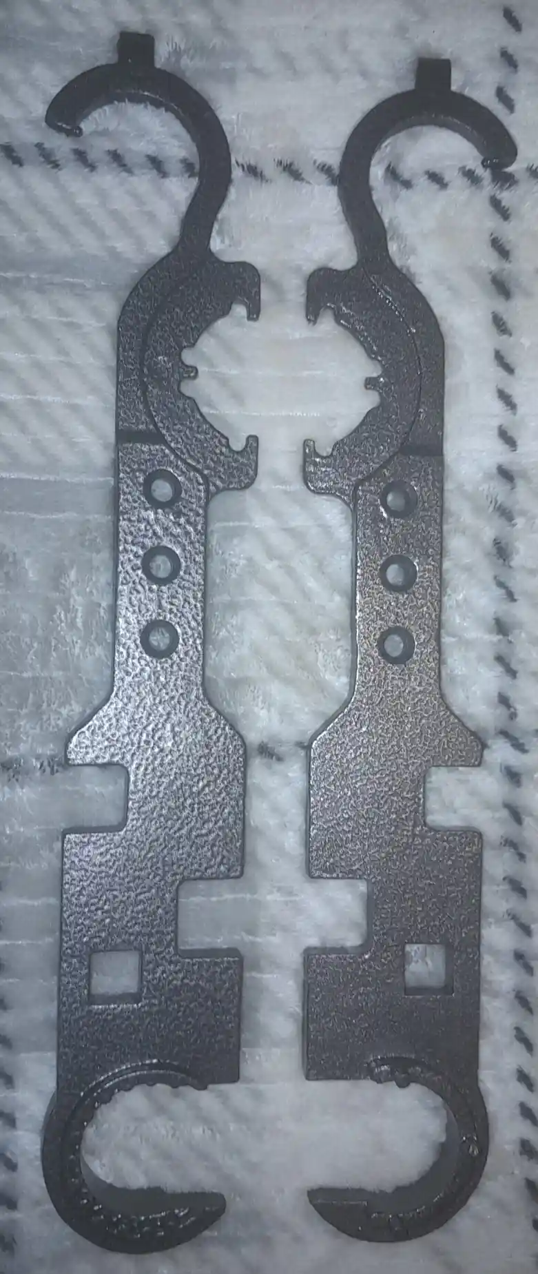

You already got a vice, punches, vice grips/pliers, hammer, few pieces of leather, wood blocks (could just get the upper/lower jigs if doing a lot) & these->
eta: good allen wrenchs, torx bits & flat/phillips head screw drivers that some gas blocks & add ons use.
