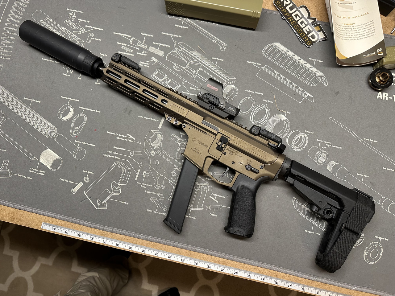

I just bought one of these AR9s, 8", 9mm, that I intend to run suppressed 100% of the time with a Rugged Sub9 can. What is the best buffer setup for this configuration? CMMG sells a tuning kit that comes with different weights that are installed into the BGC itself, but I don't really understand the advantage of this compared to a heavier buffer and/or spring. I also see a few companies selling hydraulic buffers designed specifically for this gun's radial delayed blowback system. If I were to go the hydraulic buffer route, would the CMMG tuning kit still be needed, and what buffer spring would be best? |

| Unrelated, but I picked this up yesterday, and discovered that the fixed ejector will need to be temporarily removed in order to use a BEV Block or reaction rod to swap muzzle devices. Anybody know the recommended torque spec for the screws? I assume blue loctite is recomended? |
This gun is running pretty smoothly and reliably suppressed with a Rugged Sub9, KynSHOT RB5000HP buffer and Tubb flat spring. However, I am getting a ton of shit coming out of the ejection port. It's so bad that my buddy who shoots left-handed can hardly shoot it. It feels like getting sandblasted with unburnt powder. Is this to be expected? I thought that this radial delayed blowback system was supposed to be suppressor friendly. Not my experience at all so far. @amphian: would your "A5 recoil system" potentially help mitigate this ejection port gas issue? |
