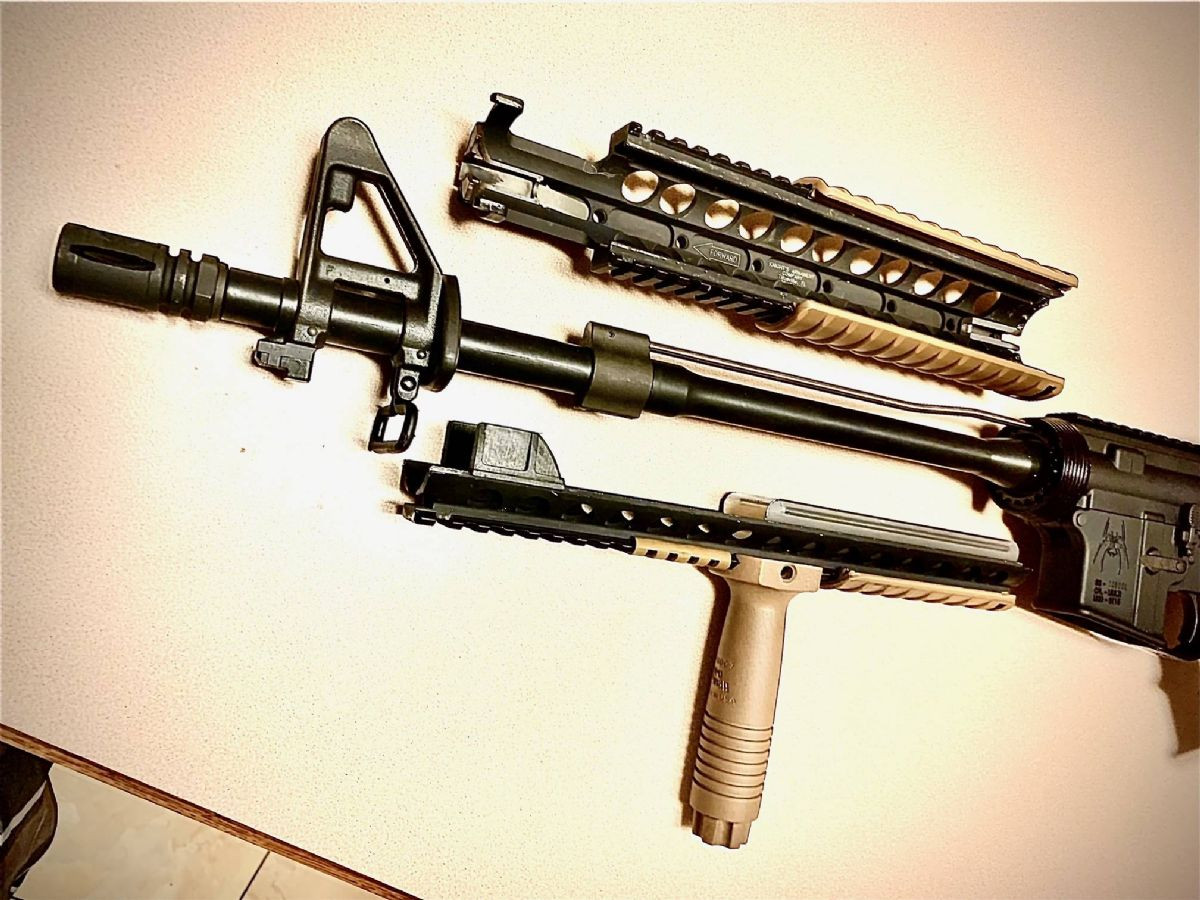

How hard would this be? Looks like it is a faux dissipator….  knock the pins out and remove the front site  and install a free floating hand guard?????

That's what I did. Lowpro gas block. But my lazy ass never even bought buis for it. I just have my nikon 3x9 on it.
5/27/2026 7:13:21 AM EDT
Depends on how tight the barrel nut is and the roll pins on the fsb lol.
Did this exact thing on a cheap upper and had a hell of a time getting both off. Barrel nut tight as shit and fsb pins took a fooking beating to get out.
Other than that, its a simple job. Just pick out a rail and gas block.
They're taper pins, and a Brownell's Bench Block is incredibly useful as well as a bigger hammer.
If it's a dissipator it should already have a cut down front sight base at the carbine or mid-length position. Right? Isn't that exactly what makes it a dissipator?
(edit: Evidently some of them have rifle-length gas systems. That's a pretty critical distinction.)

I’ve never seen one with a low-profile gas block but I’ve never seen one in person. The ones I recall were A2 FSBs chopped. I guess if you want a 15” hand guard you won’t much see the pin holes, but I wouldn’t bother with any of this.
So if wanting an M4 style it’s never going to work.

I’ve messed with an fsb once before, it was a difficult one. I’d just get a new upper.

As posted already by Thefryzone, they appear to be mid gas with a LPGB and a taper pinned A frame sight tower at length in order to run clamshell handguards.
