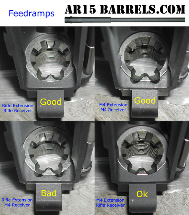

I have several A2 service rifles I want to convert to flat tops, the problem is they have rifle barrel extensions.
I suppose I could have a pro modify the current rifle extensions to m4 specs.
I could have someone that is well stocked with m4 barrel extensions play with their inventory until one works and headspaces properly.
What does the community think?

The rifle barrel extension has a hard stop that the M4 ramps force bullets into. Rifle barrel extensions have to be used in uppers that don't have the M4 ramps, there is no getting around it.
Hand grinding the rifle barrel extension so that it mates with M4 ramps is one option. That's the option I am least interested in.

Shooting full auto has nothing to do with the problems created by using a rifle barrel extension in a M4 ramped upper.
If the bullet jams in a rifle/M4 situation, how would it also not jam in a rifle/rifle situation? Either the tip rides up the extension's ramp or jams the nose into the receiver.
Originally Posted By HighpowerRifleBrony:
Huh?
Think you are misunderstanding things.  M4 receiver ramps paired with a rifle barrel extension means the bullet tip wedges itself into the gap between the receiver and barrel extension- no good.  Rifle extension extends out further than the top of the M4 receiver ramp.
Rifle receiver (no ramp at all) paired with rifle barrel extension is how millions of M16’s and AR’s have been made.  It was literally designed that way.  There is no gap like in the first example.
Rifle receiver paired with an M4 barrel extension on the other hand will work OK, just not ideal, especially for F/A fire in short M4 length barrels.  Plenty of early AR’s with shorter barrels have rifle receivers and rifle style barrel extensions, it wasn’t until the M4 model actually came about that it was decided the M4 receiver ramp was needed to help improve feeding.

You're correct that the "bad" configuration can work if the round is oriented to feed from the magazine onto the barrel extension's feed ramp.  But it also has a higher potential for failure.  Use a different magazine or ammo that changes the orientation and now it doesn't work.
The same can be true using rifle or M4 feed ramps with a non-feed ramp upper if the tip of the round hits low enough on the upper to completely miss the feed ramps.  This is not particularly common but can occur when using rounds with a longer OAL.  It's the primary reason M4 feed ramps were developed to accommodate the OAL of M855.
However, if the round hits closer to the transition point between the upper and barrel extension, the tip of the round can still deflect onto the feed ramps.  Not ideal but it's better than the "bad" set-up, which creates a ledge that effectively captures the tip of the round and prevents feeding entirely.
All this to say, the "bad" set up has the smallest margin for error when it comes to orientation of the round from the magazine to the feed ramps.  Sure it can work, but there is no reason to build a potential point of failure into your rifle and hope for the best.

With good magazines, how does the bullet tip jam?
https://www.ar15.com/media/mediaFiles/379478/Feedramps_jpg-3655193.JPG
I agree with you that all 4 configurations will work if the feed angle is correct.  My only point of contention is that the rifle extension paired with m4 feed ramps offers the smallest margin for error.  To me, it doesn't make sense to choose the configuration that has the highest potential for failure compared to all of the available alternatives.
It would be interesting to see through extensive testing how reliable that config can be.  I suspect it would be more sensitive to a wider selection of magazines, cartridges with a greater OAL, guns with a faster cycle rate and adverse conditions (or any various combinations of the above).
I also suspect it would do fine with M193 from pmags when its 70 degrees and sunny outside.  It just depends on your specific performance criteria.
