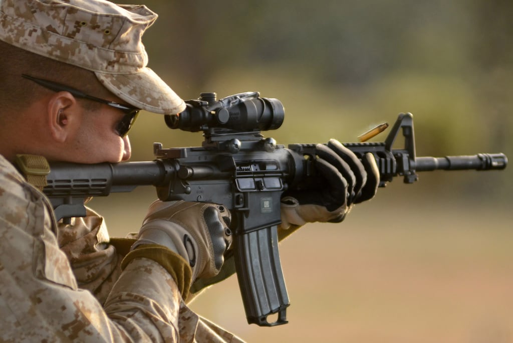

Hi all, I just picked up a 16" psa carbine m-4 style upper for my magpul edition psa lower, both were on sale last weekend. It does not have a rear iron sight but it does have the A2 front post ![]() I wonder what a good rear iron sight costs these days? I'm having trouble even finding one to look at FYI ![]() I also have a Crimson Trace CTS-1525 that I picked up on discount a while back, I wonder is there any way to mount it on my upper with that front post up there? I also have a number of old deer rifle hunting scopes 3-9×40 nothing to write home about. Any advice on good inexpensive ways to mount those to my setup? Thanks, I haven't been into guns in a while so it's like I'm out of practice here. lol |
Using what you have will be kinda sub optimal because of that fsp, but Arisaka makes an offset mount for your red dot, and Warne has a mount that should work well with an old 1" deer scope. Although my recomendation is to just buy a romeo5 magnifier combo if you are on a modest budget. If you just want to get functional with an Iron sight on the cheap, here is a good buy on a KAC. |
I like having a Red Dot Sight with a fold down rear sight on my AR-15’s with fixed front sight. You can use the pistol size red dot you already have if you can get a Picatinney adapter then use a riser. The pistol red dot sight probably wouldn’t be as durable as a larger Red Dot sight normal seen on AR-15 carbines. I have used 3-9x40 optics with an AR-15 style mount and even on three power you rarely see the front sight in the scope tube. If there is a shadow of the front sight visible in the scope tube I never found it distracting. About any 1” or 30 mm cantilever AR-15 mount will work on your AR-15. If you use a quick release mount the back up fold down rear sight might fit under the ocular lens of your scope. Here is a link to different AR-15 rear sights. https://www.amazon.com/s?k=AR-15+folding+rear+sight&crid=HO2HEZPLEEVP&sprefix=ar-15+folding+rear+sight%2Caps%2C227&ref=nb_sb_noss Here is a picture of my 16” AR-15 in 6.5 Grendel with a scope in a cantilever mount with a fold down rear back up sight. I am using a front sight mount with a rail to attach a Meprolight Poly Tac light in a 1” scope ring mount. This makes for a versatile carbine without spending a lot of money. ![]() |
