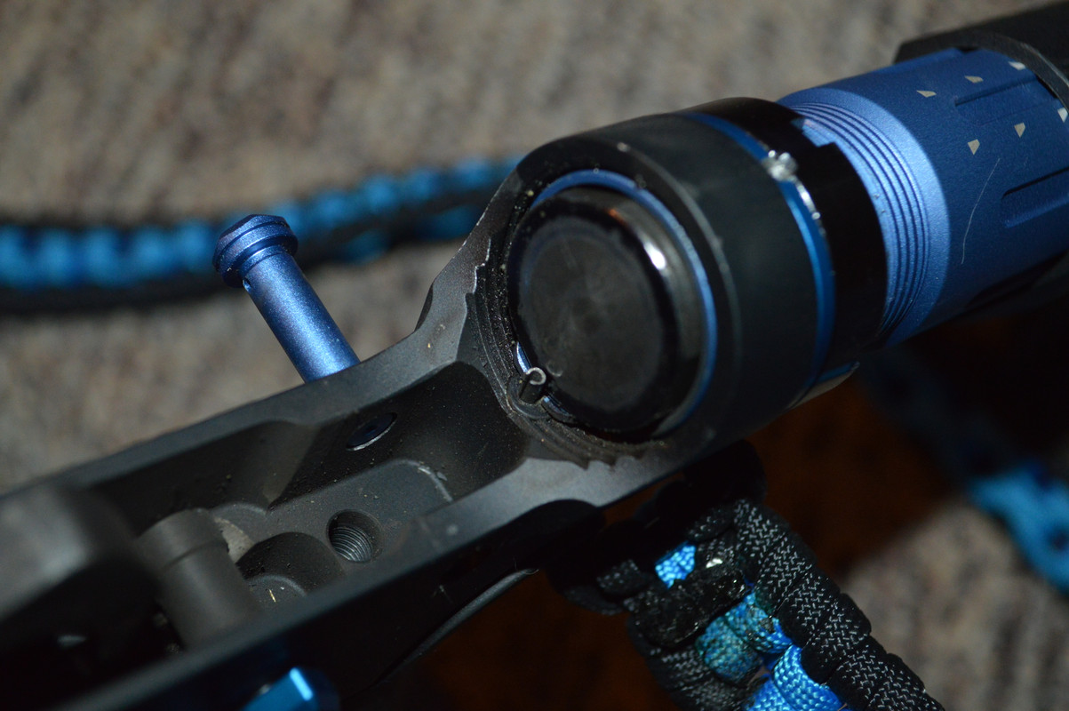

| I think you may have figured out the answer to your questions already. The retainer hole in the lower is supposed to have a 6 degree lean towards the front so a slight lean in the pin is normal but of course the denting on the outside buffer edge and any bend in the pin is not. |

| Might be max distance something like 6.940" center of retainer hole at top to the center of front pivot pin hole "vertical center line up from pivot hole to same height as top of the retainer hole to get a straight horizontal line measurement ". |
![]() Problem is right here, with not enough of barrel extension protrusion back into the upper receiver void. If could be that the barrel extension from seating lip on it stop collar for upper receiver barrel socket, to back face of chamber section is too short. Or it could be that upper receiver barrel extension socket front lip is too long off inside back wall of upper receiver is too long , and barrel socket front surfaces needs to be squared and set back instead. Or as stated, could be barrel nut is coming lose,and this is allowing the barrel extension seating lip surface to gap to front of barrel extension face instead. Simply, when looking in from the side of the ejection port, the back of receiver extension face should be very close to the front of the ejection port window edge, which is not in this case in the above photo. As for lower receiver, below is a link to download drawings, to see if buffer retaining pin is drilled in the correct location on the lower receiver. https://cdn.shopify.com/s/files/1/1067/2310/files/AR15_Lower_receiver_blueprint.pdf?3587052860788957110 Simply, time for the upper to be broken down to check/remove barrel nut, make sure there is no derbies/barrel extension seated all the tight against the front of the upper receiver barrel socket, and it is, then front of upper receiver barrel socket needs to be lathe faced back to get correct protrusion of back face of chamber of barrel, to the it correct position in the upper receiver to semi bring the built upper back into spec. ![]() ![]() Note, if the idea is to play dress up on the upper with different barrels over time, then maybe better to face the barrel extension seating surface towards muzzle, to semi bring the upper into spec/ the protrusion of the barrel extension chamber face inside the upper receiver void to to correct dimension of the needed slight protrude. Hence the single piece bolt striking the back of barrel face is normal (steel against steel), but if the protrusion of the face of barrel is not back enough off the front inside wall of the upper receiver, then bolt can start to peen the aluminum wall of the upper, to cause all kinds of problems. ![]() So in the above photo, notice how the back face of barrel extension is recessed in from inside surface of upper receiver back wall, and it should be the other way, with face of barrel every so sightly proud past that wall instead. --------------------------- As for buffer, and maybe even back of single piece bolt, not seeing any burs on the back of the bolt that is causing any problems to the buffer face, so buffer just needs to be checked up lathe to clean up the peen marks, and do a slightly edge chamfer of it in the end. Then at that point, it back to checking the actual stroke of the rig, but doing a full charging handle pull, and make sure that the face of the bolt only retracts past the bolt catch by 1/8~1/4", and that the last of charging handle pull the same in tension from middle of pull, to last of pull. If the bolt is allowed to come back past the bolt catch more then this, then will just be a matter of time before the bolt catch is broken. If bolt comes back past catch slightly more then this the above, then you can pull the buffer and spring, drop a quarter or two down the buffer tube as end of stroke spacers, to limit how far the buffer/bolt can retract in the tube. If way more than this, and the bolt is retracting back past the back of ejection port window, then time to get a buffer spacer the needed thickness, to use in the end of the buffer tube instead. ![]() |

Originally Posted By Dano523: Its not, since you can see that the back chamber face of the barrel extension is recessed, not slightly proud of the back wall face of barrel socket of the upper receiver. https://i.postimg.cc/g0cD9XRf/DSC-0090.jpg Myself, would be the first that gets resolved, before single piece bolt starts to peen the hell out of the upper receiver aluminize face wall to start with (hence have lathe and not afraid to use it). With that resolves, may not need to go to off set buffer retaining pin, but as soft as the metal of the buffer appears to be, would still go with off set buffer pin, even with the back of receiver extension spacer'd correctly so bolt is not breaking bolt catch next. I bring the later up, since run 9mm major through the 9mm sub guns full time, and in regards to 45 carbine rigs, lets just say the same +P ammo that is used in my defense rigs as well. Note, the 45apc has a much lower working pressure than 9mm, even when both pushed to +p/major level, so really talking about a 124gr bullet in the major ammo that is pushing 2K fps in say a 14.5", verses the 230gr than is no where close to that speed with way more drop at yardage, so really comes down to the 45acp only being better if going to load to sub sonic speeds with suppressor in play instead. Also to add, on a blow back action sub guns with the hotter ammo at +p levels, need to run a heaver buffers (and in some cases stronger recoils springs as well), to control the stroke with that hotter ammo in the first place. So don't run such in rig, if rig is only set up to run standard ammo. The location of a reduction means nothing. The full smaller bore is allowed the full length if a maker chose too and even if they went to the allowed larger bore the reduced bore is required past the max barrel extension length at least .145" up to any point they chose. What you are visually pointing out is meaningless only actual measurements matter. |
GREAT INFO GUYS! thanks alot. i appreciate all the insite given. and j3_ thank you for sharing. this has given me way more to go off than Pro2A has done. with the lower blue print measurements i found the detent hole is located .019" rearward. maybe with the combination of the upper's barrel extension and the detent location, these may be my issue. my offset detent should be here anyday, and off for another range test. p.s. speaking about ammo. I'm using 193gr reloads at sub speeds with a can. no +p's here. it has a 8oz buffer and spits cases out @ 2-2:30 without the can on. planning on upping the buffer weight soon. |
Originally Posted By thindude: GREAT INFO GUYS! thanks alot. i appreciate all the insite given. and j3_ thank you for sharing. this has given me way more to go off than Pro2A has done. with the lower blue print measurements i found the detent hole is located .019" rearward. maybe with the combination of the upper's barrel extension and the detent location, these may be my issue. my offset detent should be here anyday, and off for another range test. p.s. speaking about ammo. I'm using 193gr reloads at sub speeds with a can. no +p's here. it has a 8oz buffer and spits cases out @ 2-2:30 without the can on. planning on upping the buffer weight soon. Just a fyi, but before you change out the buffer, drive out the buffer bumper roll pin, and see if there is any internal dead blow weights inside the buffer. Hence on the first full auto ar-15 rifle, the rifles did not come with a dead blow effect type buffer (just a plastic limiter piece of nylon to stop the bolt is the correct position behind the bolt catch), meaning no internal weights that would allow the back of stroke of the buffer to have a stall time, before it would allow the bolt to start moving forward, so ejection path on the first rifles was forward, not the 5:30 of the later A1+ rifles. Hence that the dead blow effect of the buffer was really to slow the auto fire rate of the rifle in the first place, with change is ejection path to now rear'ish was just coincidence of the dead blow effect to slow down the cycle rate, and Goverement had to issue snap on defectors for left hand shooter on these first rigs pre A1 rigs, so anyone shooting the rifle left handed would not get spent brass back in the face; until the updated A-2 receivers came out with defectors on the upper receivers. ![]() I bring this up, since a quick search of the ar45 buffers, shows most of them solid, without internal dead blow weights, and even a heavy buffer if the same design solid, is still going to end up with spent case throw forward, since buffer will not have any internal buffer weights to allow the rear of stoke stall, and where the spent case are ejected off the bolt face to that 5:30 postion. https://jtactical.com/products/45-buffer-and-spring The second one, is that if the buffer does have internal weights, on a blow back action, the weights need to be spring loaded/kept forward in their cavity, to keep the weight forward in the buffer, to keep bolt forward as long as possible as well. Hence floating weight in buffer for a DI type action, rig aimed upwards, has the weights back in the buffer cavity , and until the buffer moves enough to get the weights forward again to help slow the bolt moving rearward at that point, you can have the case side walls expose enough out of the chamber walls at intial ingnitionto have a case blow out if the case walls have been thinned with enough reloading of the case. Or enough budging of the case just above the rim webbing over and over again, that with enough reloads on the cases, the case rim/lower web section just end up with head separation instead . ![]() So since the rig is cycling now fine, it may not be a heaver buffer that is needed to get the case to eject rearward, but one that does have dead blow effect weight if your buffer is solid now, and again since a blow back action, then something like the MGW reduced rate buffer (about 10oz) that does have the internal weights spring loaded forward. Another option, maybe be a hydraulic buffer, since again, will create the back of stroke stall of the bolt so spent case can be ejected to the 5:30 position off the rearward stalled bolt face at ejection, and full internal weight of the buffer is forward at all times to keep bolt on barrel face as long as possible before it starts moving rearward. ![]() https://c3junkie.com/?page_id=325 And to point out, since most of the blow back bolts now have ramped bolts, the hammer down against the back of the bolt, offers a lot less help of holding the bolt forward via the hammer on the back of the bolt during ignition, then the old Colt type flat back none ramped bolts isntead. None ramped bolt, ![]() Ramped bolt, ![]() |

i received my offset pin, wasn't happy with it. it seemed the offset pin was too thick to fit in the buffer tube slot properly, when i left it stick out of the slot it had enough room to rotate and possibly make contact with the bolt when cycling. so i took the original retainer pin "the bent one" cut it off flush, drilled a offset hole and installed a harden roll pin. https://i.postimg.cc/3RkjXdJj/DSC-0134.jpg i smoothed up the buffer edges, colored it with a black sharpy marker and fired off approx. 75 rounds = no issues / no more contact. however, i've been noticing the ejected cases look like this, they all have flat spots https://i.postimg.cc/8CtfnDny/DSC-0126.jpg when the bolt cycles back, the shell hits the ejector tab and the shell turns out the ejection port and slams hard against the outter part of the receiver causing the case to flatten. it's leaving a brass discoloration on the rear of the ejection port. is this common? i've ran the cases through the reloader, they've all straighten out fine, took bullets and re-crimped nicely. but i'm guessing the case mouth will split eventually. |

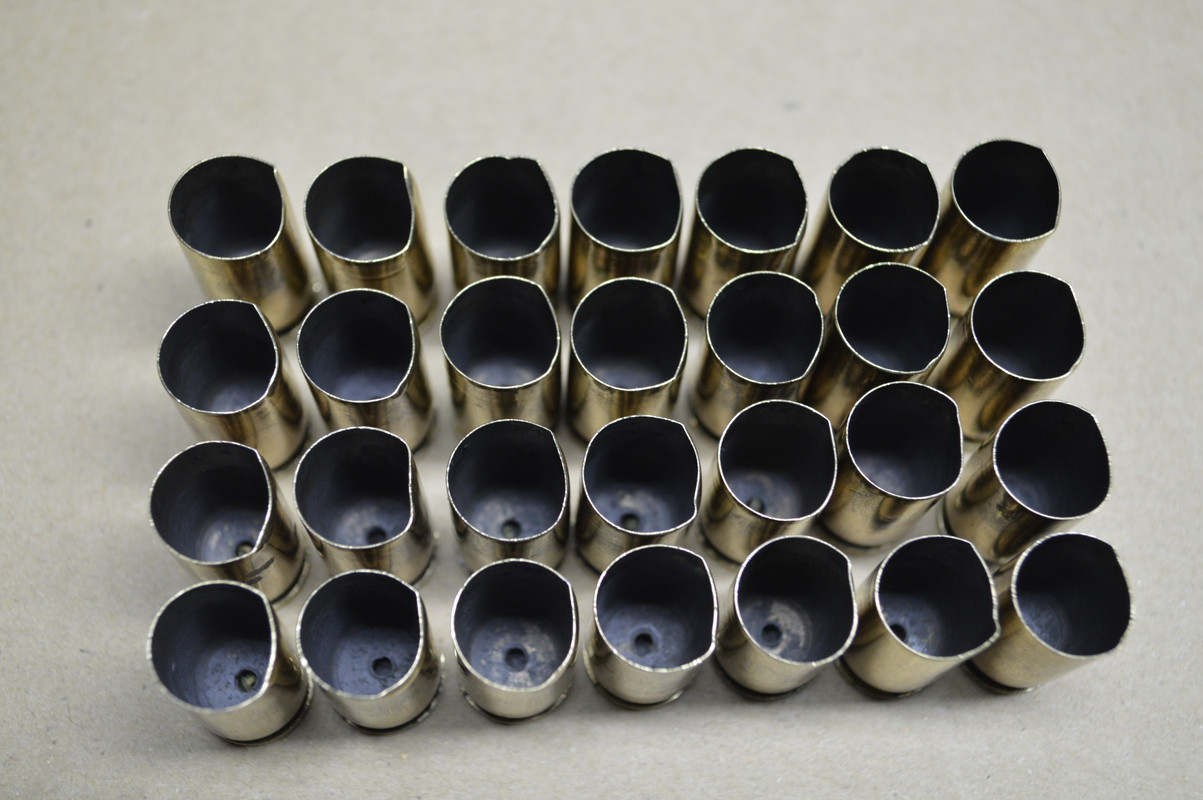

heres a pic, the ejector is square cut / no beveling or angles. appears to fit up pretty nice - no big gaps like your sample picture? the ejection pattern is all over the place, between 2 through 5 o'clock, it spits brass every where. https://i.postimg.cc/Rh9rdmBg/EJECTION-PORT.jpg |
