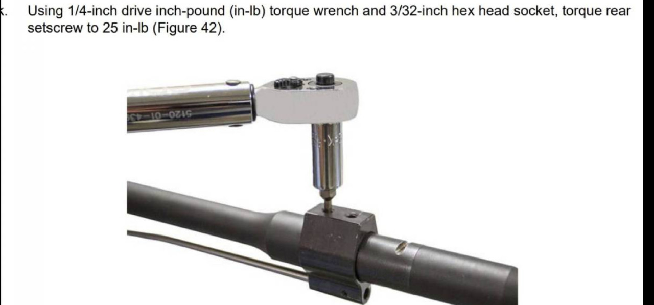

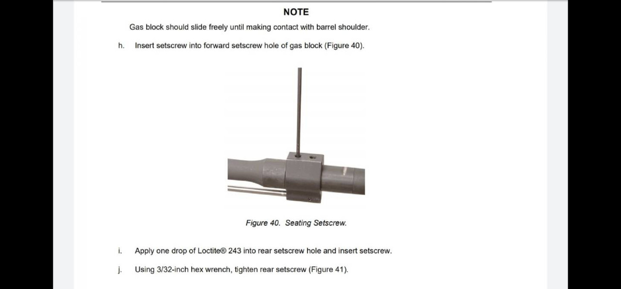

| new build has an adjustable(Superlative Arms) gas block. This is the first non pinned GB I have and wonder what I should do to keep things where they are supposed to be. Should I use red lok tite or rockset for the set screws? The barrel is dimpled for them. I was also thinking about trying to stake the screws . |
Gas blocks tend to get hot so I'd recommend rockset. I'd also be tempted to bed the gas block with rockset, i.e. put a thin coat of rockset on the journal before sliding on the gas block. I've never done this before, and I've never had one come loose, but if I wanted to be absolutely sure I'd consider it. |
I know I'll never go home.
Originally Posted By TGWLDR: Loctite 243 and proper torque. I use knurled set screws personally. +1 This plus a dimple does the job very well. I've never had a gas block come loose with this process. In fact I have had two gas blocks installed with this method that filled my cuss jar when I tried to remove them to swap handguards. If 243 and the proper screws can cause me to swear like a sailor when I am intentionally trying to remove them, then they sure aren't going anywhere by accident. |
Thanks guys. I used Red Lok tite and torqued to 25in/lbs. All I have at home is the Red, Purple and some Vibra Tite plus some Hot Lock. I don't plan on needing to remove the gas block anytime soon and I guess if I need to and can't get the screws out I'll just cut it off, wouldn't be the first time I've had to cut a gas block off. Any benefit to making a small stake on each screw or will that just mess thing up? ETA. saw the comment above on staking |
I use rocksett. Higher temp resistance than red and blue. Won't cook off. To remove drip water onto screws and hit with a small amount of heat. Heat doesnt do anything to the rocksett but it can help migrate the water to the threads. Never had an issue removing screws with rocksett. |
