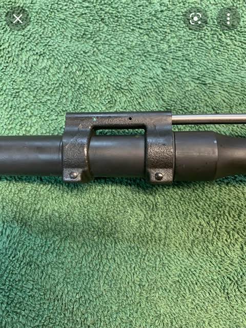

Shaving the front sight tower would be the the easiest course of action.
But yes, swapping to a low profile gas block is pretty straightforward. Hammer the pins out, remove the front sight tower, and replace with gas block of your choice.
Set screw options, when installed correctly , work fine.
Everybody has their pet brands. SLR, Daniel Defense,  and Yankee Hill Machine are my preferred.
3/22/2026 6:18:00 PM EDT
https://i.postimg.cc/rsfC5yRq/images.jpg
FPNI.
3/22/2026 7:12:19 PM EDT
+1 for shaving existing block.  I cut off the sight tower with a hacksaw and cleaned it up with a Dremel and stove paint.
I've also used set screw blocks.  A dimple can be drilled in the barrel to help lock in the set screw position.
3/22/2026 7:23:18 PM EDT
You know I thought about that. But it thought it would be the ‘hack’ way to do it. That said - the one in your picture is done quite well. Very nice.
Thanks.

Many do, and have done, the same mod. It works very well, retains the double taper pin retainer method, no added cost, and minimally time consuming.  I wouldn't consider it a "hack" approach personally.
3/23/2026 10:00:58 AM EDT
Even if it comes out looking bad it'll be covered with the handguard.
I trust the taper pins more than set screws.
One more vote for; "chop it."

Another vote for just cutting the existing sight base down. It's free to do and if your covering it up with the rail you'll never notice the difference.

I vote for chopping it off. Nothing more sturdy than taper pins short of welding it on

4/6/2026 6:59:22 AM EDT
This, I have one 14.5" with a low profile pinned flash hider so I can drive the pins out and swap the barrel nut if needed for a new rail.
Its the most solid gas block you can have, and would be the absolute last rifle I would ever part with.
Otherwise you could chop or keep the front site and use a Centurion or Midwest Industries two-piece free-float rail.
