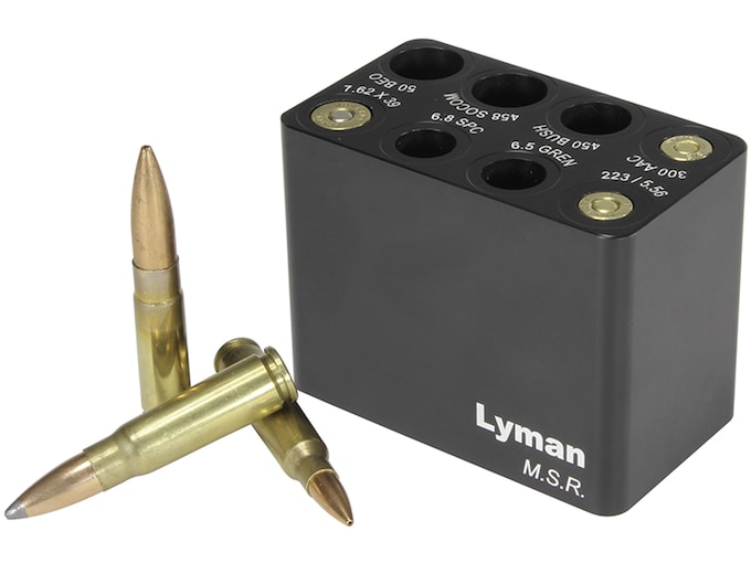

This goes out to anyone that reloads .223 or 5.56.....
Go buy a case gauge tool for ALL calibers you reload.
It's a SAAMI chamber block tool you drop the cartridge into.
It goes in easy and the end sits flush.....it's good.
If it gets stuck and sits outside the end of the tool....resize and check again.
They are fairly cheap, and come in a variety of styles and calibers.
Example.....
