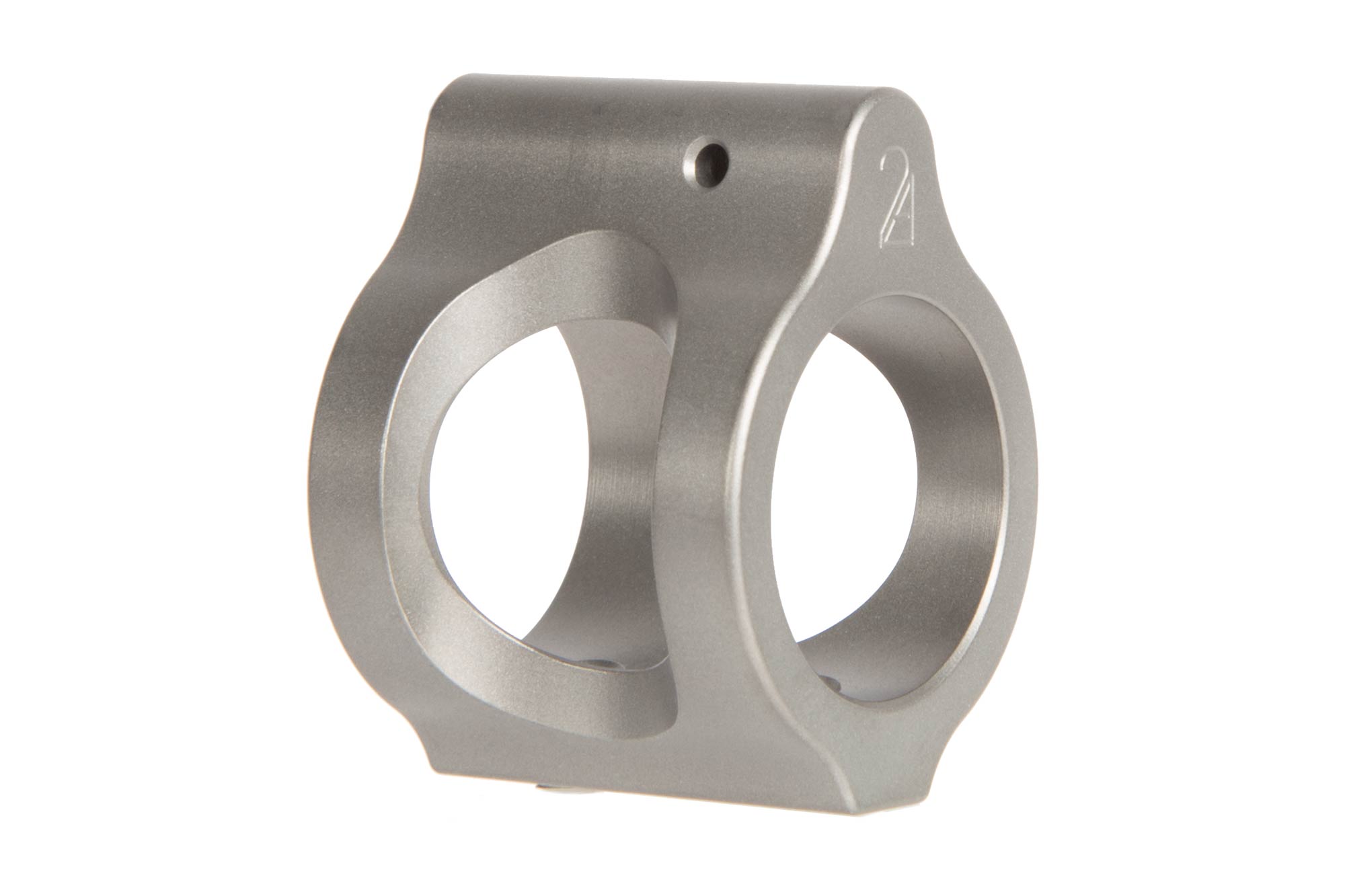

damn, that is still hella light. Unless someone started customizing the gas block journal (does it really need to be full diameter for it's full length?) or something along those lines that's about as light as you could get. Very nice.
I've wondered how feasible it would be with a gas block like this...
To leave the material that is contacted by the GB, but to machine out / reduce the amount of material on the journal where the GB isn't. Obviously the bbl would be married to the particular GB at that point, but bbls are a consumable item anyway, right? Definitely not practical for joe six pack for custom 1 off cost reasons, but for a joe sick pack that happened to be a machinist...
Own AR parts and a scale? Support the arfcom parts weights database. Please! http://www.ar15.com/forums/t_3_118/707652_AR-Parts-Weights-Database.html
4/10/2017 4:01:26 PM EDT
If you wanted to get crazy, once you pinned your gas block position, you could eliminate the shoulder for it.
You could also reduce barrel in front of the gas block to the minor diameter of the threads, I would imagine.
alternatively, for the gas block shoulder, if you really wanted some kind of shoulder, you could always keep a couple of picatinny-width sections of it at 12 & 6 o clock and machine off the rest. On the muzzle, if you sacrificed the ability to use a muzzle device, getting rid of the required 'shoulder' would certain dump some weight...
