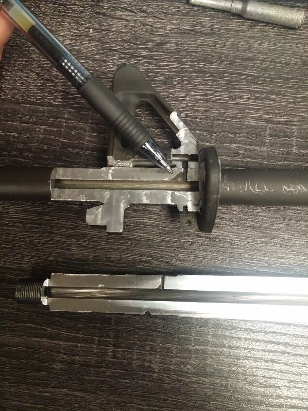

Is there some kind of fluid dynamics reason that the port erosion only happens on one side?

Some most likely, but it's probably more due to the friction of the bullet travelling down the barrel and hitting that front edge of the port and wearing on it.  Once the opening gets more asymmetric from that, then the gas turbulence plus the tiny particles of brass, copper, and lead in there could cause that deeper errosion.

The two high wear spots on the barrels are the throat and the gas port. The throat is where the bullet just starts catching on the track of the rifling. That particular area will eventually turn into alligator bed. The gas port will erode towards the muzzle so you'll eventually see a huge dent into the gas port as the barrel wears.
Those black streaks you see is carbon build up. You can probably knock most of it off simply by using a quality bore cleaner like Hoppes or similar.
As I said in the other thread you made, I think sorry if not, but barrels are wear items. You should have a spare barrel and bolt/complete bcg on hand. Of course this doesn't mean the barrel needs to be swapped as it has many more 1000s of rounds.
