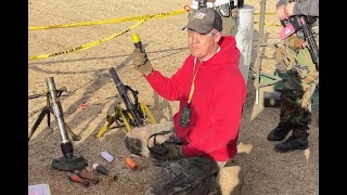

Shot a little at an event this weekend. My Italian round was going down the tube really slow. Had 2 misfires at 60°
One thing that I found interesting was that my 3d printed round (~3lb) went almost the same distance as the Italian round (~6lb).  My theory is that the extra windage in the 3D round leads to lower pressure and is balanced out between the two.

We're you cleaning/swabbing the tube it between a firing group?
Also, any plastic residue in the barrel that could have slowed down the Italian round?
10/6/2024 8:14:48 PM EDT
[Last Edit: MHIDPA][Edited] [#24]
The very first round was slow. After the first misfire I swabbed the tube with a wadded up tshirt (I wasn't really expecting to shoot, so I didn't bring my brush.) the round was a little dirty but I wiped it down.  It fired (barely) at 65°
ETA, it seemed to be a crowd pleaser.

I'm Chevtec Group on YouTube. Make sure you check the "shorts" on my channel
Here is a video my buddy did of us shooting mortars over the weekend. I'll post some more info on how my printed rounds held up. We abused them pretty good and even got direct hits on a truck. I had my 60mm and my buddy had his 81, 50, and 45mm mortars. He has used a couple of the 50mm of my design with good results as well. Consensus is that the fins need a little beefing up, but the printed fins should pretty much be expected to need replacing after 3-6 shots depending on what you are hitting. The printed bodies showed no damage and neither did the metal stem of the fins.
More info coming. I may start a separate thread
