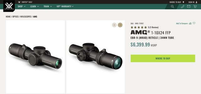

Was going to build this KS-3 out like the GrarandThumb UK contract video and then shit my pants.
Need to find a Tasco or something.
6/15/2026 10:08:57 PM EDT
https://i.ibb.co/5XR9TH0m/IMG-8489.jpg
Nightforce NX8 1-8 with fcdmx reticle and capped turrets.

My man, if you throw a Tasco on there, I will personally come and find you... and buy you a beer.
I like your style. I wish I still had pictures of my EMC with a $300 (after rebate) Bushnell Forge on it. That really got folks going.

That scope is for the KS1 which is basically what the Brits got.  FYI if you so want it you can find them around $4K but a NF 1-6/8 or something similar will work. Or you could put a T-2 on it with a magnifier. Your choice.

Those can be had for 3.6k. I absolutely love mine, and I've used everything except for the S&B stuff, mainly because it's annoyingly huge.

[Last Edit: ErikTaylor][Edited] [#46]
How do you like the AMG on the KS3? I have one on my KS1 but currently have a 3x mag and T2 on the KS3. I’ve really thought about putting another AMG on the KS3. Nice set up!
ETA: Welcome to the club!

7/14/2026 12:17:23 AM EDT
Ive tried t2/g33,unity4x,g45, and keep coming back to LPVO/P2 stacks. The 10oz savings is nice, but you just give up too much. Gun control/cheek weld, wind holds, etched reticle, perfect nv beight piggyback, it's just too good to give up for 10oz
