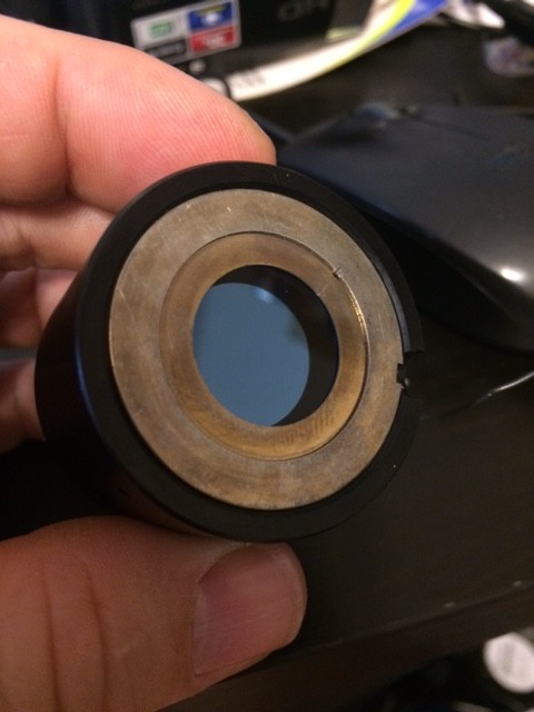

Hi, my first post!!
I took my IIT out of my PS-14 to see if it had any markings on it. It seems that it's been sanded down? Were the markings intentionally rubbed off? And of course I have no clue who made it or if I could verify the gen/gating etc...
It came out of an ATN PS-14 unit. When I emailed them they said they couldn't give me any information for security reasons, stating: "With the internal information we are not allowed to provide those kinda information. I am sorry I assumed you needed the unit serviced."
Anybody having info on this please share, thanks!
12/2/2019 2:39:27 PM EDT
looks like an ekran tube fom russia - some can be quite good for gen2 but i doubt there is a way to find out much more especially when the writing has worn off

Hello new to NV game and bought a PVS-14 that seems to be a no name unit that was bought at a gun show.  Now that I have been bitten I picked up a Armasight PVS-14/6015.   I’m blind in one eye so not sure I needed the second one!!!!
Here’s a picture of the no name tube.  Anybody know what it is?
Here is a picture of the Armasight tube.
Where do we go from here???
