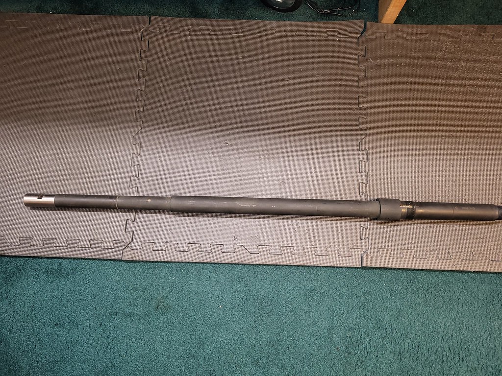

The barrel is like a javelin. Son of a bitch is 45 inches long.
He said he thinks it is a modified browning M2 barrel, and I look up those barrels online and sure enough, it looks like a modded one. Google says the M2 uses a 45 inch barrel.
It has some type of a stainless cone type muzzle device on it. I am hoping I can use my barrel vice and remove that thing, leaving the muzzle threads. It has two flat spots for a wrench. Hopefully they are a thread size I can find a muzzle brake to fit.
The collar goes around the barrel and is held on with 3 set screws. You thread the barrel in and then use the little locking block to hold it in place. Like the video above show.
He thinks that the headspace may be adjustable by way of that collar.

I put the barrel in the barrel vice and tried to remove the muzzle thing. It did not want to budge.
I heated it with a propane torch and gave it another good tug and it broke loose with red locktite falling out of it.
I cleaned it with with a wire brush and measured.
The OD of the threads measured .990 and according to my thread gauge, it is 20 tpi.
So I am guessing this is most likely 1-20 threads, which appears to be a very uncommon thread. No 50bmg brake out there has that thread size.
The two most common I see is 1-14 and 7/8-14.
So I bet it could be turned down just a little and rethreaded to 7/8-14.

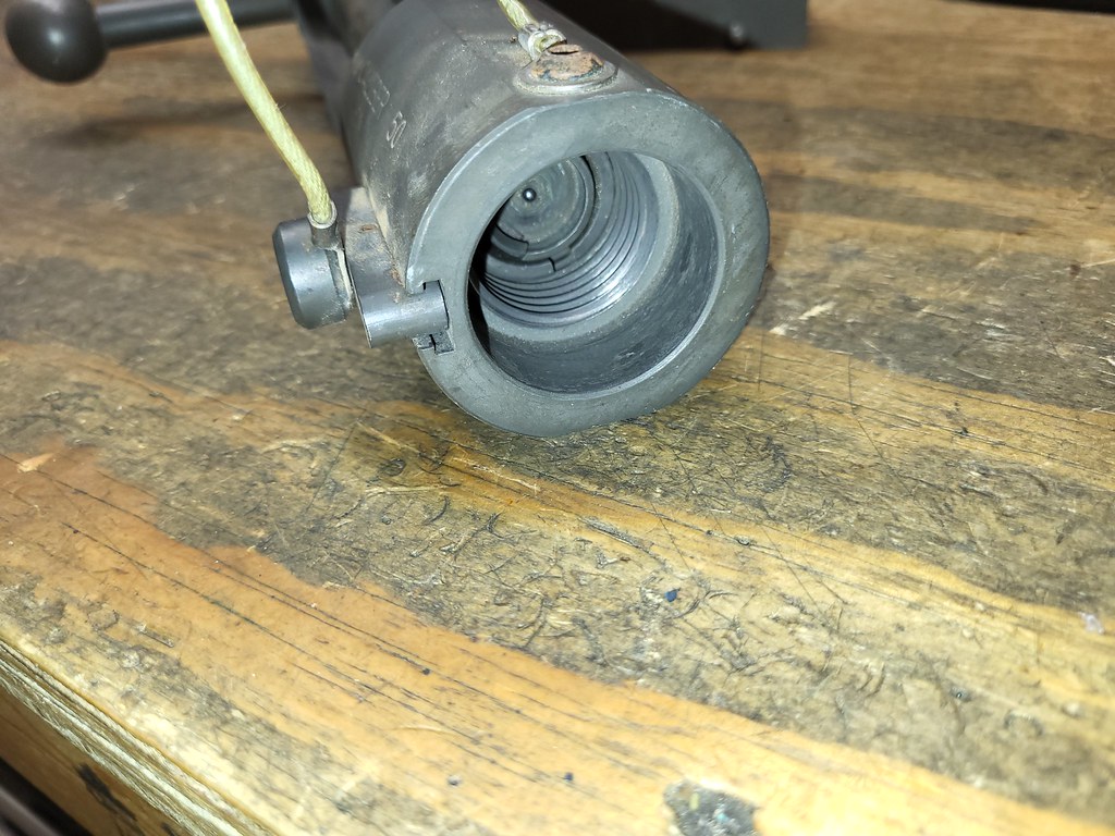

I took the striker out of the bolt (was actually pretty easy) and then installed the barrel and tested the round in the chamber.
The bolt was stiff to close, like the headspace is too tight.
There is a SN on the barrel, but it does not match the receiver.
Now I do not know if the barrel was numbered to the receiver, or if the number on the barrel is just unrelated.
Seeing how the guy said he saved it from the scrap bin, it seems like there is a chance the barrel and receiver are not original to each other.
I happened to notice a set screw in the front of the receiver I overlooked before.
I got looking a little closer and the receiver has a threaded sleeve/collar (whatever you want to call it) in the receiver threads that the barrel tightens against. it has two notches for being able to turn it in/out.
That set screw locks it in place. So it appears the headspace could be set/adjusted by loosening that set screw and turning that collar in/out.
So I will eventually need to rent/borrow a headspace gauge when the time comes.

I have rented a set of headspace gauges from 4D reamer rentals yesterday.
Once they get here I will check and adjust the headspace if needed.

Headspace gauges showed up and it checked good.
Closes on the go gauge and will not close on the no go gauge.
So I feel much better knowing headspace is good.

6/21/2026 9:31:38 AM EDT
Here are my plans for the barrel.
There is the large section that measures just a hair over 2in. There is then some threads, a keyway cut, then it steps down twice till it goes into the receiver.
I want to take the barrel and machine it down to the same diameter it is at the breech end, up to the large section, removing the threads and that keyway cut.
I then have bought a section of seamless 2in od, .188 wall seamless tubing. It will only need to be opened up just a little. The OD of the barrel at the breech end is 1.675, the ID of the tubing is 1.615.  Then use that as a light press fit sleeve over the barrel, to make it the same diameter from the receiver to that large section.
That way it will look more like a normal barrel where there is a shoulder on it that tightens against the receiver.
The two step, I then want to just put a 45* taper on them just to make it not a flat step.
I called a couple local gunsmiths and their lathes are not big enough for this barrel.
I tried a local just regular machine shop, who has a lathe big enough to fit it, but once they saw it was a gun barrel they got spooked and refused to touch it.
They gave me a name of another shop I am going to try and contact monday if I can remember.
Originally I was thinking just have the barrel re threaded from 1-20 to 7/8-14, as the 2 thread sizes for 50bmg brakes I see are 1-14 or 7/8-14. But threading is kinda expensive when you have to pay someone to do it on something this big. I can not easily just mail this thing out to have someone do it.
So I got looking at that muzzle device. It is just a tapered cone of a sorts (you can see it in the above picture).
I found a very reasonably priced 1-20 tap on ebay (less than $20) and bought it.
I tested that muzzle device and I can confirm it is 1-20 threads.
So I chucked it up in my lathe and using a boring bar, bored out the inside of it to be the same ID all the way through.
I then took the tap and just continued the threads all the way through.
My idea is to take a piece of bar stock I have, thread one end to 1-20, then thread it into this muzzle device, leaving some sticking out, then thread that to 1-14 to match the available muzzle brakes. Basically making a thread adapter.
Anything I can do myself to save having to pay other people is a plus.
I have it threaded, I still need to shorten it a little. Then make the thread adapter.
