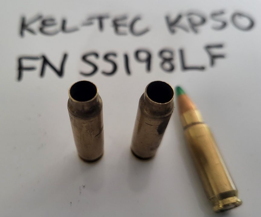

Thanks. if possible to find some of the 198 Brass I'd appreciate some pics of that. Those will have green primer sealer and 3 stake crimp
As soon as I took the pics and saw the box of 198LF sitting there, I knew you would ask based on your concerns of the P50
I'll get a couple rounds shot off and take a pic of the brass this afternoon. How badly was that brass from the P50?
@Buffman_LT1 here you go!

Those look objectively better than the P50. There's still an ejector mark, but the primers don't look like this:
5.7x28mm Brass from P50 T&E by Buffman RANGE, on Flickr
