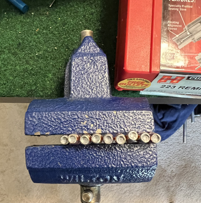

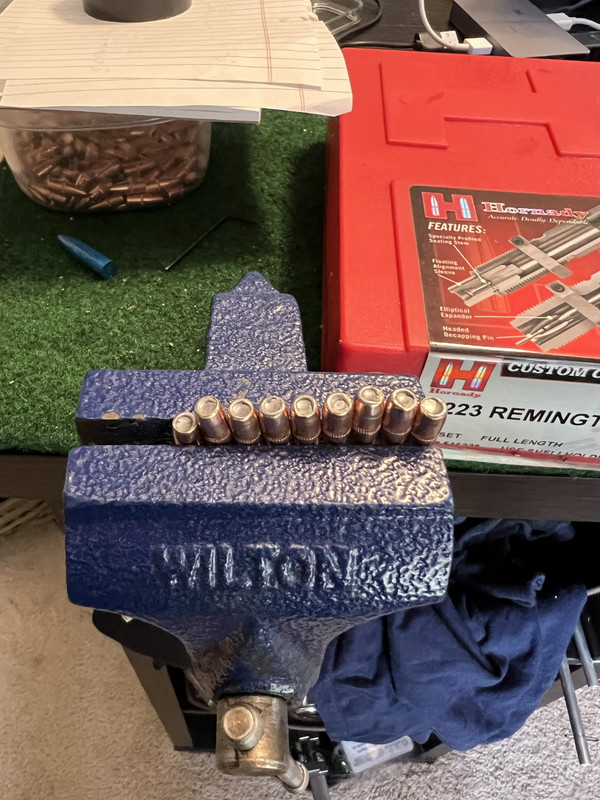

Trip info on Page 2 Update on Page 2 - These things shoot really well. Sub MOA from a 55g FMJ is possible. As many of you know, Palmetto State Armory has started selling projectiles. I ordered 1,000 of the 55g FMJ as I wanted to work up a plinking load with H-335. H-335 seems to be more readily available and I'd like to save my 8208-xbr. Currently, my "go-to" 223 load is a 55g SP Midsouth Shooters Supply Varmint Nightmare - which wouldn't surprise me if it was a Hornady 2266 repackaged, over 25g of 8208-xbr. This generally nets me about 1.25-1.5 MOA at 100 yards depending on if I weigh the charges vs. run them through the LnL AP, mixed cases, etc. I consider myself an "intermediate" reloader. I fully understand how to prep brass, weigh charges, etc. I've never gotten really great SDs out of 223, but I've also never used virgin brass or sorted LC brass by year. I will get single digit SD from my Grendel or my 300 BO when making hunting loads. I'm not a great shot, but decent. Summary: Bases of the PSA AAC 55g FMJ are not square. Accuracy is not good at all. 3-4" groups at 100 yards that look more like patterns. I wish I had only ordered 250 of them. The remaining 965 or so I have left will be taking up space until I'm either desperate or have an extra 1,000 primers and some powder to get rid of. Disclaimer: I have no dog in the fight brand wise. I'm a PSA fan, but also a MSS fan. PSA does a LOT for our community so I WANTED these to work as I believe they deserve our support. MSS seems like a nice, family run business. Generally, these retailers are my "go-to" behind my LGS (I always shop local first on everything.) Initial observation: They come packaged in neat ziplock bags of 250 rounds. I pulled 25 at random out of one bag and weighed them and found the weights to be very consistent. Of the 20, the low was 55.1g, the high was 55.2g. This looked promising, but I looked at one standing upright on the scale platform and thought "That doesn't look like it is pointing straight up." So I lined them up on the ceramic stove top and used an Apple trackpad as a straight edge: Attached File Attached File They looked much worse in real life. For comparison, here is 25 Midsouth Varmint Nightmare: Attached File Attached File So, I worked up a load using: Cases - 1x LC, mixed years Primer - CCI #41 Powder - H-335. Starting load of 23.0g, going up in .5g increments to 25.0g. All charges were hand thrown and trickled up using an RCBS 505 scale. Firearm - Home built AR. Seekins 1:8 223 Wylde barrel, Aero Precision upper, PSA Meme lower, 2A lightweight and adjustable BCG, CMMG two stage trigger. I built this gun for new shooters and with 69g SMK is capable of .75 MOA. I shot them in "kind of a" Round Robin in that I shot five rounds of 23.0g with Varmint Nightmare, then five rounds of 23.0g with AAC, then five rounds of 23.5g Varmint Nightmare, then 5 rounds of 23.5g AAC, etc. For a rest I used one of these on a 6' folding table and chair. So, that was pretty steady. I'll post the chrono data, but I'm not sure why my ES and SD are all so high. However, the target tells the tale. I may have to post images on a followup post. 23.0g Varmint Nightmare: Average2651.6 Extreme Spread134 Standard Dev.54.9 Group size: 1.34 AAC: Average2683.6 Extreme Spread51 Standard Dev.21.9 Group size: 3.66 23.5g Varmint Nightmare: Average2767.2 Extreme Spread120 Standard Dev.50.2 Group size: .98. This was my best group. Attached File AAC: Average2786.5 Extreme Spread36 Standard Dev.15.8 Group size: 3.04 For comparison: Attached File One of the holes is obscured by the caliper, but it doesn't matter. Here they are for comparison: Attached File 24.0g Varmint Nightmare: Average2832.8Extreme Spread99 Standard Dev.40.9 Group size: 1.28 AAC: Average2807.8 Extreme Spread85 Standard Dev.33.7 Group size: 4.81 24.5g Varmint Nightmare: Average2891.6 Extreme Spread91 Standard Dev.39.8 Group size: 1.33 AAC: Average2868.6 Extreme Spread74 Standard Dev.27.1 Group size: 4.13 25.0 Varmint Nightmare: Average2948.6 Extreme Spread91 Standard Dev.35.7 Group size: 2.03 This was the worst group and the closest in size to the AAC, however you can see that while mathematically it's "close", visually it's completely different. Attached File AAC: Average2962.8 Extreme Spread96 Standard Dev.39.6 Group size: 3.34 Attached File I'm happy to upload the remaining photos if you all think that would be helpful, but I think the above kind of tells the tale. All are similar when compared side by side. Again, I WANTED these to work because I like PSA and believe they are good people. But for my use, I'll stick with the Varmint Nightmare. ETA: more images. |

Those PSA bullets remind me of a bunch of Winchester 55 grain FMJBT bullets I bought years ago. Lead sticking out of the bottom of some, flush on some, a depression (lack of lead) in the bottoms of others. Shot like total crap. Never bought anymore Winchester 55 grain FMJ bullets. With bullets like that it really doesn't matter what powder you try, the accuracy issue it the bullet. |
How you live your life is important. Just be sure the memory of how you died doesn't overshadow the tales of how you lived your life.
Jackets on the varmint soft points are drawn from one direction, jackets on the fmj are drawn from the other. The first leads itself to very consistent bases, the second not at all. You may be a little spoiled by the performance of the soft points, and not as aware that fmj is as bad as it is generally. 2-4 moa with xm193 isn't outside the norm. And your loads might be a little low on the velocity to even make a xm193 comparison. I wouldn't knock PSA too hard for QC on those projectiles. |
Originally Posted By xjronx: Jackets on the varmint soft points are drawn from one direction, jackets on the fmj are drawn from the other. The first leads itself to very consistent bases, the second not at all. You may be a little spoiled by the performance of the soft points, and not as aware that fmj is as bad as it is generally. 2-4 moa with xm193 isn't outside the norm. And your loads might be a little low on the velocity to even make a xm193 comparison. I wouldn't knock PSA too hard for QC on those projectiles. I am sure they will get it sorted out. In the meantime, for those folks shooting inside 25 or 50 yards, such as a buddy of mine who has an AR pistol with a red dot, these would be fine. Or if you are trying to hit an 8" or 10" plate at 100 yards. |

UPDATE: At the suggestion of @fritztkatt I went looking for 10 bullets that "by my eyes" would line up evenly. The theory being if they stand straight and uniform, maybe they will shoot better. After going through more than 100, I was able to sort out these. I used a white background to make it easier for me to see. PSA 55g FMJ Attached File Attached File For reference here are the Midsouth Varmint Nightmare under same photo conditions Attached File Attached File You'll notice, that with the high res photos, they are still pretty inconsistent. Zoom out to where they look "actual size" and they looked pretty good. So, next up was to hand weigh 20 charges of H-335 at 23.5g as that was the best charge for both. Then shoot five of one, five of the other, five of the first and five of the second. I didn't bother with the chrony this time. NOTE: On the Varmint Nightmare I completely messed up the first two shots. Just wasn't settled in. I'm counting them as "called" as I swore after the shot broke. Still, there is actually 10 shots on that target. Discounting the two it's a 1.4" group. So, about average for me. I can do a bit better if I take all day, but I was a bit rushed yesterday. On the PSA, there's nine holes as one of them was off the top. I used new cardboard backers just in case. It wasn't that far off, so we're looking at like 4.5". These are both a bit high as I didn't have the can on. Attached File Attached File Be all that as it may, there is still a wild difference between the two. And while 3-4 MOA is "average for bulk ammo", given the PSA FMJs are the same price as the Varmint Nightmare, the only advantage for the PSA would be if they are available and nothing else is. I just don't see getting better than 3-4 MOA out of these and for me, I need a bit better. I'm not going to bag on PSA or give them a bad review. As others have said "that's average". And 3-4 MOA may be considered a "win" for them at this stage. I'm super happy to see other players entering the market and I don't want to do anything to dissuade that. The minute they start selling primers as components, I'll give those a go as well. As mentioned, I WANT them to succeed. Competition is good and we need someone to motivate Vista and other established brands. These just aren't quite there yet for me. |

Originally Posted By Landshark9025: UPDATE: At the suggestion of @fritztkatt I went looking for 10 bullets that "by my eyes" would line up evenly. The theory being if they stand straight and uniform, maybe they will shoot better. After going through more than 100, I was able to sort out these. I used a white background to make it easier for me to see. PSA 55g FMJ https://www.ar15.com/media/mediaFiles/365808/IMG_0139_jpeg-2320433.JPG https://www.ar15.com/media/mediaFiles/365808/IMG_0141_jpeg-2320434.JPG For reference here are the Midsouth Varmint Nightmare under same photo conditions https://www.ar15.com/media/mediaFiles/365808/IMG_0142_jpeg-2320435.JPG https://www.ar15.com/media/mediaFiles/365808/IMG_0143_jpeg-2320436.JPG You'll notice, that with the high res photos, they are still pretty inconsistent. Zoom out to where they look "actual size" and they looked pretty good. So, next up was to hand weigh 20 charges of H-335 at 23.5g as that was the best charge for both. Then shoot five of one, five of the other, five of the first and five of the second. I didn't bother with the chrony this time. NOTE: On the Varmint Nightmare I completely messed up the first two shots. Just wasn't settled in. I'm counting them as "called" as I swore after the shot broke. Still, there is actually 10 shots on that target. Discounting the two it's a 1.4" group. So, about average for me. I can do a bit better if I take all day, but I was a bit rushed yesterday. On the PSA, there's nine holes as one of them was off the top. I used new cardboard backers just in case. It wasn't that far off, so we're looking at like 4.5". These are both a bit high as I didn't have the can on. https://www.ar15.com/media/mediaFiles/365808/IMG_0157_jpeg-2320452.JPG https://www.ar15.com/media/mediaFiles/365808/IMG_0158_jpeg-2320471.JPG Be all that as it may, there is still a wild difference between the two. And while 3-4 MOA is "average for bulk ammo", given the PSA FMJs are the same price as the Varmint Nightmare, the only advantage for the PSA would be if they are available and nothing else is. I just don't see getting better than 3-4 MOA out of these and for me, I need a bit better. I'm not going to bag on PSA or give them a bad review. As others have said "that's average". And 3-4 MOA may be considered a "win" for them at this stage. I'm super happy to see other players entering the market and I don't want to do anything to dissuade that. The minute they start selling primers as components, I'll give those a go as well. As mentioned, I WANT them to succeed. Competition is good and we need someone to motivate Vista and other established brands. These just aren't quite there yet for me. Well, at least you know they’re just not that high quality, even cherry picked. It’s disappointing. I was hoping you’d get down to more like 2moa. I had missed that they cost the same as a JSP. Definitely not worth the money when other options are available. Maybe PSA will get their setup tuned in better and produce a higher quality product in the coming months. |

Great review! 55 FMJ bullets have always been iffy but they were 5-7 cents a piece, and the Varmint Nightmare were 10 cents. The only 55 FMJ bullets that I have ever seen get close to 1 MOA were from Lapua, and that is from a bolt gun that will shoot .25 MOA with match bullets. In this crazy market, the VN bullet is a great value, and I wouldn't even consider anything FMJ for accuracy purposes. |
