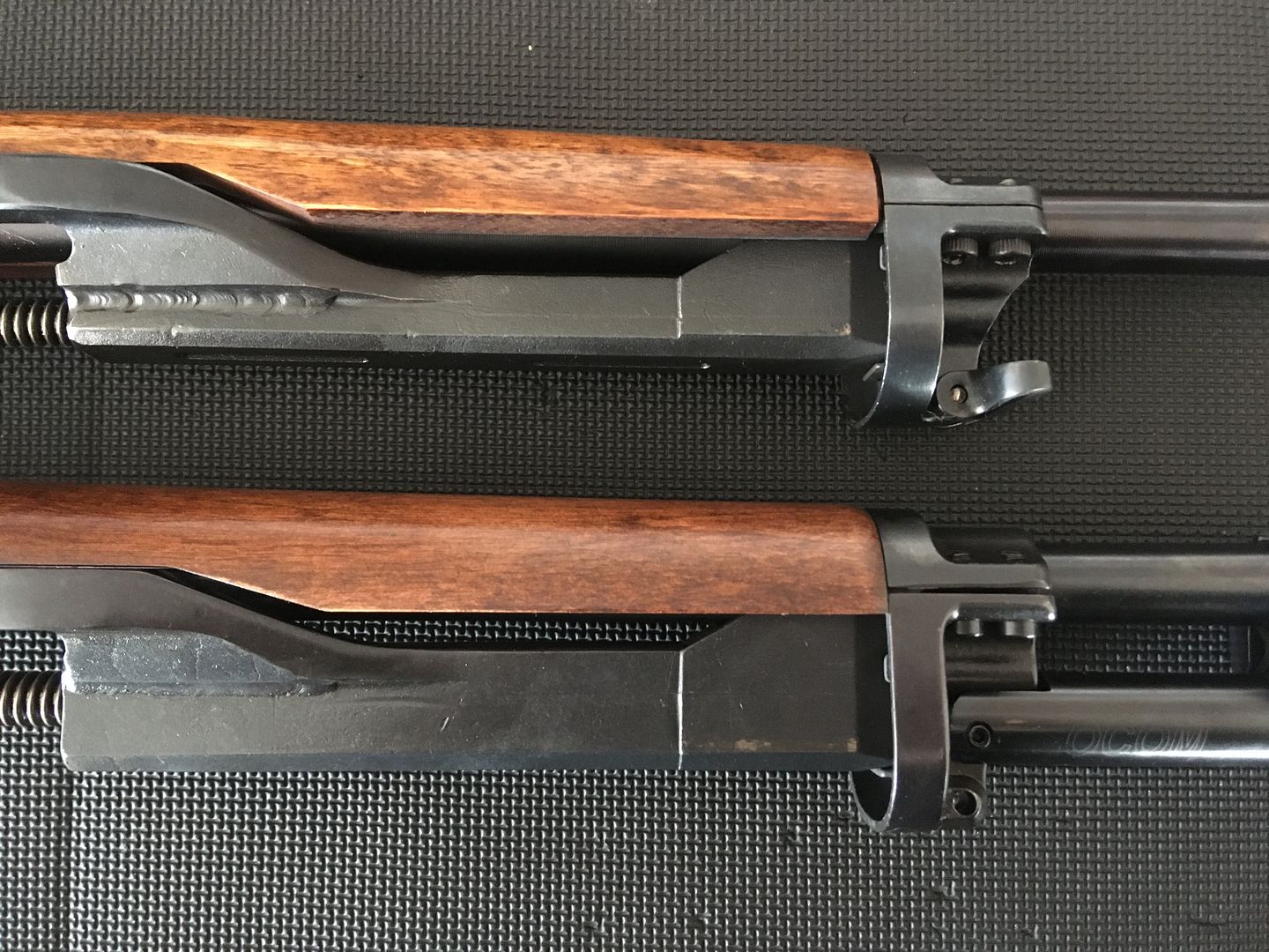

A few thoughts and observations:
Ruger retooled their mini 14 production line with the 580 series and a year or so later in mid 580 production they switched to a heavier tapered barrel.  Those mid 580 series and later 58X series are all solid 2 MOA five shot group rifles out of the box.    They'll do a little better with quality ammo.

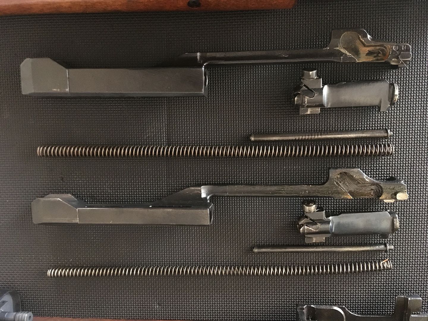

The original 180 series Mini 14 (1974-1977) was much slimmer and lighter with a smaller gas port and a lighter weight slide and bolt than the subsequent 181 and later series.   They have superb handling very similar to the M1 Carbine.
Ruger made the change because after they developed the semi auto Mini 14 they developed the select fire AC 556.  They apparently decided it needed a heavier slide over gassed by a .080" gas port rather than the earlier .052" gas port and lighter slide.  The larger slide also meant a larger gas block and a deeper, heavier stock.
Worse, it meant a lot more energy and vibration as the increased mass of the heavier slide and bolt cycled while being overdriven by all that excess gas.  Accuracy was the major casualty with the light weight pencil barrel.
Consequently, while the 180 was a reliably accurate 2 MOA rifle, the 181 was a 3-4 MOA rifle.
In 1986 Ruger also switched from a 1:10 twist to a 1:7 twist when mil-spec twist rates became all the range among people who just didn't know any better.  Ruger eventually got a clue in 1997 and switched to a 1:9 twist like most of the rest of the .223 makers.
Those 1:7 twist Mini 14s do particularly badly with bulk or surplus 55 gr FMJ ammo with very unimpressive 5 MOA accuracy. Less bad with 62 gr FMJs.
And of course as the tooling wore, accuracy declined so they didn't gain much by the time they switched to 1:9 twist.

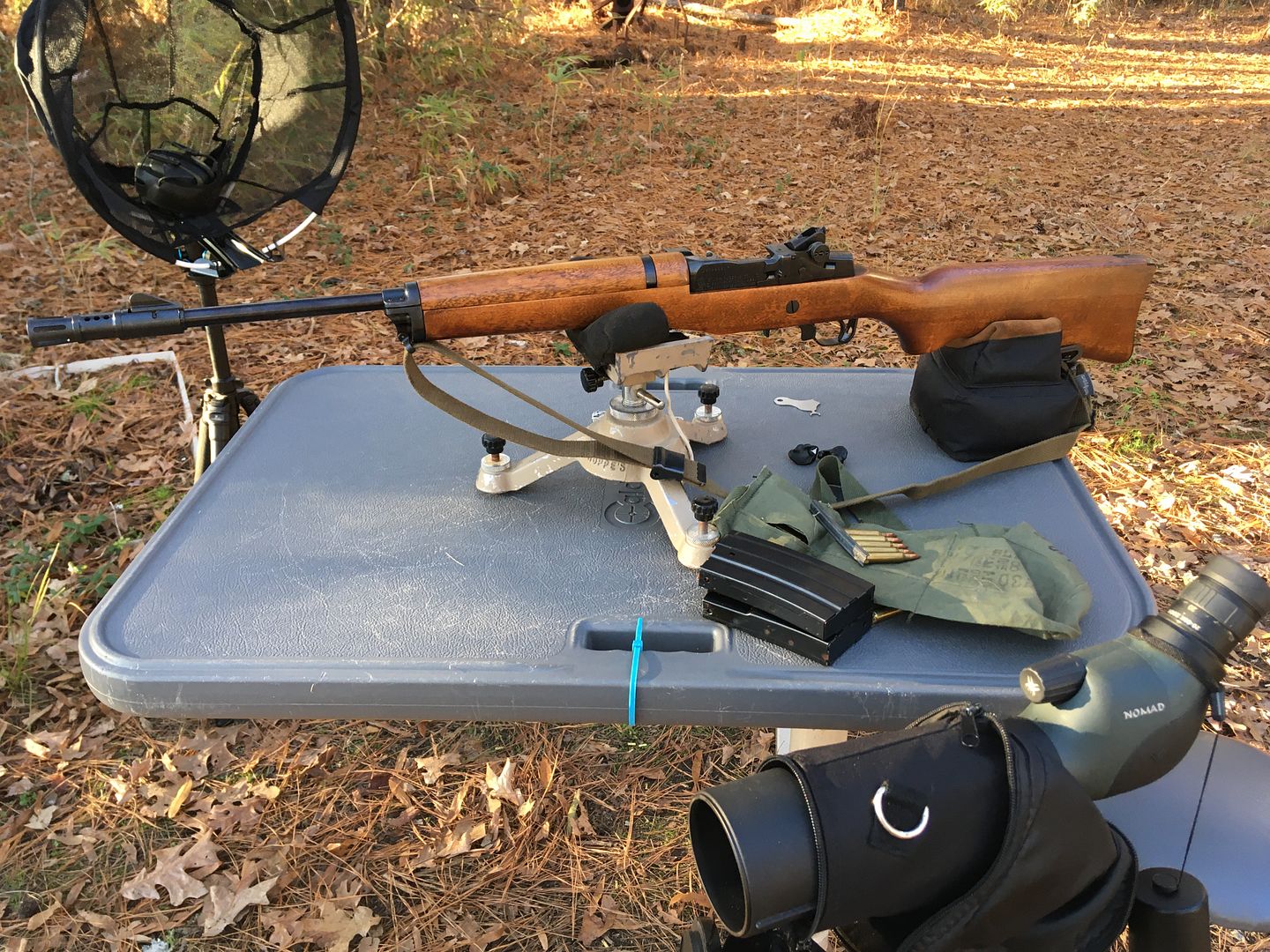

Those earlier 1:10 twist Mini 14s can give very good accuracy (for the type, including the non match AR-15) but they need some work.

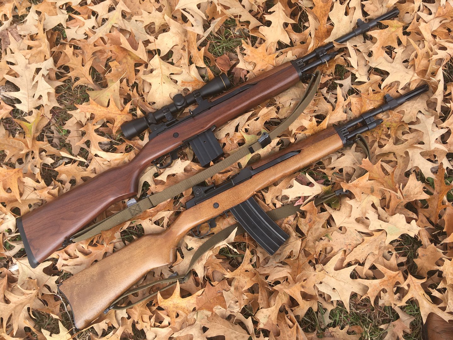

The 184 series Mini 14 at the bottom got a SOCOM length Accu Strut, a Choate flash hider and front sight, an .045" gas port bushing, a shock buffer, and a Tech sights rear sight.  With those changes, it shoots consistent 5 shot 1.5 MOA groups with Hornady 55gr BTFMJs.
The 187 series ranch rifle above it got the same modifications and gives identical accuracy.

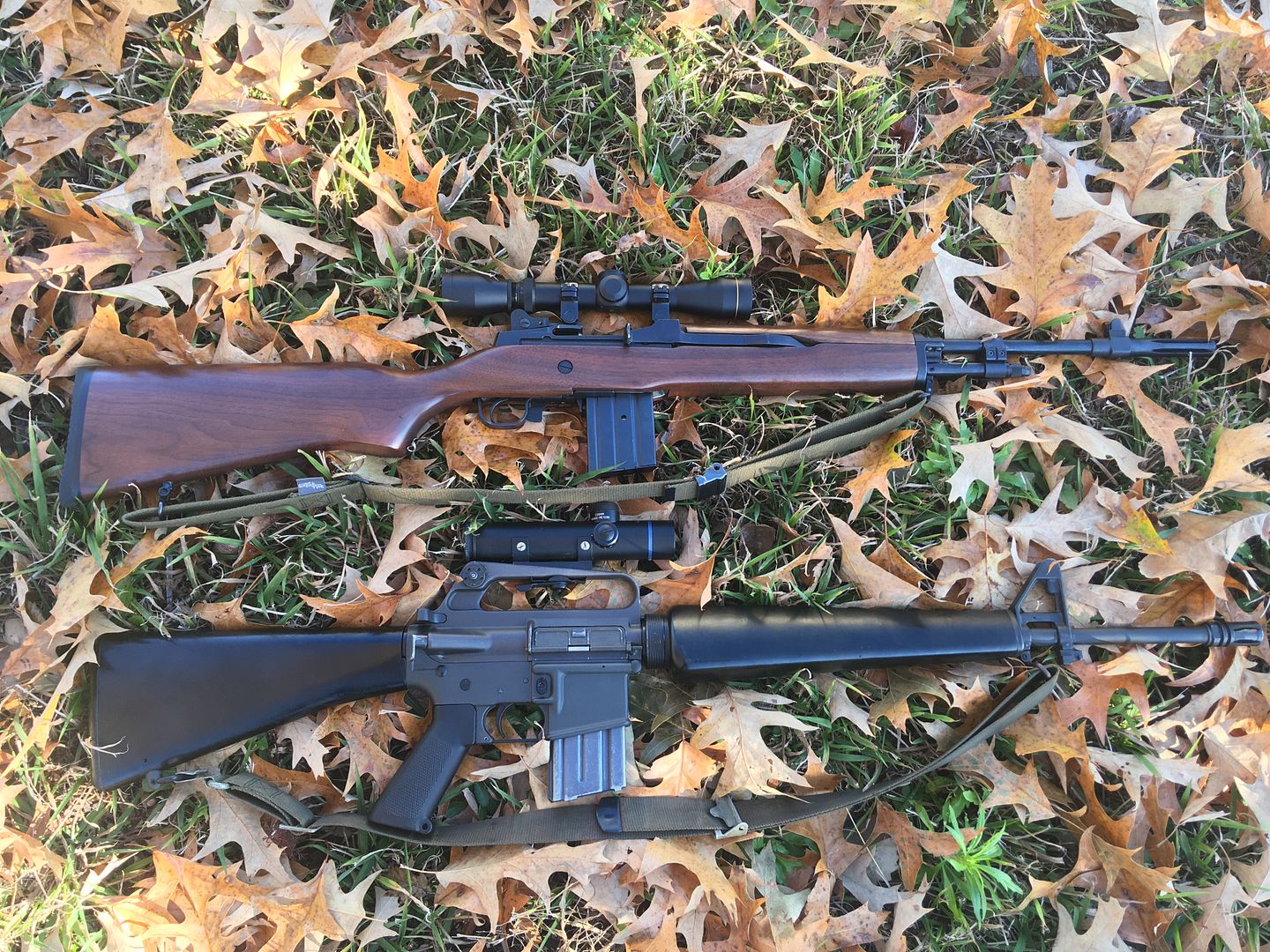

There are a lot of folks who like to bash the Mini-14 in comparison to the AR-15, but there are a lot of variables involved.  There are for example a lot of low budget AR-15s and in particular M4geries out there that wont do better than 4-5 MOA with surplus or bulk 55 gr FMJ ammo.
As an apples to apples comparison, the 187 ranch rifle as described above shoots the same 1.5 MOA 5 shot groups as my Colt SP1 20" AR-15 from the same era, and my Colt made M16A1 upper gives the same accuracy.
In my experience, the Mini14s are much more reliable than the AR-15 when it comes to real world dirt and sand.  I never carried and M16A1 or A2 where I did not pull the rear pin and remove the bolt carrier to wipe it off and wipe out the upper receiver at every possible opportunity.  I don't have that same compulsion / lack of confidence in the Mini 14.

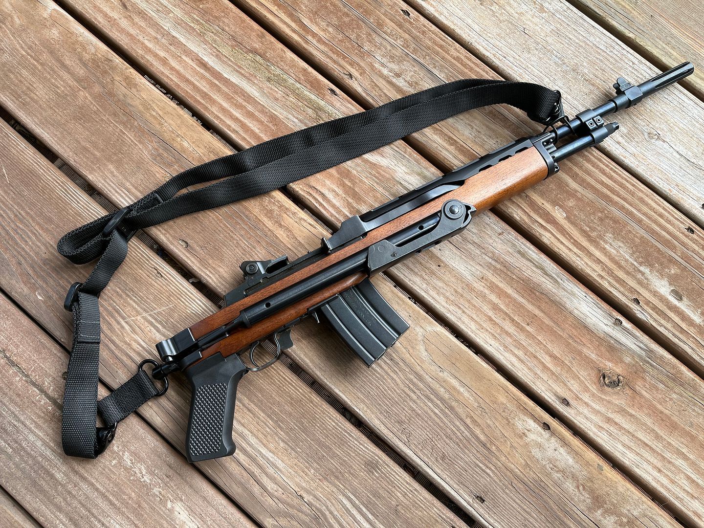

Samson has brought back the old folding stock and it is a nice addition if you want a folding stock.

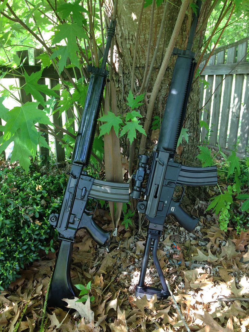

But for the most part it suffers from the same issue that largely killed the AR-180 in its resurrected AR-180B form.  Its an excellent rifle, better than the original, but tis timing was bad as it was competing with cheap AR-15s when it was introduced, and again didn't appeal to the tacticool "gotta hang as much stuff as possible on it" crowd.
