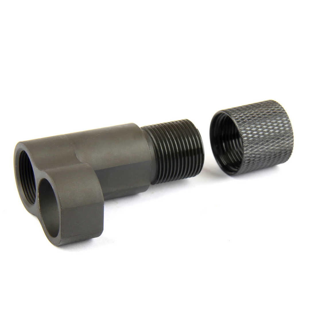

I put this one together from parts; all Winchester to match the receiver, save the stock, handguards, and the Garand Gear ported gas plug.
https://www.ar15.com/media/mediaFiles/7619/A63F35B0-4A83-4165-AEF5-0588B7A7E501-2441907.jpg
As someone with an already bastardized “scout” Garand, I feel obliged to inquire how you did that/how you mounted the suppressor.
Those who cannot remember the past are condemned to repeat it.
7/30/2026 9:56:17 PM EDT
I forgot, the barrel is an aftermarket.308 and the gas cylinder lock adapter is aftermarket too.
The can is a TBAC DOMINUS-K-SR
