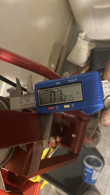

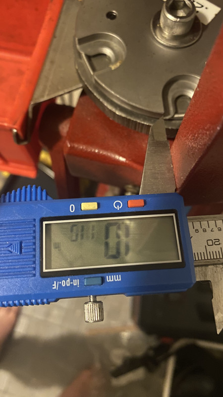

I'm thinking about expanding my options for my bullet tray to other presses.
I'm hoping to get dimensions off my Dad's RCBS Rockchucker press in the next couple of weeks and make something that would work for it.
I'd really like to get dimensions of the LEE single stage press or their progressive press.

Ok, sorry this took so long.  I realized too late that you were looking at the classic cast, and I have the challenger which has much trickier geometry.
I already did up the MS pain and took the pictures so I'll still throw them up here, but if it is more work than you want to deal with I totally understand.
Here is a 100% more MS Paint cross section with dimensions.
Again if you don't want to mess with this complicated design, I totally get it, but I had already gone through making my crude drawings
https://www.ar15.com/media/mediaFiles/408270/Side_1_dimensions_jpg-2072604.JPG
https://www.ar15.com/media/mediaFiles/408270/Side_2_dimensions_jpg-2072605.JPG
https://www.ar15.com/media/mediaFiles/408270/Resized_20210829_162217_jpeg-2072608.JPG
https://www.ar15.com/media/mediaFiles/408270/dimensions_cross_section_jpg-2072607.JPG

Awesome job on the measurements. I wish I could get good measurements on the newer Hornady LNL presses of recent manufacture. I tried going to local gun shops to get measurements, but they don't even have display models anymore. They're selling everything/anything reloading as soon as it's in stock.
After doing some brain storming I'm thinking the rear section may be better on single stage presses. I could come up with something that fits on the outer ribbed portion, but I could make it adjustable to fit several presses. Similar to what this guy did, but I could design it to work with my bullet trays. https://www.thingiverse.com/thing:2749171
On progressive presses the handles are more to the right, but on single stages they come pretty close to the front bar. This complicates things along with variations between brands, etc.
Edit: Now after thinking over your measurements I might could make something work on that press at the front bar location.
