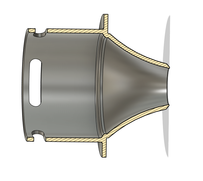

I designed some conically shaped baffles from 17-4 designed to be autogenously welded (fusion weld, no filler, back purged,on a turn table) into a baffle stack at around .040". This is a bolt action 300 blackout subsonic only. I would say .060" thickness would be sufficient for super sonic.
https://tinypic.host/image/image.Dwe4w

7/8/2025 11:49:12 PM EDT
Love the design, but have some questions about how you would weld that up
7/9/2025 1:46:31 PM EDT
[Last Edit: MoNkEyTurbo][Edited] [#8]
https://ibb.co/r2zJWXgj
They will nest together. Then using a rod to hold them tight and provide back purging they would be autogenous GTAW welded on a rotary table using a pulsed process.
