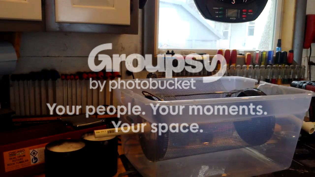

So the tumbler works great
So after doing my first batch I decided I needed something different for a separator since I used a bucket and a colander for dry media
I was looking up all the separators and thought I can make something like that so this is what I came up with, last one is a video (click on it to watch it)
Its the ends off of a wire spool with cpvc pipe for the center and handle, and some wire fence from menards. The fence was $5 and the tub was $5
And I also got the $24.99 dehydrator from Harbor Freight and noticed it just heats up, I have a good dehydrator for making jerky and it has a fan to circulate air
so I added a fan to this one.
The fan is a computer fan with a AC adapter that was laying around that was from something that I don't have anymore

Why did you cut the "L" shape in the plastic tub while making your separator?  You could have just cut straight down.  It would work just as well, and the tub's strength wouldn't have really been impacted.
AV1611
http://i531.photobucket.com/albums/dd352/ryan20021982/CAM00023.jpg
http://i531.photobucket.com/albums/dd352/ryan20021982/CAM00024.jpg
http://i531.photobucket.com/albums/dd352/ryan20021982/th_CAM00016.jpg
http://i531.photobucket.com/albums/dd352/ryan20021982/CAM00018.jpg
http://i531.photobucket.com/albums/dd352/ryan20021982/CAM00019.jpg
http://i531.photobucket.com/albums/dd352/ryan20021982/CAM00022.jpg
And this post is not complete without some bling
http://i531.photobucket.com/albums/dd352/ryan20021982/CAM00026.jpg
4/10/2013 3:56:56 PM EDT
[Last Edit: full_metal_jacket][Edited] [#15]
AV1611
The tub is fine this way, I did this so I could still put the lid on it and spin it without getting water all over, the latches for the lid are in the center so if I would have cut straight down they would have been gone.
