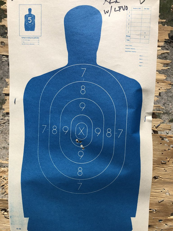

So I started with my XCR-L in 5.56.  Using a 1-6x Vortex Strike Eagle and American Eagle .223 55 grain ammo.  The targets are B-29 (1/3 size of B-27 to simulate longer range at shorter range).  Shot from a bench, but I only had a small bag that I had to rest my hand on top of to hold the handguard while also using the mag as a monopod.
Pretty decent for me.  3 touching for a 7/8" group.  Double it to 1 3/4" for MOA at 100 yards.

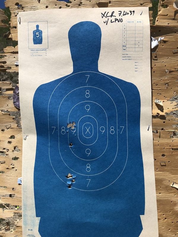

Switched to the 7.62x39 kit, also using American Eagle brass (124 grain):

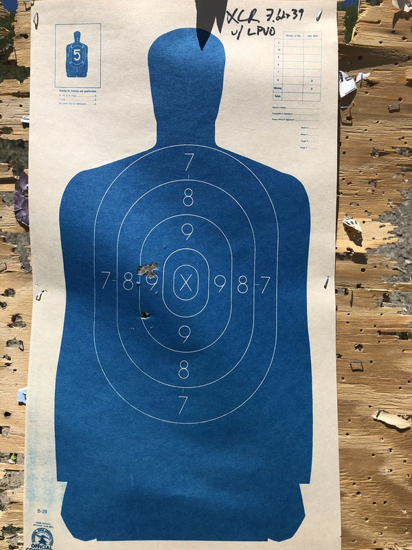

The one that dropped was my first, but I didn't "call it" so I don't know what's up with him.  Too short of range to be a cold-bore shift I'd think.  Without him, that's 1/2" at 50, 1 MOA.  With him it jumps to 4 MOA.  So I reshot, aiming at the low 7, just to verify and got:
Right at 1" spread for 2 MOA.

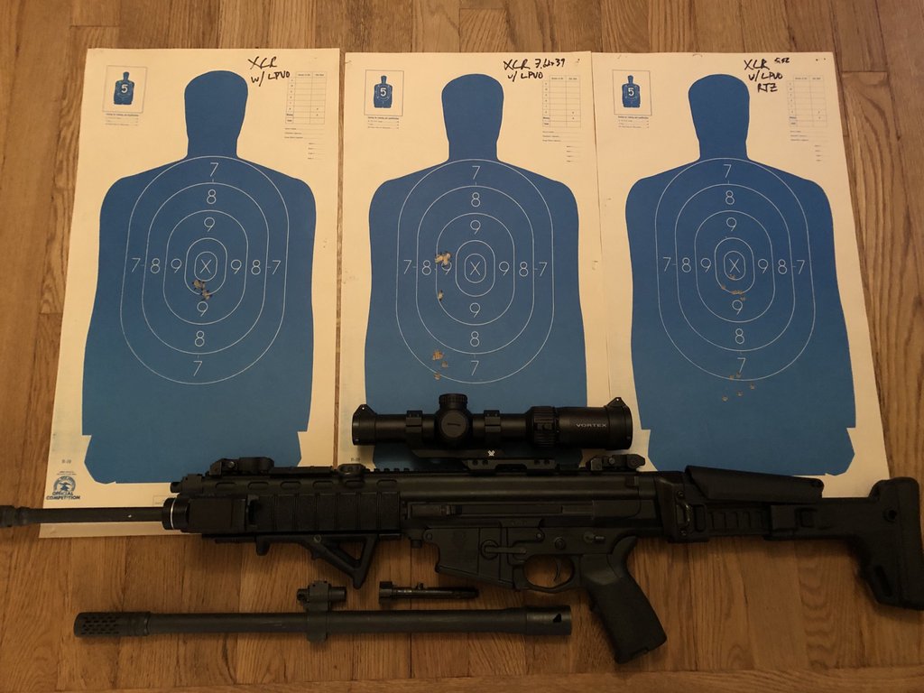

So the 5.56 shot a bit low (to be expected at 50 yards), the 7.62x39 shifted 1.5" up and 1.5" left.  Not too shabby for a barrel and caliber swap.  So now let's see how the return to zero is when I switch back to 5.56:
Opened up a slight bit to 1" (2 MOA), but that's likely more me than anything else. Stupid wonky eye.  But returned right to original zero.  Reshot at the low 7 to verify and got the same results (as you'll see below)
Can't complain one bit, obviously this is a sample size of one and doesn't necessarily apply to other XCR swaps.  But I can make an adjustment cheat sheet for the inside cap.
