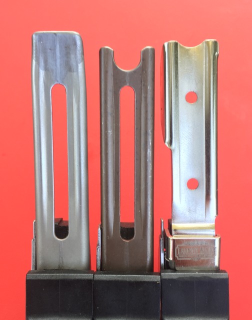

Mine arrived last Thursday. I’ve been out of town and haven’t had time to install it yet.
My M2 has the full TTI race package on it. Just a quick visual comparison. The new lifter is a good 1/2” shorter than the TTI version which has been welded and extended to remove the thumb biting pickle fork tip.

I was surprised to see that it was short... I guess I should say, not longer, and not flat nosed.  Even with that, I'm thinking the nose of my shells are coming up too high. (sort of like is common when you have a factory carrier extended, before you give the nose a little roll)
7/28/2019 6:24:05 PM EDT
[Last Edit: cas][Edited] [#40]
A C-Rums weld up, factory and the J. Kenny & Co.

Interdasting...
Here's the jam... without a shell in it. If I work the bolt slow enough it will hold the bolt open.
That trigger group in another gun, I can feel some resistance, but it won't hang up. I'm hoping it's just a stacking tolerances issue.
One thing for sure though, the carrier comes up a good deal higher than the factory one.

Originally Posted By cas:
Interdasting...
http://photos.imageevent.com/cas6969/shmisc/websize/E6C765F5-3CFC-41AA-B930-449F6731B975.jpeg
Does the Kenney lifter come up that high when it has a shell on it?
If you work the bolt slowly on an empty M2 in factory configuration the bolt will often hang up too. It is caused by the lifter dog wedging into the cut in the bottom of the bolt. It only happens when the gun is empty and the bolt cycled slowly.
Neither situation (empty or slowly) comes into play when the gun is fired and cycling.

Did what the video said. Over shot the bending and the bolt wouldn't lock. Worked it back until the bolt locked and the gun is oh so close to 100% auto loading. Talked to Kenney, they said shoot it a bunch and it should seat in and be 100%...so I am.
8/10/2019 6:08:10 PM EDT

FWIW.... my half way hang up issue went away after swapping some parts with another gun.  In hand cycling dummy rounds I was still getting a nose dive malfunction. (I don't know which I was getting during the match, no time to check obviously)  Usually that's a sign of a tired carrier spring, but it's pretty new. I changed it anyway. No nose dives hand cycling, so fingers crossed.  Hopefully later in the week I'll get to the rang to test it. I just hate dumping rounds for no reason, trying to make it jam.
